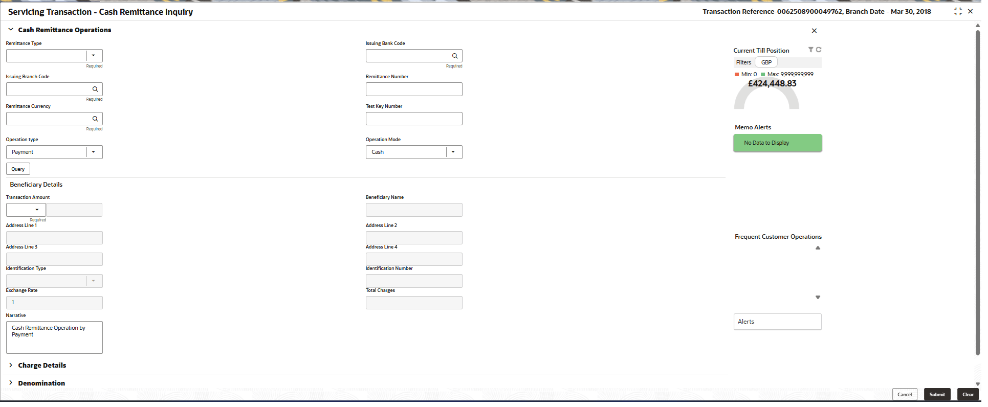

Figure 8-49 Cash Remittance Operations (Payment by Cash)
- On the Cash Remittance Operations screen, specify the
fields. For more information on fields, refer to the field description
table.
The fields marked as Required are mandatory.Table 8-47 Cash Remittance Operations (Payment by Cash) - Field Description
