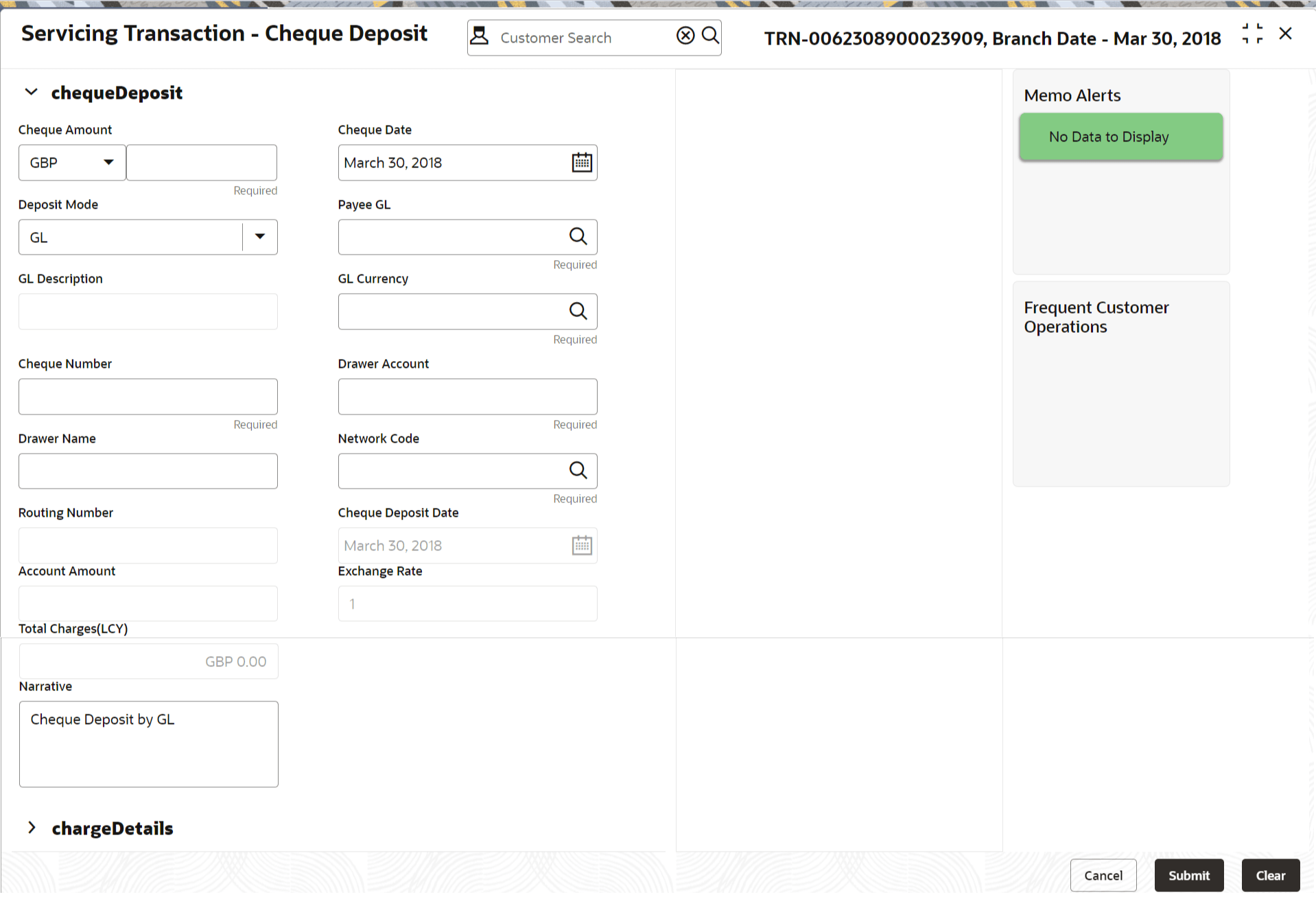

The Teller can use the Cheque Deposit screen to carry out the cheque deposit transaction for credit of a GL account.
To capture the cheque deposit request:
- On the Homepage, from Teller mega menu, under
Clearing, click Cheque Deposit
or specify Cheque Deposit in the search icon bar and
select the screen.The Cheque Deposit screen is displayed.
- On the Cheque Deposit screen, specify the fields. For more information on fields, refer to the field description
table.
The fields marked as Required are mandatory.Table 7-2 Cheque Deposit (GL Mode) - Field Description
Field Description Cheque Amount
Specify the currency and amount mentioned in the cheque that needs to be deposited in the account.
Cheque Date
Specify the cheque issued date.
Deposit Mode
Select the deposit mode as GL from the drop-down values.
Payee GL
Specify the customer GL number in which the cheque needs to be deposited.
GL Description
Displays the description of the specified Payee GL.
GL Currency
Select the GL currency from the list of values.
Cheque Number
Specify the MICR number displayed on the cheque.
Drawer Account
Specify the account number on which the cheque is drawn.
Drawer Name
Specify the name of the drawer account.
Network Code
Specify the network code.Note:
You can also select from the list of maintained clearing codes.Routing Number
Specify the routing number for cheque clearance. The list of values will call the Oracle Banking Payments service to fetch the list of routing numbers based on the Network Code selected.
Cheque Deposit Date
Displays the current posting date as the cheque deposit date.
Account Amount
Displays the account amount.
Exchange Rate
Displays the exchange rate used to convert the cheque currency into transaction currency, and it can be modified.Note:
If the transfer currency is the same as the account currency, the system displays the exchange rate as 1. This field is displayed only ifMulti-Currency Configurationat the Function Code Indicator level is set as Y.Negotiated Exchange Rate
Specify the negotiated exchange rate that should be used for foreign currency transactions between the treasury and the branch. You need to specify the negotiated exchange rate only when the currencies involved in the transaction are different.Note:
This field is applicable only if the transaction involves cross currency and only if cross currency enabled andNegotiated_Rate_Enabled Configurationat Function Code Indicator level is set as Y.Negotiated Reference Number
Specify the unique reference number that should be used for negotiation of cost rate, in foreign currency transaction. If you have specified the negotiated cost rate, then you need to specify the negotiated reference number also.Note:
Accounting system books the online revaluation entries based on the difference in exchange rate between the negotiated exchange rate and transaction rate.Total Charges (LCY)
Displays the total charge amount, which is computed by the system.Note:
This field is displayed only ifTotal Charges Configurationat the Function Code Indicator level is set as Y.Narrative
Displays the default narrative as Cheque Deposit, and it can be modified.
- Specify the charge details. For information on the fields in the Charge Details segment, refer to Charge Details.
- Click Submit.
A teller sequence number is generated, and the Transaction Completed Successfully information message is displayed.
The transaction is moved to authorization in case of any warning raised when the transaction saves.When you submit, the transaction details are handed off to the Oracle Banking Payments system for Outward Clearing transaction processing with external system status as Pending.
After the transaction is processed and responded from the Oracle Banking Payments with appropriate status, the Teller selects the transaction from Journal Log and completes the transaction.
