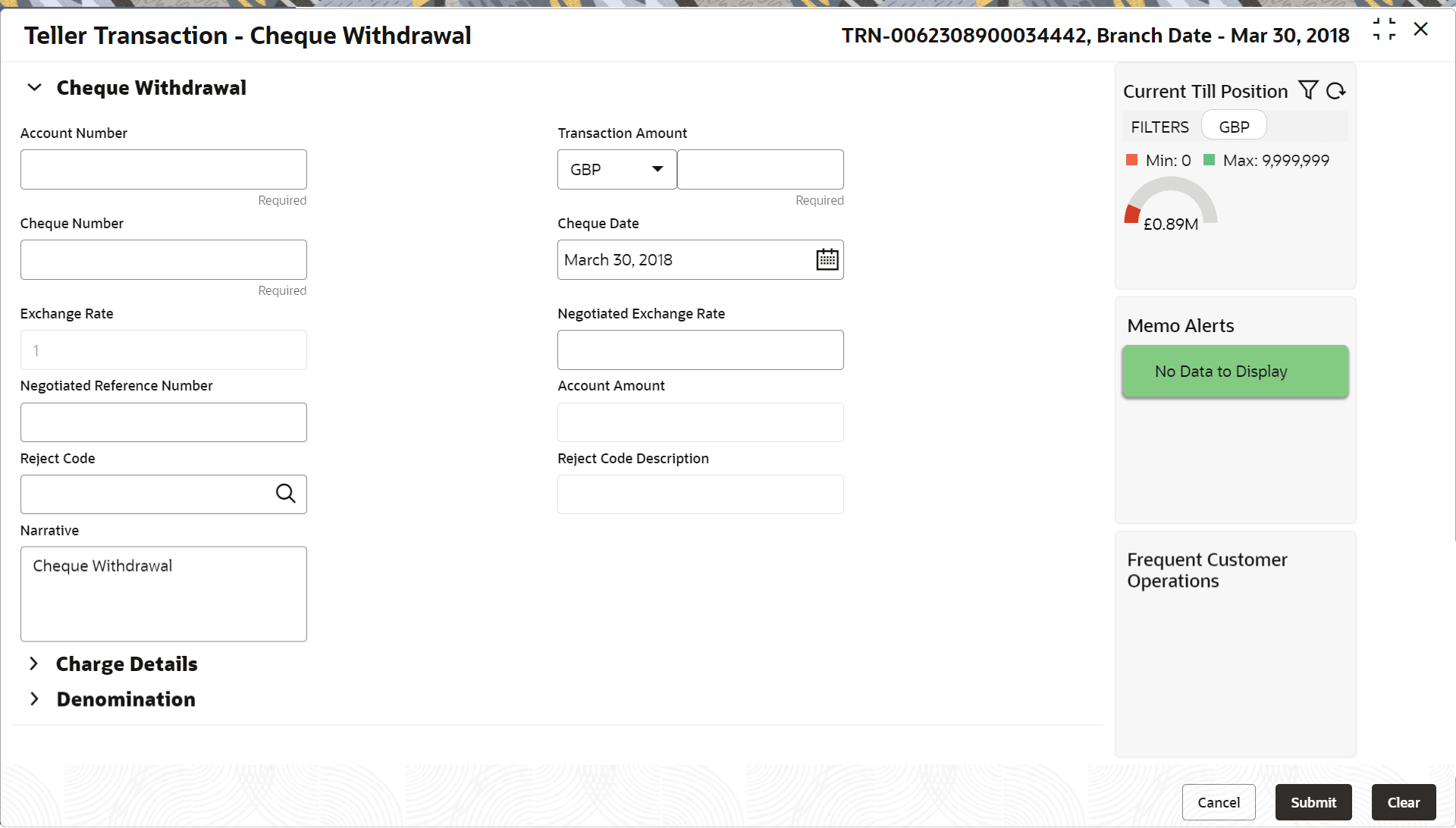

The Cheque Withdrawal screen is used to withdraw cash from the CASA account of the customer against the in-house cheque.

To withdraw cash through the in-house cheque:
- On the Homepage, from Teller mega menu, under
Customer Transaction, click Cheque
Withdrawal or specify Cheque Withdrawal
in the search icon bar and select the screen.The Cheque Withdrawal screen is displayed.
- On the Cheque Withdrawal screen, specify the fields. For more information on fields, refer to the field description
table.
The fields marked as Required are mandatory.Table 4-4 Cheque Withdrawal - Field Description
Field Description Account Number

- Specify the charge details. For information on the fields in the Charge Details segment, refer to Charge Details.
- Specify the denomination details. For information on the fields in the Denomination Details segment, refer to Add Denomination Details.
- Click Submit.A teller sequence number is generated, and the Transaction Completed Successfully information message is displayed.
The transaction is moved to authorization in case of any approval warning raised when the transaction saves. On transaction completion, the cash is withdrawn successfully against the customer cheque. For more information on transaction submission and validations, refer to Step 5 in Cash Deposit.
