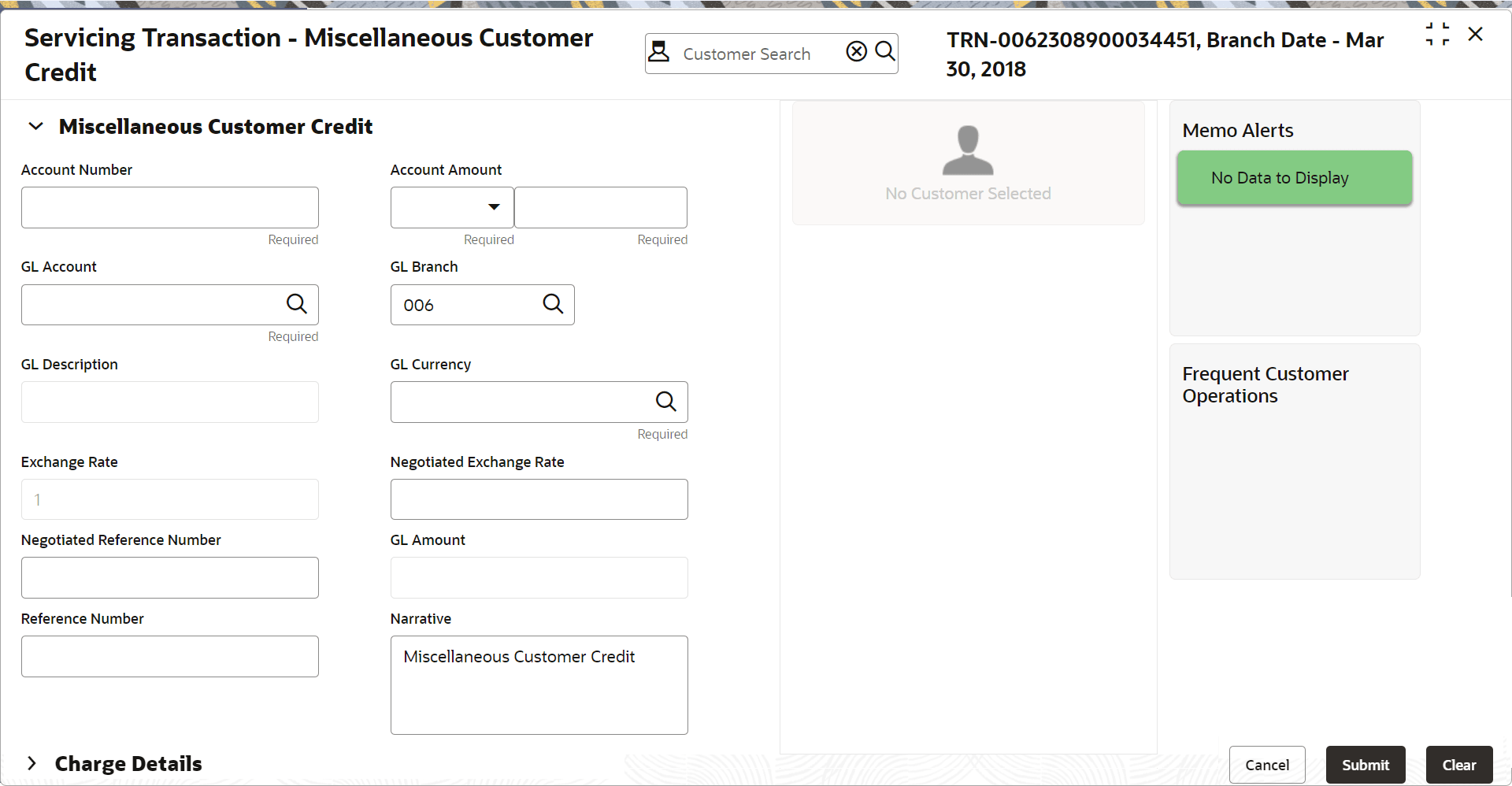

The Miscellaneous Customer Credit screen is used to transfer funds from GL to the customer account.
The customer account can be credited for various reasons, with the corresponding debit to a GL belonging to the transaction branch.
To perform the miscellaneous customer credit:
- On the Homepage, from Teller mega menu, under
Miscellaneous, click Misc Customer
Credit or specify Misc Customer Credit in
the search icon bar and select the screen.The Miscellaneous Customer Credit screen is displayed.
- On the Miscellaneous Customer Credit screen, specify the
fields. For more information on fields, refer to the field description
table.
The fields marked as Required are mandatory.Table 5-2 Miscellaneous Customer Credit - Field Description

- Specify the charge details. For information on the fields in the Charge Details segment, refer to Charge Details.
- Click Submit.A teller sequence number is generated, and the Transaction Completed Successfully information message is displayed.
The transaction is moved to authorization in case of any approval warning raised when the transaction saves. On transaction completion, the GL account is debited, and the customer account is credited to the extent of the Account Amount.
