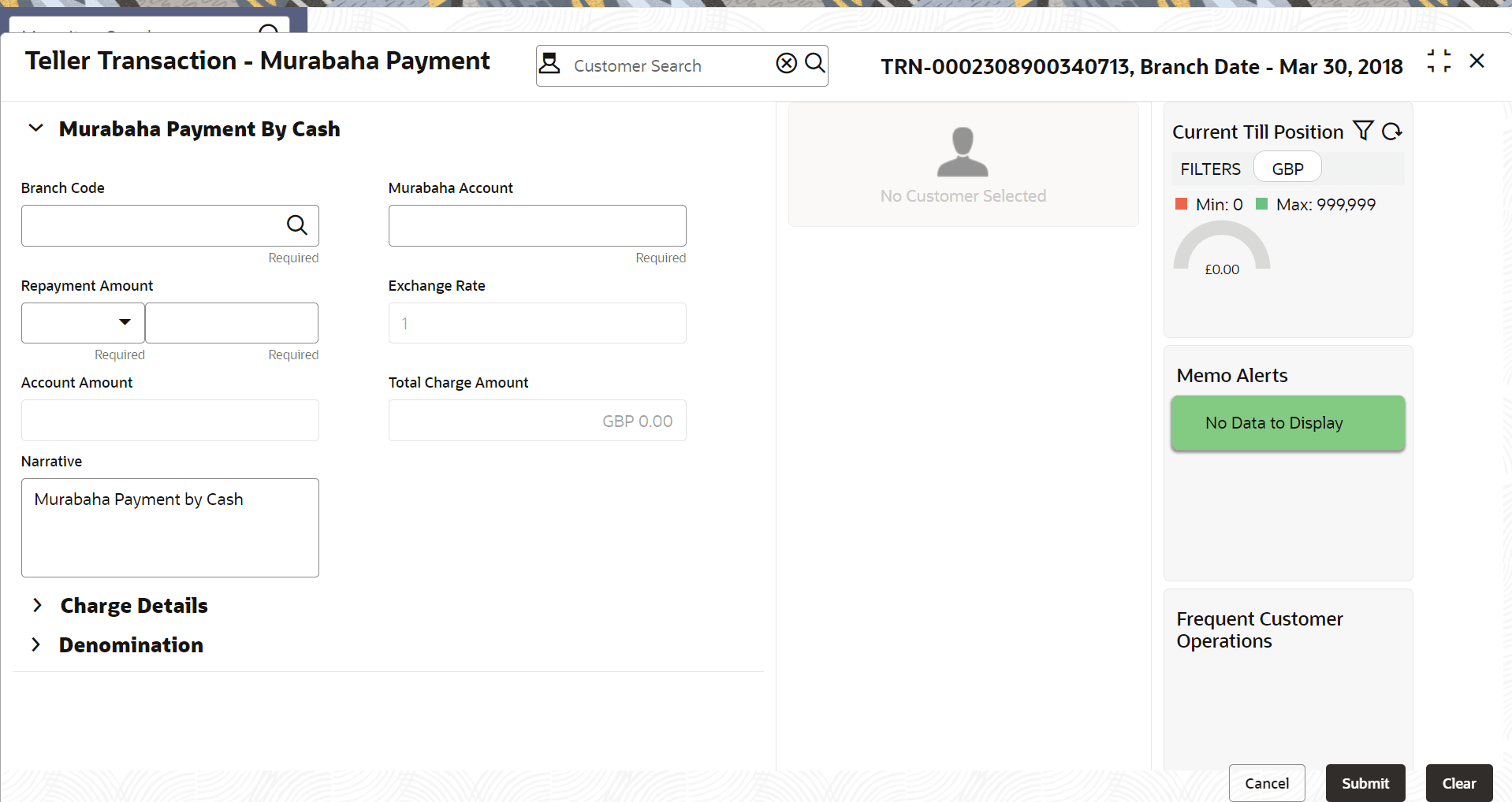

The Teller can use the Murabaha Payment by Cash screen to accept cash to repay the Murabaha loan amount.
- On the Homepage, from Teller mega menu, under
Islamic Transactions, click Murabaha
Payment by Cash or specify Murabaha Payment by
Cash in the search icon bar and select the screen.The Murabaha Payment by Cash screen is displayed.
- On the Murabaha Payment by Cash screen, specify the
fields. For more information on fields, refer to the field description
table.
The fields marked as Required are mandatory.Table 12-1 Murabaha Payment by Cash - Field Description
Field Description Murabaha Account
Specify the Murabaha account number. When you press the Tab key, the customer details and Murabaha account details will be displayed in the Customer Information widget.
Repayment Amount
Select the repayment currency and specify the repayment amount.Note:
By default, the repayment currency is displayed as financing account currency. If theMulti-Currency Configurationat the Function Code indicator level is set as Y, it can be modified, and if it is N, then the default value cannot be modified.Exchange Rate
Displays the exchange rate.Note:
If the transaction currency is the same as the account currency, the system displays the exchange rate as 1. This field is displayed only ifMulti-Currency Configurationat the Function Code indicator level is set as Y.Total Charge Amount
Displays the total charges in the branch local currency.Note:
This field is displayed only ifMulti-Currency Configurationat the Function Code indicator level is set as Y.Account Amount
Displays the repayment amount in loan account currency. This amount will be derived based on the Repayment Amount and Exchange Rate.Note:
This field is displayed only ifMulti-Currency Configurationat the Function Code indicator level is set as Y.Narrative
Displays the narrative as Murabaha Payment By Cash, and it can be modified.
- Specify the charge details. For information on the fields in the Charge Details segment, refer to Charge Details.
- Specify the denomination details. For information on the fields in the Denomination segment, refer to Add Denomination Details.
- Click Submit.
A teller sequence number is generated, and the Transaction Completed Successfully information message is displayed.
