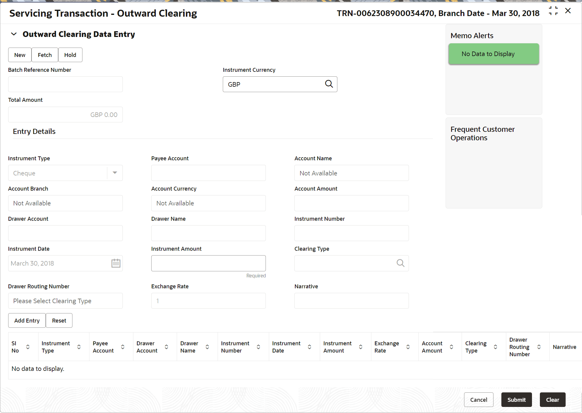

The Teller can use the Outward Clearing Data Entry screen to initiate the bulk deposit of instruments.
This screen supports to capture of bulk input of outward clearing transactions for multiple instrument types – Cheque, Bankers Cheque, and Demand Draft. It also supports bulk data entry of outward clearing transactions for single and multiple customer accounts.

Charges are not supported for this screen. - On the Outward Clearing Data Entry screen, specify the
fields. For more information on fields, refer to the field description
table.
The fields marked as Required are mandatory.Table 7-5 Outward Clearing Data Entry - Field Description
Field Description New
Click New to create a new clearing transaction and generate the batch reference number.
Fetch
Click Fetch to enable the field Batch Reference Number and input or select from the list of values. The list of values fetches only the batches that are saved and not submitted.
Hold
Click Hold to save the data entry made as part of the specified batch number.
Displays the unique batch number, which is system generated.
Instrument Currency
Displays the current logged branch currency.Note:
You can also select the instrument currency from the drop-down values.Total Amount
Displays the total batch amount in instrument currency.
Entry Details
Specify the fields.
Payee Account
Specify the payee account number.
Account Name
Displays the name of the payee account number specified.
Account Currency
Displays the currency of the payee account number specified.
Account Branch
Displays the branch code of the payee account number specified.
Instrument Type
Select the instrument type from the drop-down values.
Drawer Account
Specify the drawer account number.
Drawer Name
Specify the name of the drawer account.
Instrument No
Specify the instrument number.
Instrument Date
Specify the date of the instrument.
Instrument Amount
Specify the amount of the instrument.
Clearing Type
Select the clearing type for the deposited instrument.
Drawer Routing No
Specify the routing number of the cheque.Note:
You can also select from the list of values.Narrative
Displays the default narrative as Outward Clearing Data Entry, and it can be modified.
Add Entry
Click Add Entry to add multiple records in the table, and it allows modifying or deleting if required.
Reset
Click Reset to clear the inputted entry details before you add the entries.
