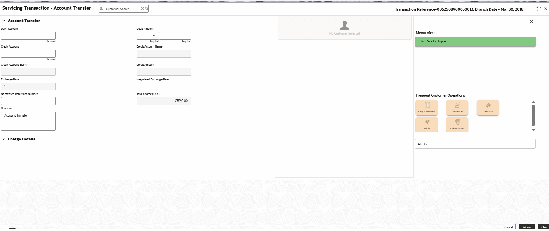

6.1 Account Transfer
The Account Transfer screen is used to transfer funds from one account to another account within the bank.
The funding account and beneficiary account can be in different currencies and belong to different branches.
To perform account transfer:
  1. On the Homepage, from Teller mega menu, under Transfers, click Account Transfer or specify Account Transfer in the search icon bar and select the screen.
    The Account Transfer screen is displayed.
  2. On the Account Transfer screen, specify the fields. For more information on fields, refer to the field description table.
    The fields marked as Required are mandatory.

  3. Specify the charge details. For information on the fields in the Charge Details segment, refer to Charge Details.
  4. Click Submit.
    A teller sequence number is generated, and the Transaction Completed Successfully information message is displayed.
    The transaction is moved to authorization in case of any warning raised when the transaction saves.
    When you submit, the transaction details are handed off to the UBS for accounting.
