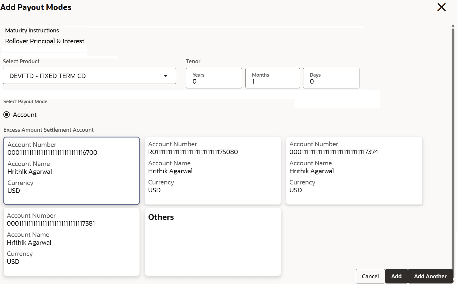

  3. In the Settlement details section, click Add Payout.
    The Add Payout Modes section is displayed.
    Figure 5-11 Add Payout Modes - Rollover Principal
  4. In the Add Payout Modes section, specify the fields.
    Table 5-7 Add Payout Modes - Rollover Principal and Interest – Field Description
    Field Description
    Maturity Instructions Displays the maturity instruction set for the account.
    Select Product Select the product to define the rollover product at the account level.
    During rollover, the product defined at the account level will take precedence. The product drop-down fetches all active deposit business products with their product code, product name, and APY details.
    Tenor Specify the tenor for payout in Years, Months, or Days.
    Select Payout Mode
    By default, the payout mode is selected as Account.
    For more information, refer Payout Modification - Payout Modes.
