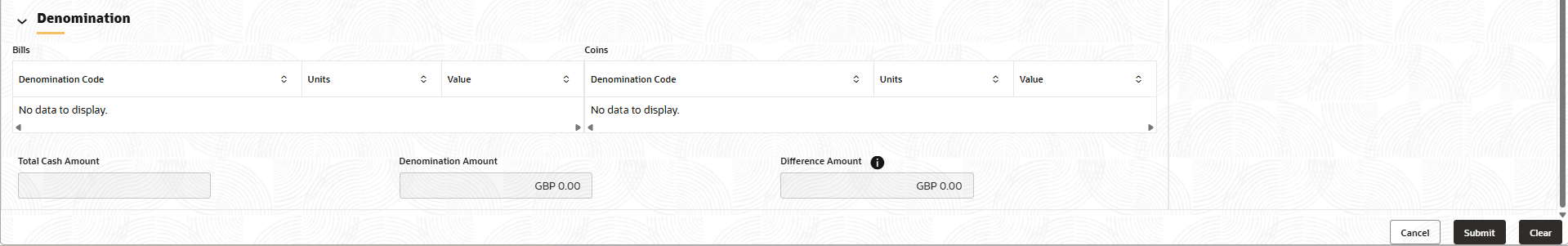

2.12.1 Add Denomination Details
The Denomination segment is used to view the denominations maintained for the transaction currency and enter the denomination units.
Make sure that the main transaction details are added to the transaction screen.
The denomination details for the withdrawal transactions (when cash is disbursed to the customer) will be populated automatically based on the cash availability in the Teller’s Till.
By default, the denomination details will be auto populated. If the DEF_DEN_FR_WTDWL value is set to N in the SRV_TM_BC_PARAM_DTLS table, the auto population of denomination details will be disabled.
Figure 2-13 Denomination Details
Validate the denomination details. For more information on fields, refer to the field description table.
