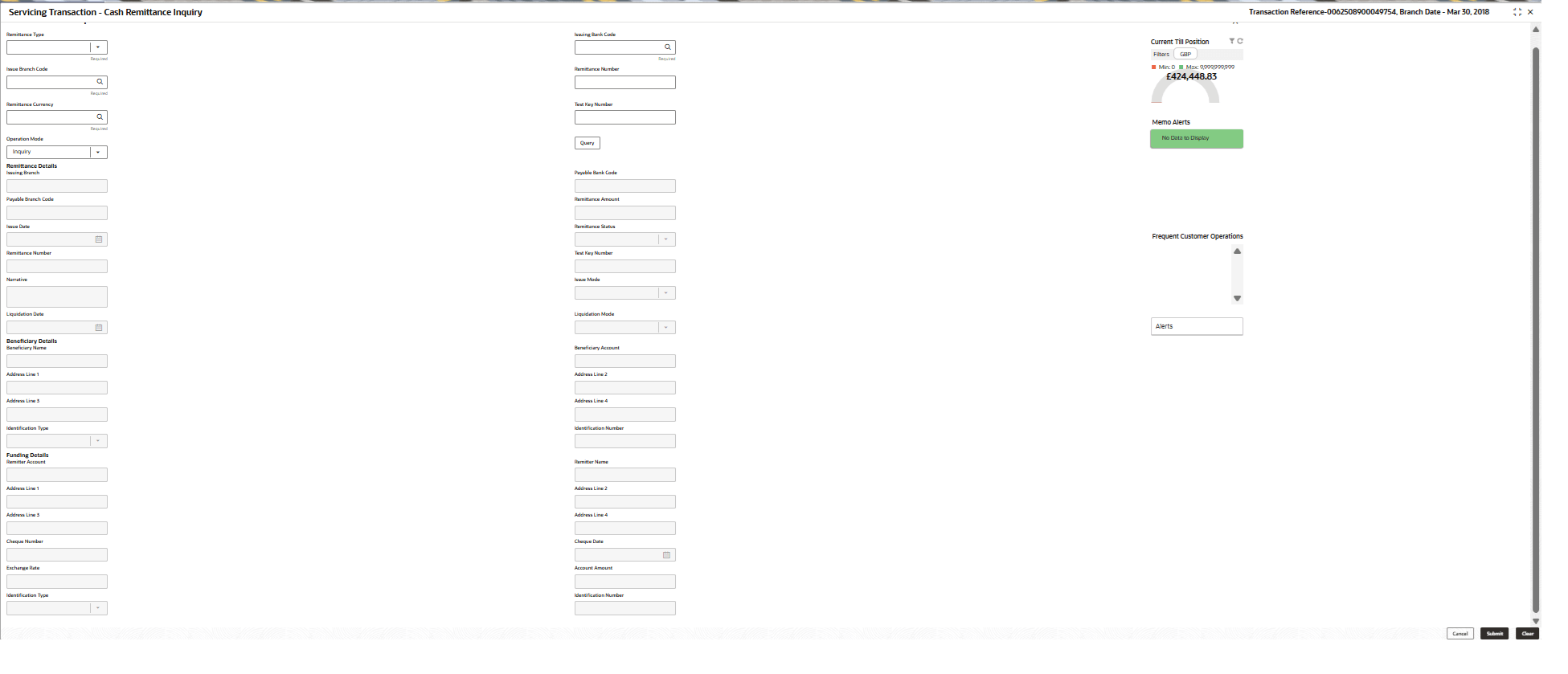

The Teller can use the Cash Remittance Operations screen to inquire about the details of the issued cash remittance.
When you select the operation mode as Inquiry, the fields related to cash remittance inquiry will be displayed.
To inquire about the details of cash remittance:
  1. On the Homepage, from Teller mega menu, under Remittances, click Cash Remittance Operations or specify Cash Remittance Operations in the search icon bar and select the screen.
    The Cash Remittance Operations screen is displayed.
    Figure 8-48 Cash Remittance Inquiry
  2. On the Cash Remittance Operations screen, specify the fields. For more information on fields, refer to the field description table.
    The fields marked as Required are mandatory.

    Query
    Click this icon to fetch the cash remittance details.
    When you click this icon, after you specify the Issue Branch Code and Cash Remittance No, the system will make a service call to the Oracle Banking Payments and fetch the cash remittance details.
