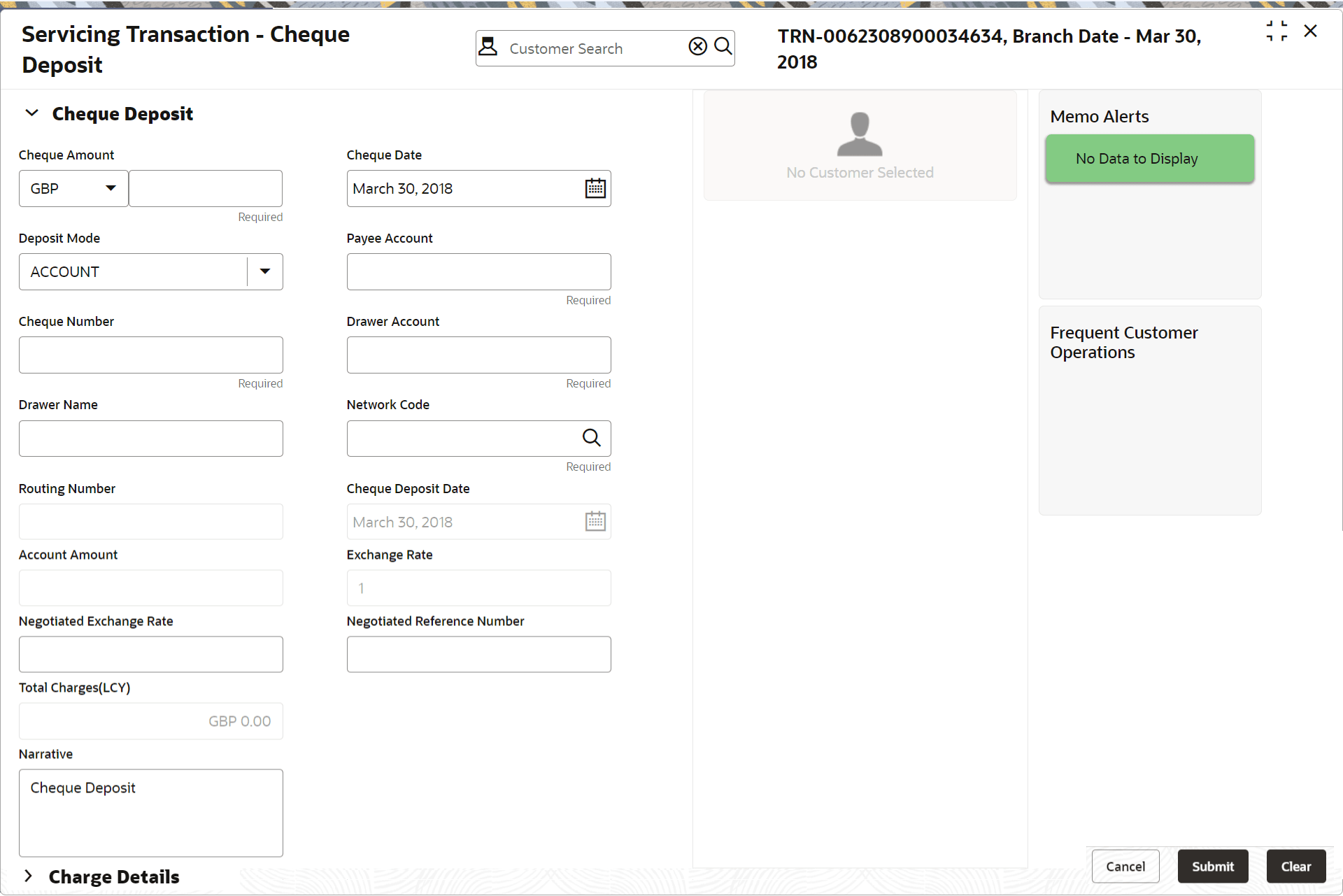

The Teller can use the Cheque Deposit screen to carry out the cheque deposit transaction for a customer.
To capture the cheque deposit request:
  1. On the Homepage, from Teller mega menu, under Clearing, click Cheque Deposit or specify Cheque Deposit in the search icon bar and select the screen.
    The Cheque Deposit screen is displayed.
  2. On the Cheque Deposit screen, specify the fields. For more information on fields, refer to the field description table.
    The fields marked as Required are mandatory.
    Table 7-1 Cheque Deposit (Account Mode) - Field Description
    Field Description
    Cheque Amount
    Specify the currency and amount mentioned in the cheque that needs to be deposited in the account.
    Cheque Date
    Specify the cheque issued date.
    Deposit Mode
    Select the deposit mode as Account from the drop-down values.
    Payee Account
    Specify the customer account number in which the cheque needs to be deposited. When you press the Tab key, the following details are displayed:
    • Customer ID
    • Image
    • Signature
    • KYC Status
    • Account Balance
    • Address
    If the specified account number is a joint account holder, the joint holder details of the account can be viewed in the Customer Information Widget along with the mode of operation.
    Cheque Number
    Specify the MICR number displayed on the cheque.
    Drawer Account
    Specify the account number on which the cheque is drawn.
    Drawer Name
    Specify the name of the drawer account.
    Network Code
    Specify the network code.
    You can also select from the list of maintained clearing codes.
    Routing Number
    Specify the routing number for cheque clearance. The list of values will call the Oracle Banking Payments service to fetch the list of routing numbers based on the Clearing Network Code selected.
    Cheque Deposit Date
    Displays the current posting date as the cheque deposit date.
    Account Amount
    Displays the account amount.
    Exchange Rate
    Displays the exchange rate used to convert the cheque currency into transaction currency, and it can be modified.
    If the transfer currency is the same as the account currency, the system displays the exchange rate as 1. This field is displayed only if Multi-Currency Configuration at Function Code Indicator level is set as Y.
    Negotiated Exchange Rate
    Specify the negotiated exchange rate that should be used for foreign currency transactions between the treasury and the branch. You need to specify the negotiated exchange rate only when the currencies involved in the transaction are different.
    This field is applicable only if the transaction involves cross currency and only if cross currency enabled and Negotiated_Rate_Enabled Configuration at Function Code Indicator level is set as Y.
    Negotiated Reference Number
    Specify the unique reference number that should be used for negotiation of cost rate, in foreign currency transaction. If you have specified the negotiated cost rate, then you need to specify the negotiated reference number also.
    Accounting system books the online revaluation entries based on the difference in exchange rate between the negotiated exchange rate and transaction rate.
    Total Charges (LCY)
    Displays the total charge amount, which is computed by the system.
    This field is displayed only if Total Charges Configuration at Function Code Indicator level is set as Y.
    Narrative
    Displays the default narrative as Cheque Deposit, and it can be modified.
  3. Specify the charge details. For information on the fields in the Charge Details segment, refer to Charge Details.
  4. Click Submit.
    A teller sequence number is generated, and the Transaction Completed Successfully information message is displayed.
    The transaction is moved to authorization in case of any warning raised when the transaction saves.
    When you submit, the transaction details are handed off to the Oracle Banking Payments system for Outward Clearing transaction processing with external system status as Pending.
    After the transaction is processed and responded from the Oracle Banking Payments with appropriate status, the Teller selects the transaction from Journal Log and completes the transaction.
    OBBRN will only do data capture and populate the request to OBPM for main leg accounting. Charge accounting will be posted to UBS from OBBRN.
    System shall automate the completion of payment transactions from Journal log, once the ‘Success’ notification is received from Oracle Banking Payments based on the flag Auto Processing as Y in SRV_TM_BC_PARAM_DTLS.
