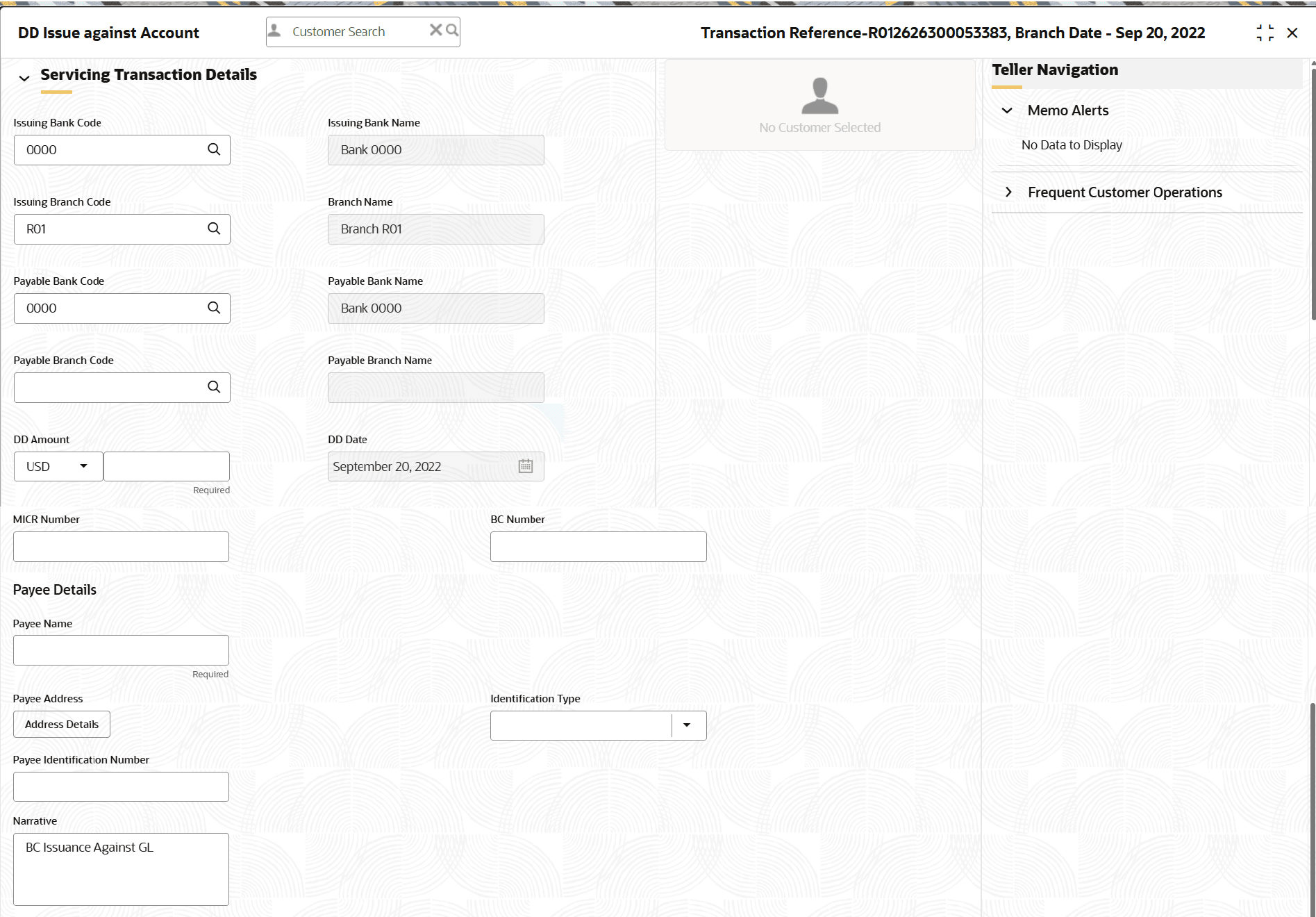

8.2.1 DD Issue Against Account
The Teller can use the DD Issue Against Account screen to issue a DD against the CASA of a customer.
To issue a DD against the savings account:
  1. On the Homepage, from Teller mega menu, under Remittances, click DD Issue - Account or specify DD Issue - Account in the search icon bar and select the screen.
    The DD Issue Against Account screen is displayed.
    Figure 8-23 DD Issue Against Account
  2. On the DD Issue Against Account screen, specify the fields. For more information on fields, refer to the field description table.
    The fields marked as Required are mandatory.
