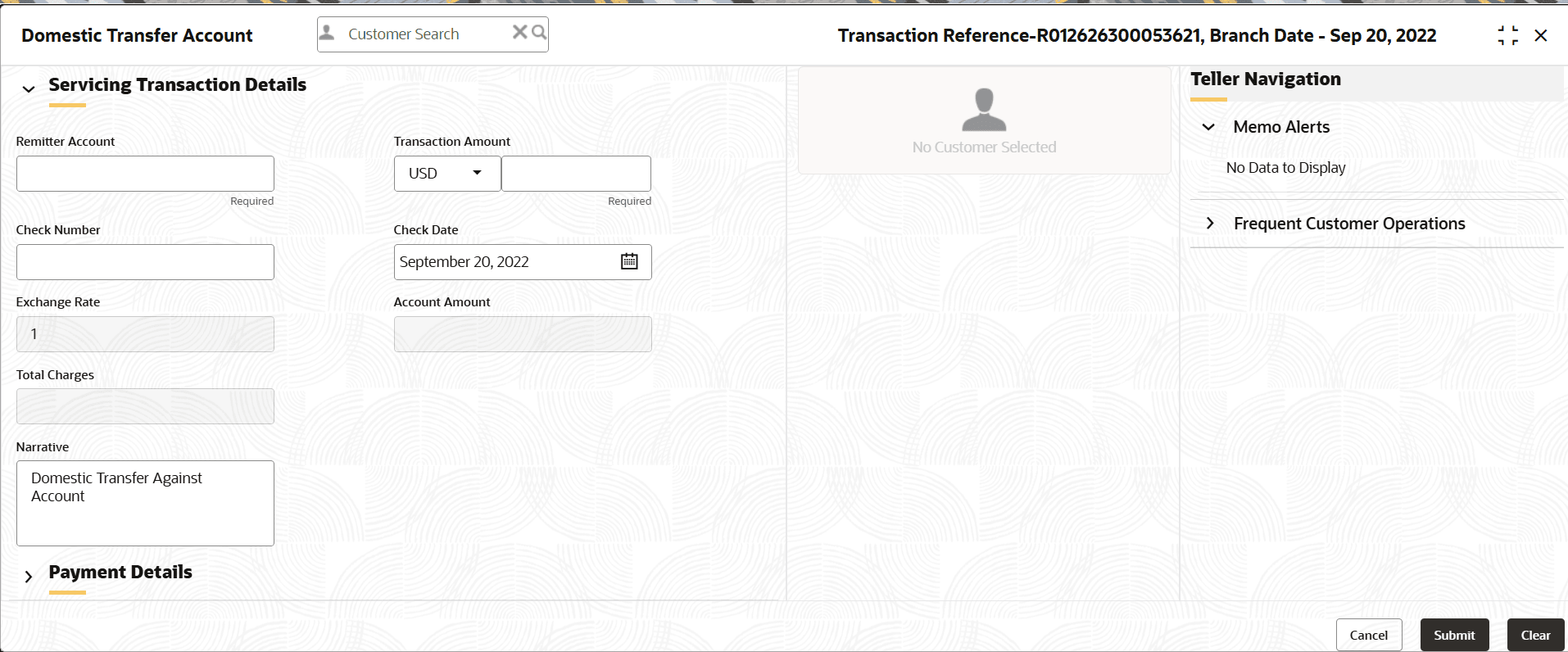

    Figure 6-3 Domestic Transfer Against Account
  2. On the Domestic Transfer Against Account screen, specify the fields. For more information on fields, refer to the field description table.

    Table 6-3 Domestic Transfer Against Account - Field Description
    Field Description
    Remitter Account
    Specify the customer account from which the funds need to be debited.
    Transaction Amount
    Displays the transaction account currency and it allows to select from drop-down values. Specify the transaction amount that needs to be debited from the customer account.
    Cheque Number
    Specify the cheque number of the customer account as provided by the customer.
    The system validates the status of the cheque and prompts an error message if incase of a Used or Stopped or Invalid cheque.
    Cheque Date
    Click the calendar icon and select the date on which the cheque has been issued.
    Account Amount
    Displays the amount in terms of the remitter account currency.
    This field is displayed only if Multi-Currency Configuration at the Function Code Indicator level is set as Y.
    Exchange Rate
    Displays the exchange rate used to convert the transaction account currency into credit account currency, and it can be modified.
    If the transaction currency is the same as the account currency, the system displays the exchange rate as 1. This field is displayed only if Multi-Currency Configuration at the Function Code Indicator level is set as Y.
    Total Charges
    Displays the total charge amount, which is computed by the system.
    This field is displayed only if Total Charges Configuration at the Function Code Indicator level is set as Y.
    Narrative
    Displays the default narrative as Domestic Transfer Against Account, and it can be modified.
