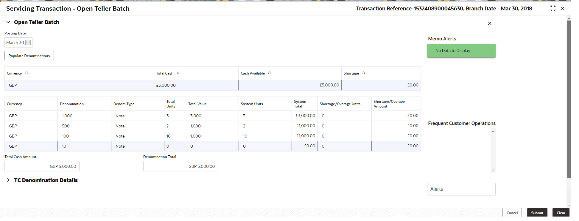

2.4 Open Teller Batch
The Open Teller Batch screen is used to open a teller batch on a specified date.
A Teller can initiate the teller batch with the current cash position that has been retained from the previous day or start with zero cash and subsequently buy cash from the vault. The system will default the cash balances on opening a teller batch.
To open a teller batch:
  1. On the Homepage, from Teller mega menu, under Branch Operations, click Open Teller Batch or specify Open Teller Batch in the search icon bar and select the screen.
    The Open Teller Batch screen is displayed.
  2. On the Open Teller Batch screen, specify the fields. For more information on fields, refer to the field description table.

    Click this button to calculate and display the Total Cash and Shortage/Overage Amount fields based on the currency selected.
  3. Click Submit.
    The teller batch is opened for the specified posting date.
    The Teller can perform the relevant teller operations for the posting date. The system does not allow to open the teller batch if the physical cash entered is not the same as the system cash. The system also allows to re-open the Teller batch for the current system date.
