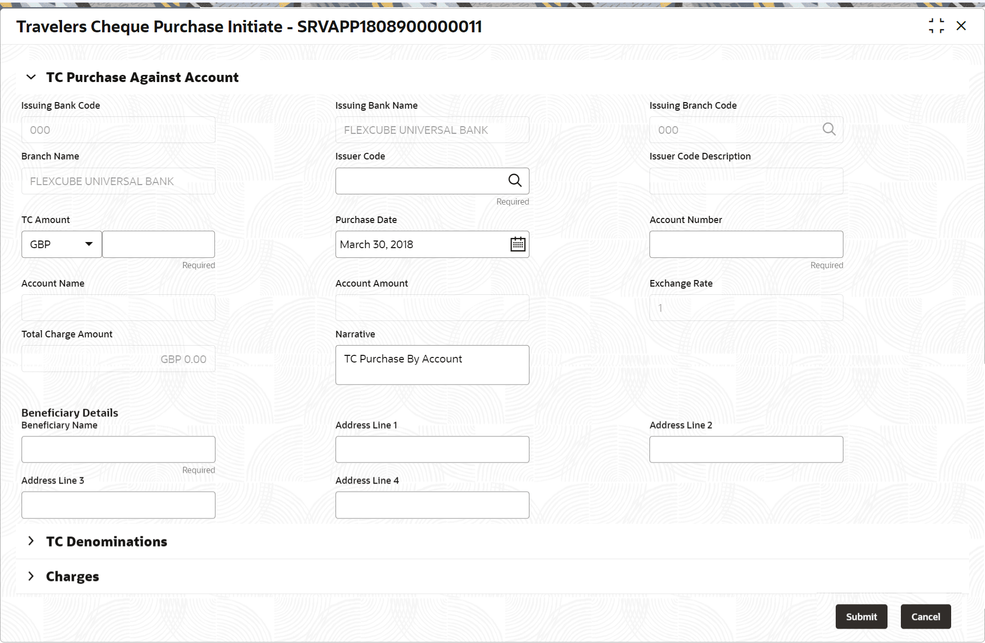

8.4.3 TC Purchase Against Account
The Teller can use the TC Purchase Against Account screen to purchase TC from a customer and the credit the equivalent amount to the customer account.
To purchase TC from a customer:
  1. On the Homepage, from Teller mega menu, under Remittances, click TC Purchase Against Account or specify TC Purchase Against Account in the search icon bar and select the screen.
    The TC Purchase Against Account screen is displayed.
    Figure 8-61 TC Purchase Against Account
  2. On the TC Purchase Against Account screen, specify the fields. For more information on fields, refer to the field description table.
    The fields marked as Required are mandatory.

  3. Specify the TC denomination details. For information on the fields in the TC Denominations segment, refer to Add TC Denominations to Purchase TC.
  4. Specify the charge details. For information on the fields in the Charge Details segment, refer to Charge Details.
  5. Click Submit.
    A teller sequence number is generated, and the Transaction Completed Successfully information message is displayed.
    The transaction is moved to authorization in case of any approval warning raised when the transaction saves.
    The following conditions apply for the TC status:
    • If the system finds the TC for the combination of TC Currency, Issuer Code, TC Denom Code, Series, and TC Number, the TC status will be updated to Purchased.
    • If the record is not found for the above-mentioned combination, during transaction completion, the system creates individual TC records for the combination of TC Currency, Issuer Code, TC Denom Code, Series, and TC Number with TC status as Purchased.
