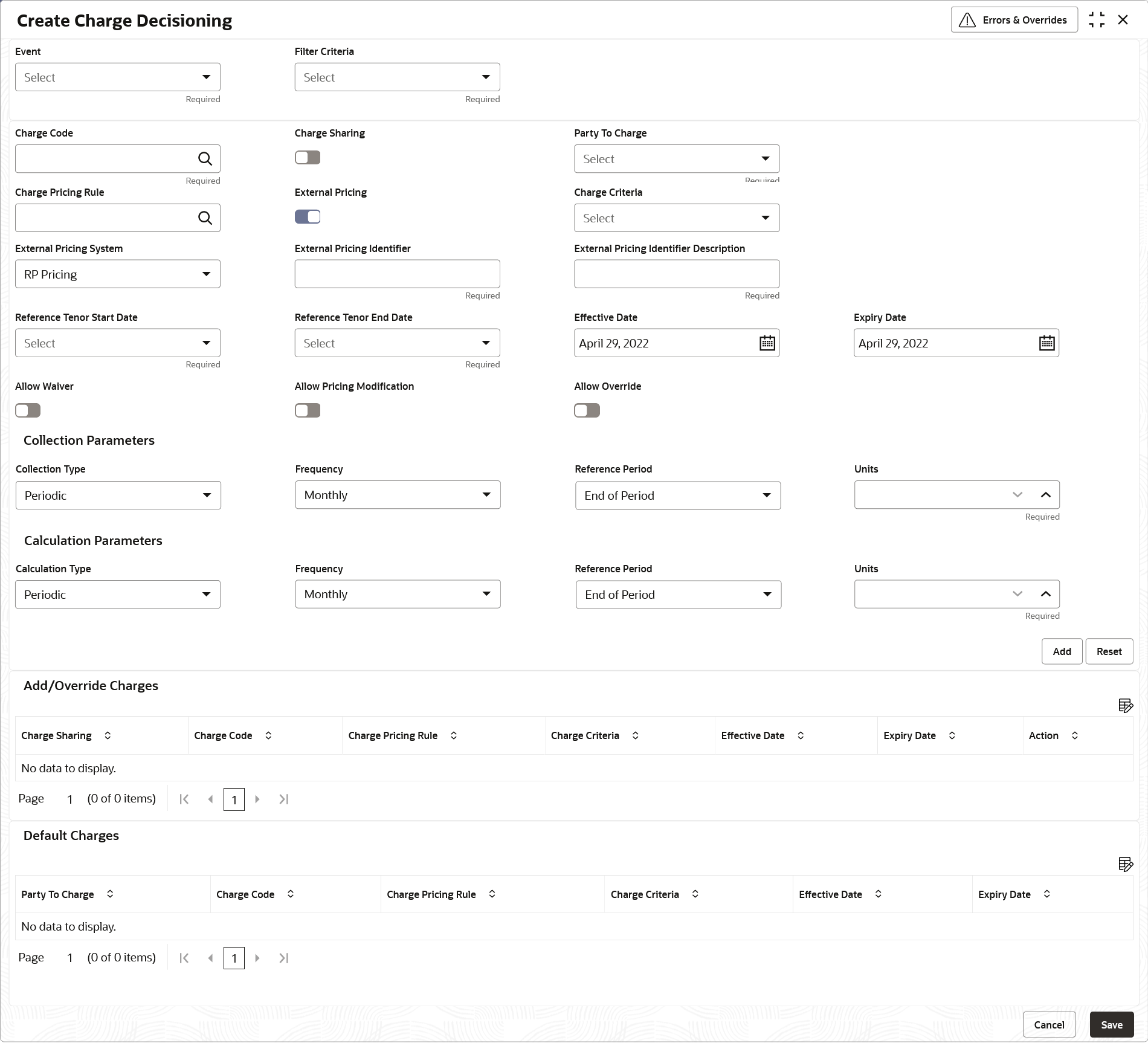

- On Home screen, click Receivables And Payables. Under Receivables And Payables, click Maintenance.
- Under Maintenance, click Charges. Under Charges, click Charge Decisioning.
- Under Charge Decisioning, click Create Charge Decisioning.The Create Charge Decisioning screen displays.
- Specify the fields on Create Charge Decisioning screen.For more information on fields, refer to the field description table.
The fields marked as Required are mandatory.Table 3-8 Create Charge Decisioning - Field Description

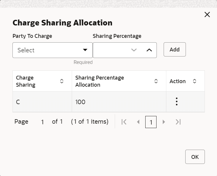

Add/Override Charges Displays the details of new charges added in this grid. Default Charges Displays the default charges configured for the selected event in this grid, if the Inherit Charges is selected as Inherit Default Charges. These charges cannot be modified. - Click Sharing Percentage Allocation link to specify the sharing percentage for each party.The Charge Sharing Allocation popup screen displays.
- From the Party to Charge list, select the party to be charged.
- In the Sharing Percentage, enter the percentage to be allotted to the selected party.
- Click Add to add the details in the grid.
- Repeat these steps to add more parties to be charged.
The sum of percentages of all added parties should be 100. - If required, click
icon under the Action column in the grid and then click Edit to modify details or click Delete to remove the record.
- Click OK to save the charge sharing details.

- Click the hyperlink in the table grid to view the details of the pricing rule.The Charge Pricing Rule Details screen displays.
- Perform the following steps to take action on the records in the grid:
- Select the record in the grid and click Options icon in the Action column.
- Click Edit to modify the details.
- Click Delete to remove the record.
- Click Save to save the data and send it for authorization.
