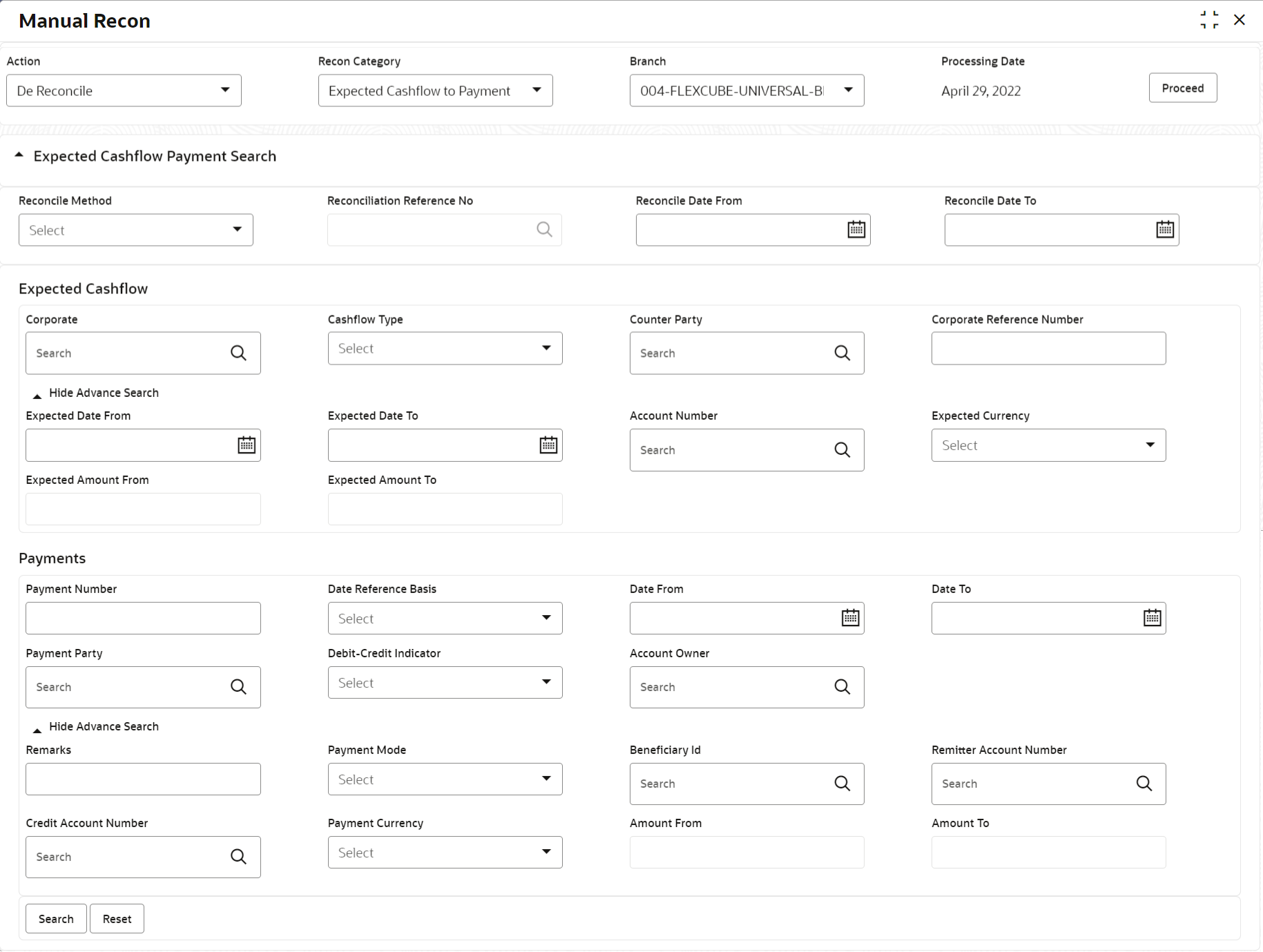

  1. On Home screen, click Receivables And Payables. Under Receivables And Payables, click Manual Recon.
    The Manual Recon screen displays.
  2. In the Action field, select the action to be performed as Reconcile or De Reconcile.
  3. In the Recon Category list, select the category as Expected Cashflow to Payment.
  4. In the Branch list, select the branch for which reconciliation needs to be done. By default, the branch of the logged-in user is selected.
  5. Click Proceed to view the search parameters to search transactions.
  6. Specify the fields on Manual Recon screen.
    The fields marked as Required are mandatory.

  7. Optional: Click Reset clear the selected values.
  8. Click Search to view the result.
