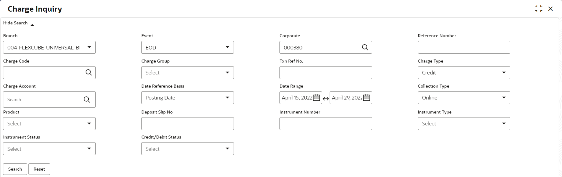

- Specify the fields on Charge Inquiry screen.For more information on fields, refer to the field description table.
The fields marked as Required are mandatory.Table 8-5 Charge Inquiry - Field Description
Field Description Branch Select the required branch to proceed further. By default, the branch of the logged-in user is selected. Event Select the event, on the occurrence of which, the charge(s) has been applied. Corporate Click the search icon and select the corporate party that has been charged. Reference Number Specify the reference number to fetch the calculated / collected charges for the same. Charge Code Click the search icon and select the code of the charge being searched. Charge Group Select the charge group of the charge being searched. The available options are: - Rebates
- Tax
- Commission
- Fee
Txn Ref No. Specify the reference number of the charge being searched. This field displays a list of relevant reference numbers once a corporate has been selected. Charge Type Select whether the charge is Debit or Credit type. Charge Account Click the search icon and select the account number that the charge has been debited from or credited to. You can select the account type, whether customer account or GL account, in the Charge Account search window that pops-up. Date Reference Basis Select whether the charges should be searched based on the ‘Posting Date’ or the ‘Calculation Date’. Date Range Specify the ‘from’ and ‘to’ dates for the option selected from the ‘Date Reference Basis’ list. Collection Type Select whether the charge has been collected ‘Online’ or in a ‘Batch’. Product Select the product against which the charge has been applied. Deposit Slip No Specify a deposit slip number to view all charge transactions that have been calculated and collected for that deposit slip number. Instrument Number Specify an instrument number to view all charge transactions that have been calculated and collected for that instrument number. Instrument Type Select the type of instrument against which the charge has been applied. The available options are: - PDC Collection
- CDC Collection
- Cash Deposit
- Cash Withdrawal
Instrument Status Select the status of the instrument against which the charge has been applied. The available options are: - Booked
- Hold
- Returned
- Realized
Credit/Debit Status Select the required transaction status. The available options are: - Credited
- Reversed
- Partially Reversed

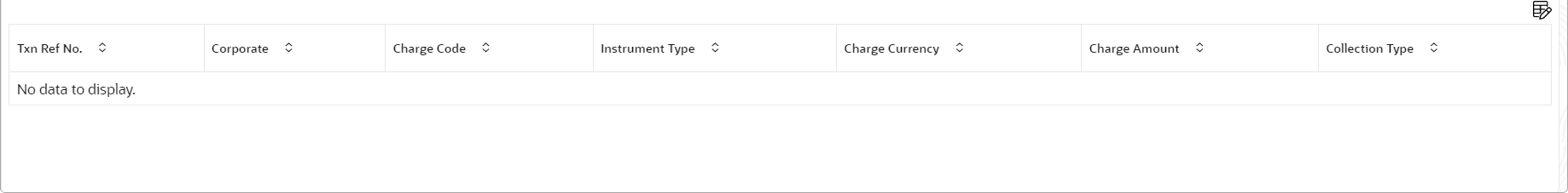

- Click Search to view the search results. Or, click Reset to clear the search criteria.The Charge Inquiry - Search Results screen displays.
Figure 8-17 Charge Inquiry - Search Results

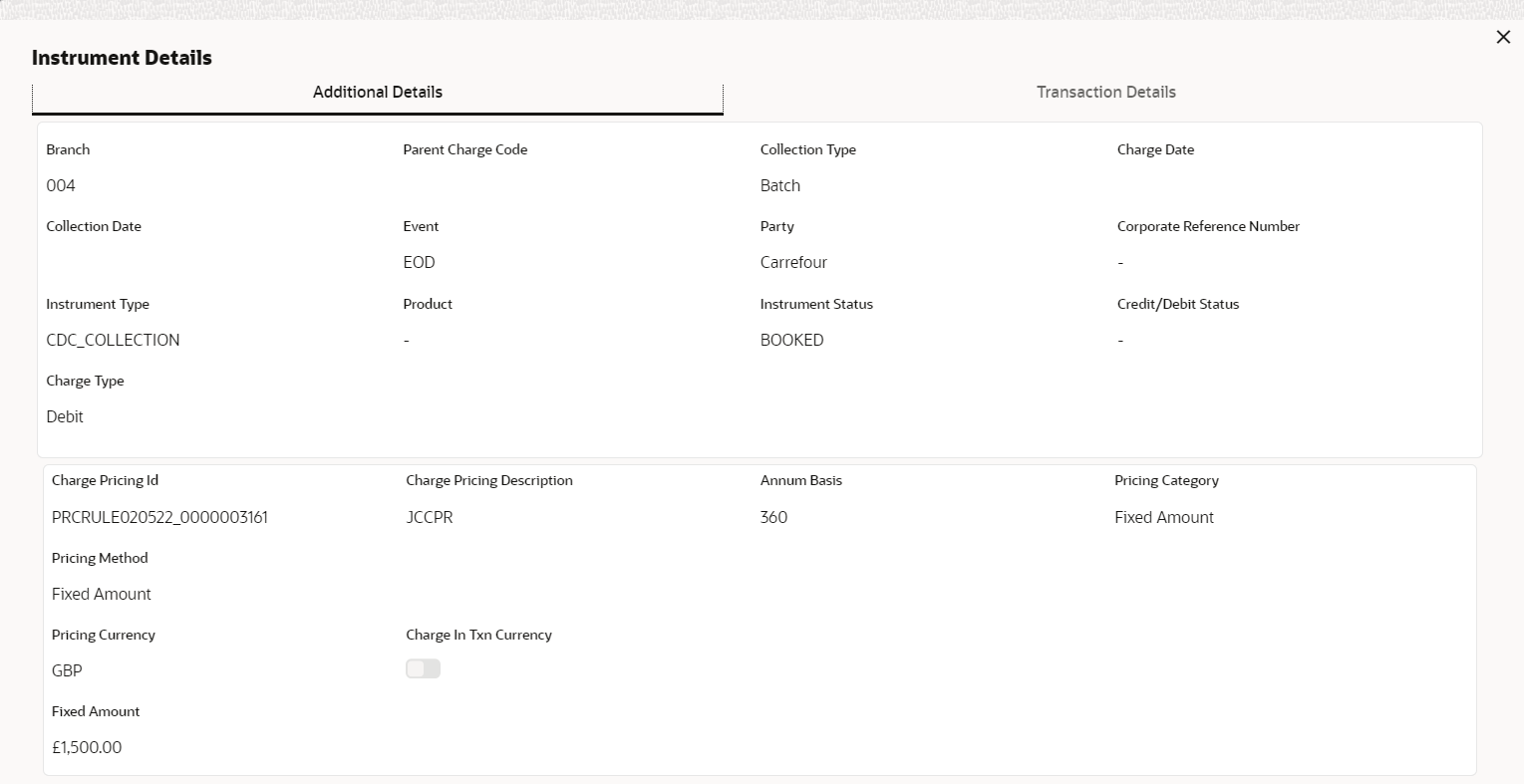

- Click on the hyperlinked data in the column(s) to view more details of the record.The Instrument Details - Additional Details screen displays.
Figure 8-18 Instrument Details - Additional Details

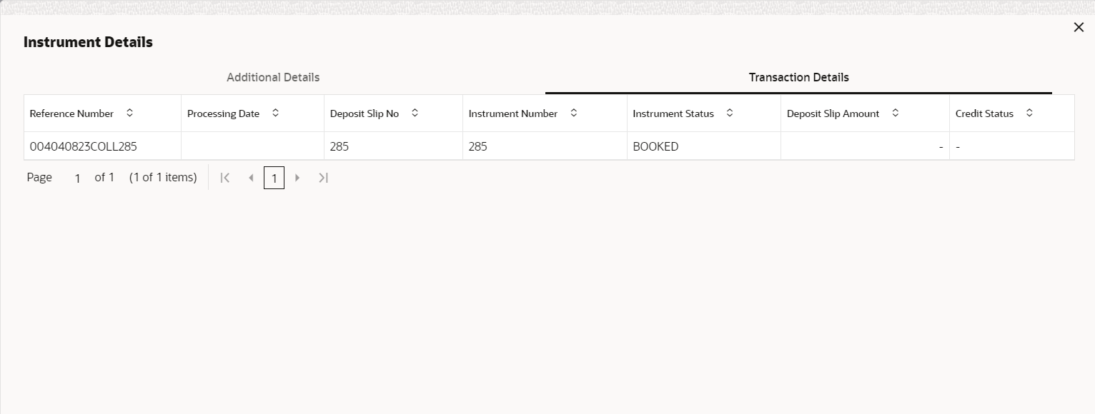

- Click on Transaction Details tab.The Instrument Details - Transaction Details screen displays.
Figure 8-19 Instrument Details - Transaction Details
