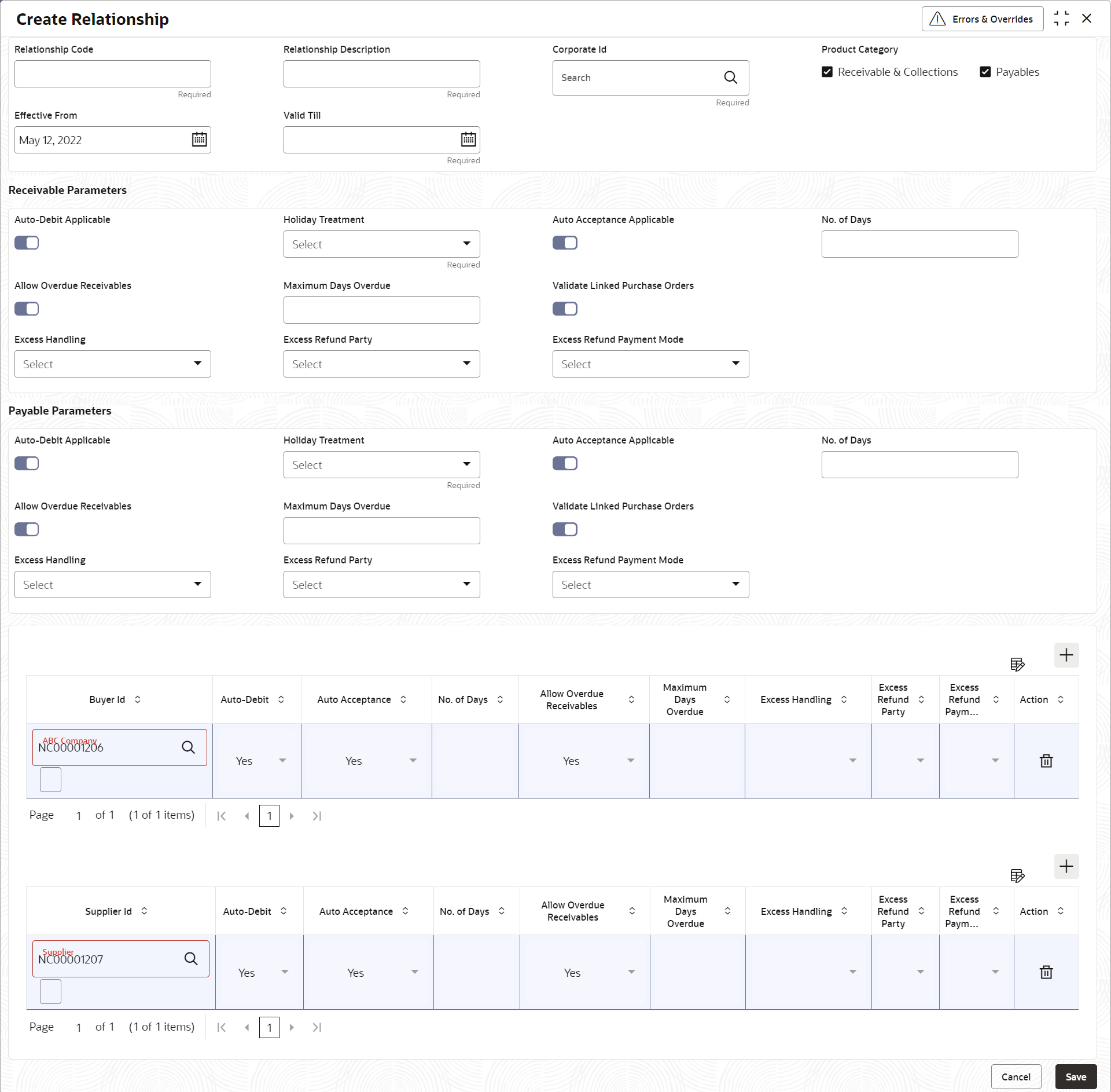

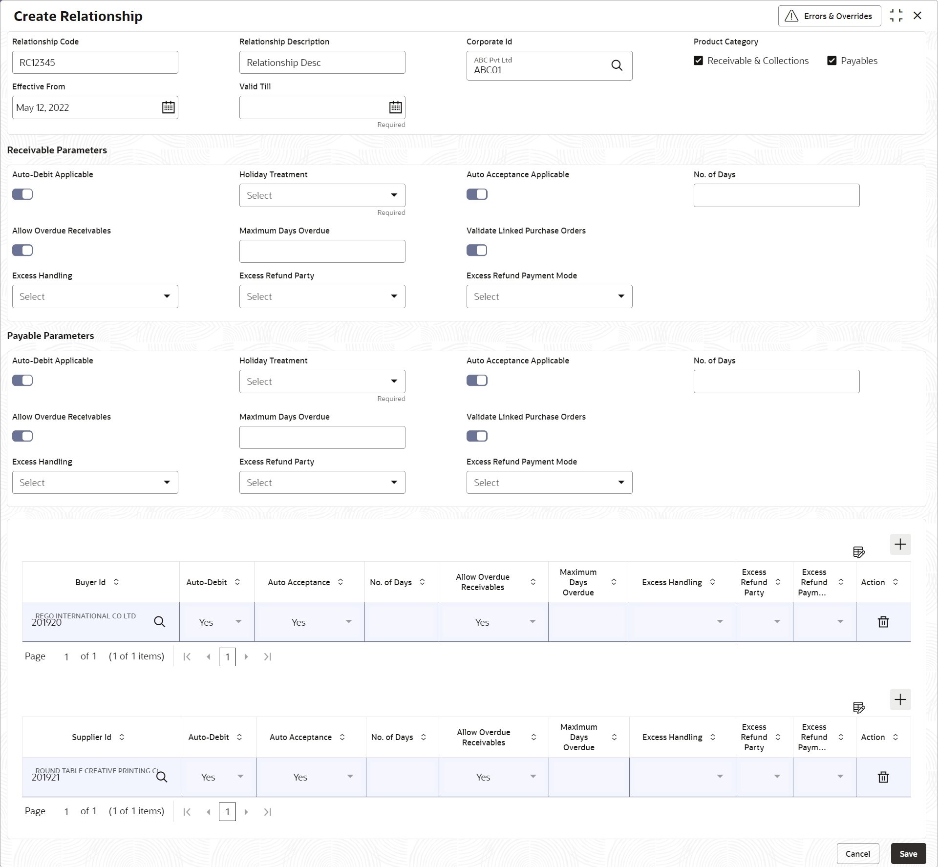

- Under Maintenance, click Relationship Management. Under Relationship Management, click Create Relationship.The Create Relationship - Customer screen displays if the Corporate Id is selected with the Customer.The Create Relationship - Non Customer screen displays if the Corporate Id is selected with the Non Customer.
Figure 3-50 Create Relationship - Customer
Figure 3-51 Create Relationship - Non Customer
- Specify the fields on Create Relationship screen.For more information on fields, refer to the field description table.
The fields marked as Required are mandatory.Table 3-25 Create Relationship - Field Description

† For existing implementations where relationships would be present, the field for Validate Linked Purchase Orders will be defaulted on the basis of System Parameter Maintenance for the same. System Parameter maintenance will be defaulted to ‘Yes; but can be changed at the discretion of the bank or Financial Institution during upgrade to current release version. - In the grid section, click Add icon to add the selected values in the grid.A message appears enquiring if the relationship parameters should be applied to the counterparty record.
- Click Confirm, if the relationship parameters must be
percolated to the counterparty. Else, click Cancel.
If you click ‘Confirm’, the values of Auto-Debit Applicable, Holiday Treatment, Auto Acceptance Applicable, No. of Days, Allow Overdue Receivables, and Maximum Days Overdue fields are percolated to the counterparty being added. On clicking ‘Cancel’, these fields remain NULL at the counterparty-level. - Perform the following steps in the grid.
- Click Search icon in the Buyer/Supplier Name and select the buyer/supplier.
- Click Add icon to add Non Customer details.

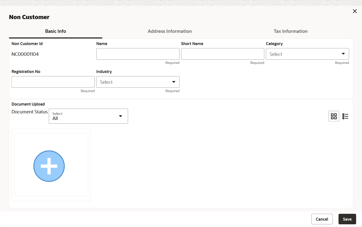

Relationship cannot be created between non-customers, i.e., non-customers cannot be added if the selected Corporate Id is a non-customer.The Non Customer - Basic Info screen displays. - In the Basic Info tab, specify the non-customer basic details such as name, category, registration number, and industry. The user can also upload documents of the non-customers.

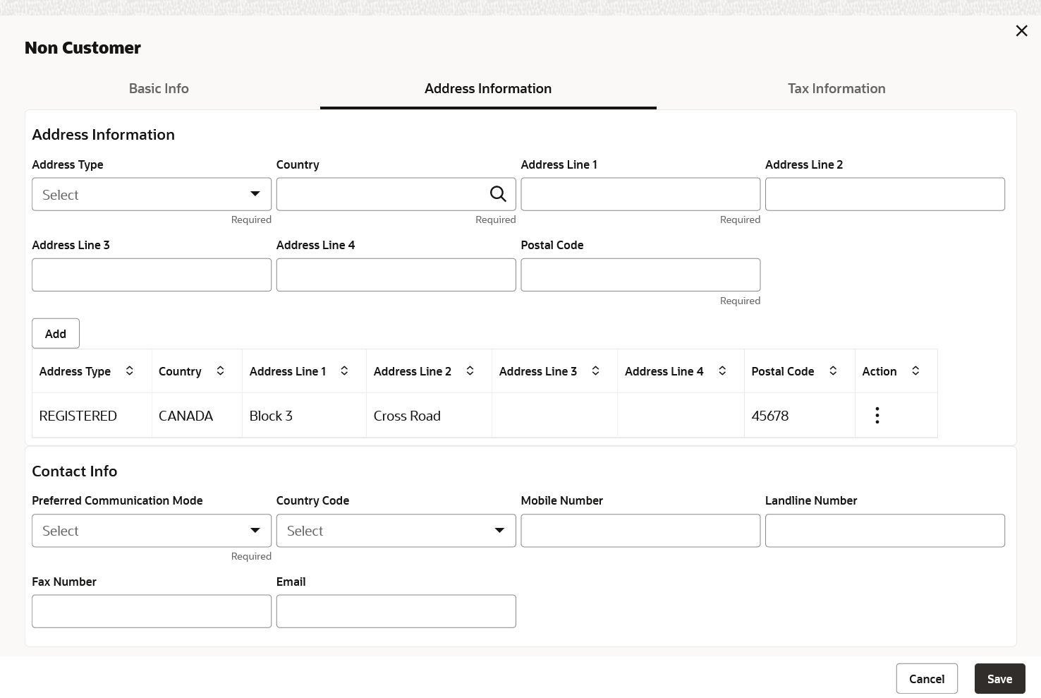

- Click Address Information tab.The Non Customer - Address Information screen displays.
Figure 3-53 Non Customer - Address Information
- In the Address Information tab, specify the address related information of the non-customer.

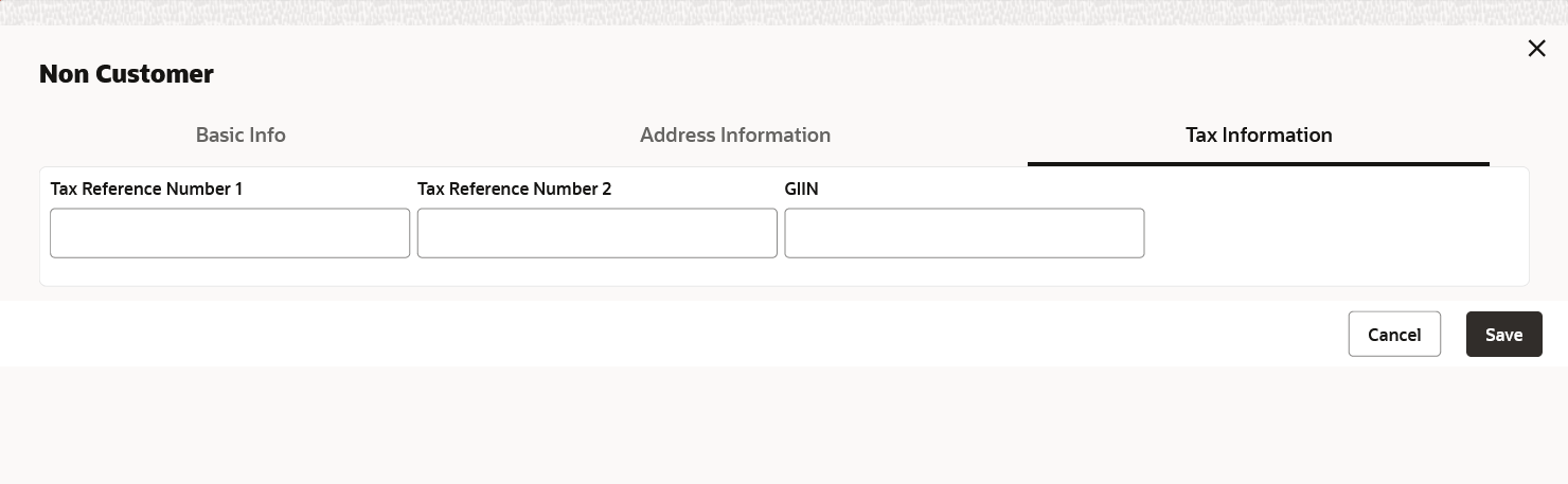

- Click Tax Information tab.The Non Customer - Tax Information screen displays.
Figure 3-54 Non Customer - Tax Information
- In the Tax Information tab, specify the tax reference numbers and GIIN of the non-customer.
- Click Save to save the non-customer data.
