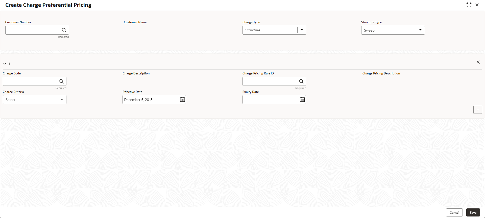

    The Create Charge Preferential Pricing screen displays.
    Figure 17-9 Create Charge Preferential Pricing
  4. On Create Charge Preferential Pricing screen, specify the fields.
    The fields marked as Required are mandatory.
    Table 17-14 Create Charge Preferential Pricing - Field Description
    Field Description

  5. Click Save to save the details.
The user can view the configured charge preferential pricing in the View Charge Preferential Pricing screen.
