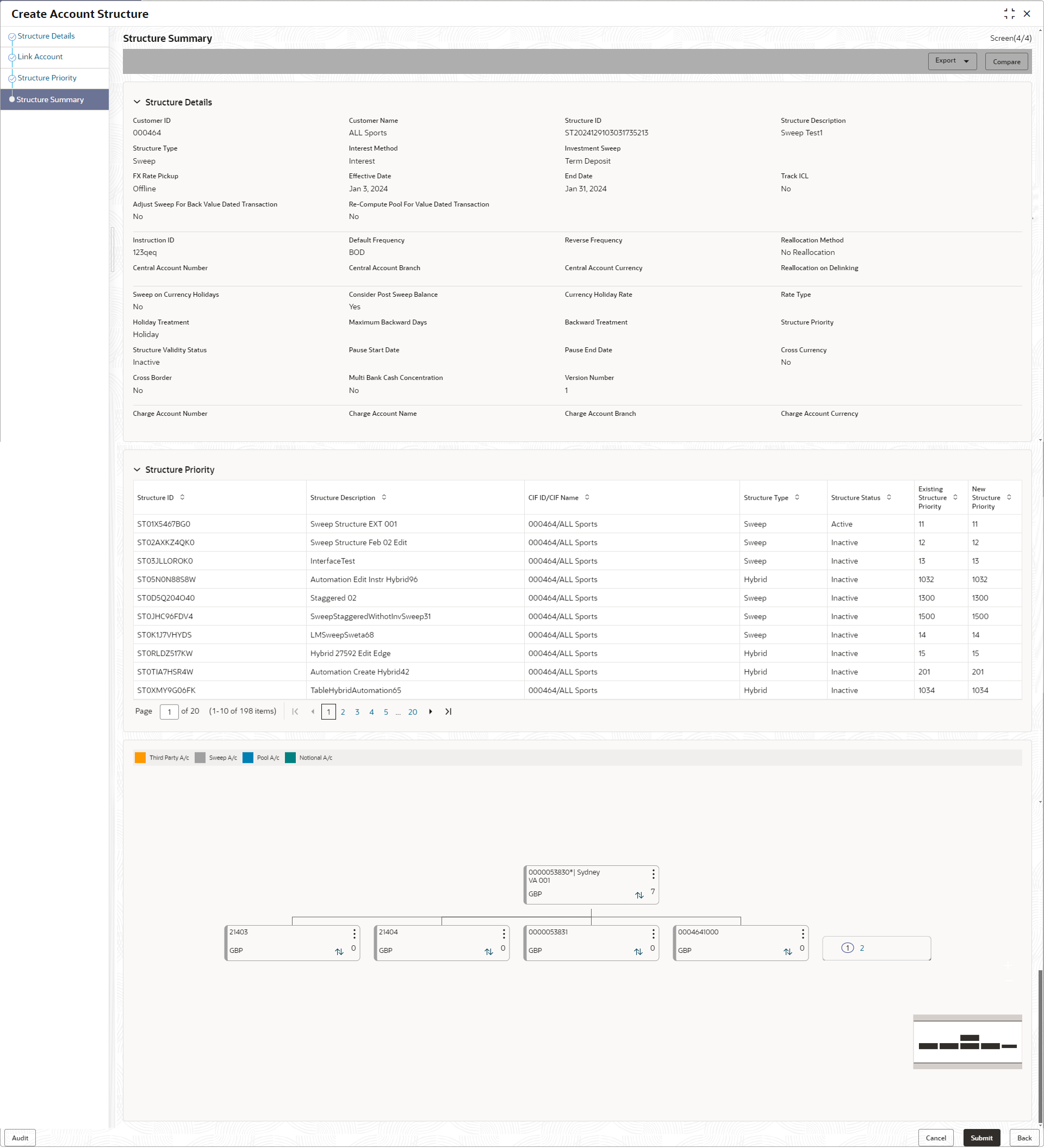

6.1.7 Structure Summary
This topic describes the systematic instruction to view the structure details with the tree created.
The Structure Summary screen provides the summary of the structure created or modified. The tree will display unidirectional or bidirectional arrows as per the direction of sweep between the Child and Parent accounts.
  1. Click Next in the Link Account screen after successfully capturing the data, to view the summary screen.
    The Structure Summary screen displays. For more information on fields, refer to the field description table.

  2. Select Excel from the Export drop-down list to download the structure details in excel (.xls) format.
  3. Select Compare to compare the difference in values.
  4. Click Back to navigate to the previous screen (Link Account). In case, the user wants to make some changes before saving the structure.
  5. Click Submit to save and submit the structure.

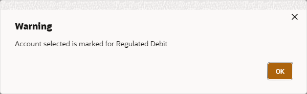

    The Override Warning message displays if the any of the selected account is marked Regulated Debits as Y.
    Figure 6-60 Warning Message - Regulated Debit
    Else, the Confirmation message displays.
