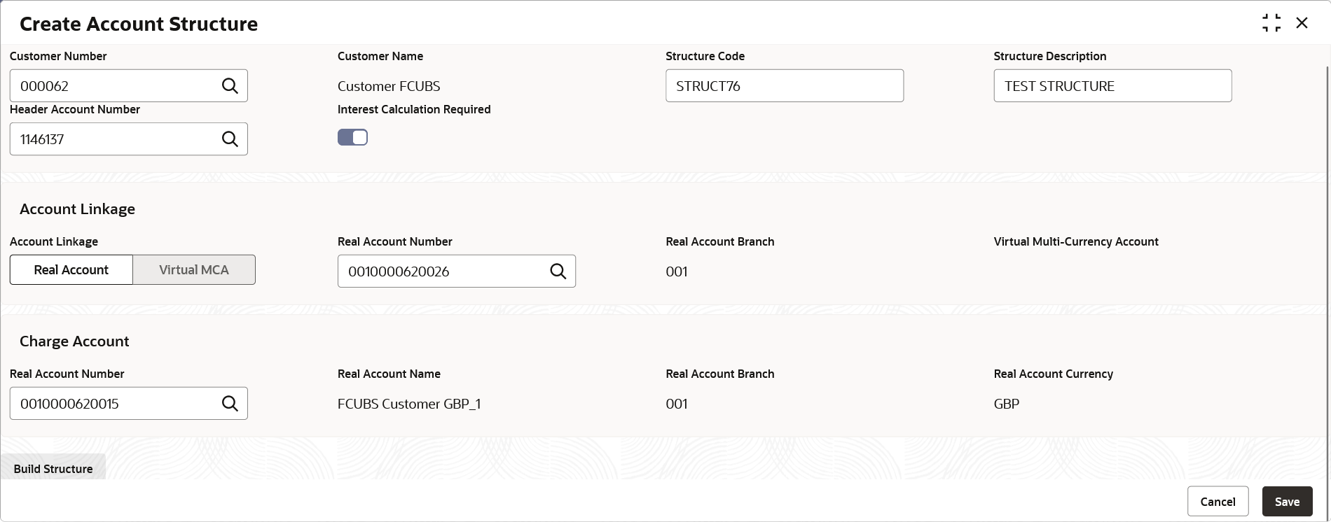

- Specify the fields on Create Account Structure screen.
The fields marked as Required are mandatory.Table 9-1 Create Account Structure – Field Description
Field Description Customer Number Click Search icon to view and select the required customer number. Customer Name Based on the Customer Number selected, the information is auto-populated. Structure Code Specify a code for the structure. A maximum length of eight alphanumeric characters are allowed.
Structure Description Specify the additional information for the structure. Header Account Number Click Search icon to view and select the required header account number. This is the root node for the structure and is always a virtual account.
Interest Calculation Required If enabled, indicates the interest calculation required at the account structure level. Account Linkage Select one of the options below: - Real Account: If selected, the user can configure an account structure for a real account. The Real Account Number and the Real Account Branch are enabled to select the account.
- Virtual MCA: If selected, the user can configure an account structure for a virtual multi-currency account. The Virtual Multi-Currency Account is enabled to select the account.
Real Account Number Click Search icon to view and select the required real account number. Real Account Branch Based on the Real Account Number selected, the information is auto-populated. Virtual Multi-Currency Account Click Search icon to view and select the required virtual multi-currency account. Real Account Number Click Search icon to view and select the required real account number. Real Account Name Based on the Real Account Number selected, the information is auto-populated. Real Account Branch Based on the Real Account Number selected, the information is auto-populated. Real Account Currency Based on the Real Account Number selected, the information is auto-populated. - Click Build Structure to define the account structure using Diagram View or Detail View.The selected Header Account Number displays as the first node.

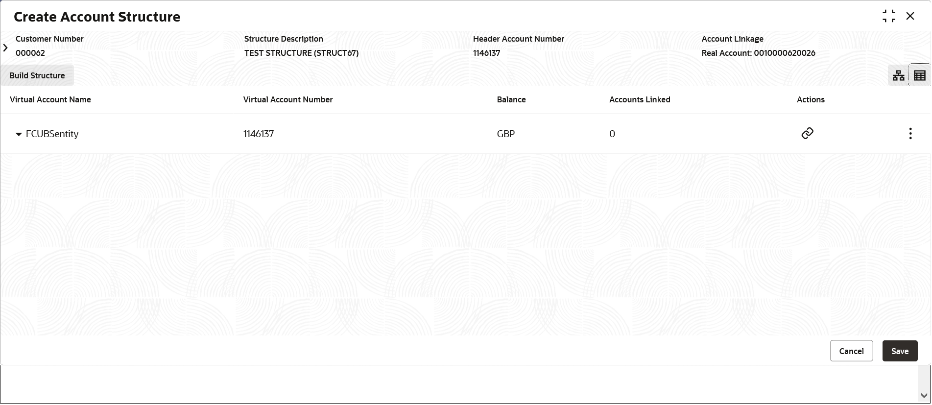

Figure 9-2 Create Account Structure - Header Account Number

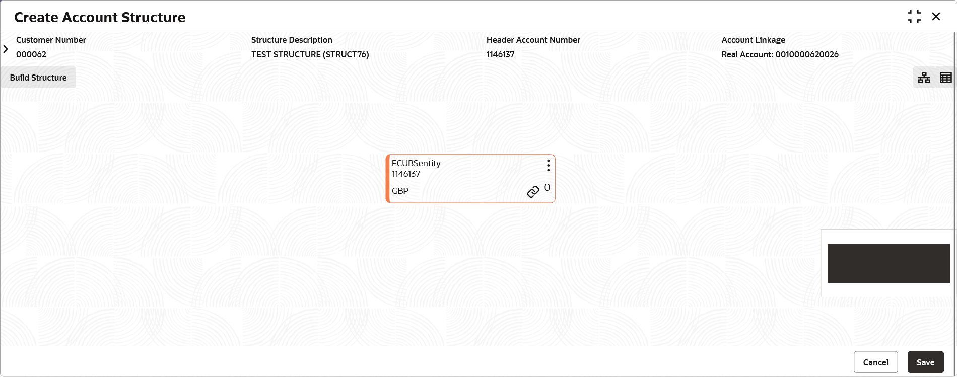

Diagram View
- For Diagram View, follow the below steps:

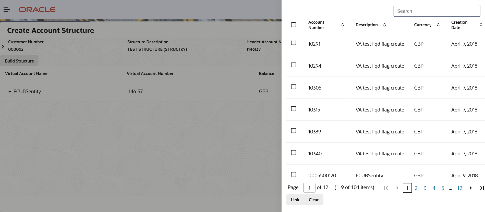

- Click on the Link button to link the virtual accounts to the structure.
Figure 9-3 Create Account Structure - Diagram View - Link Account

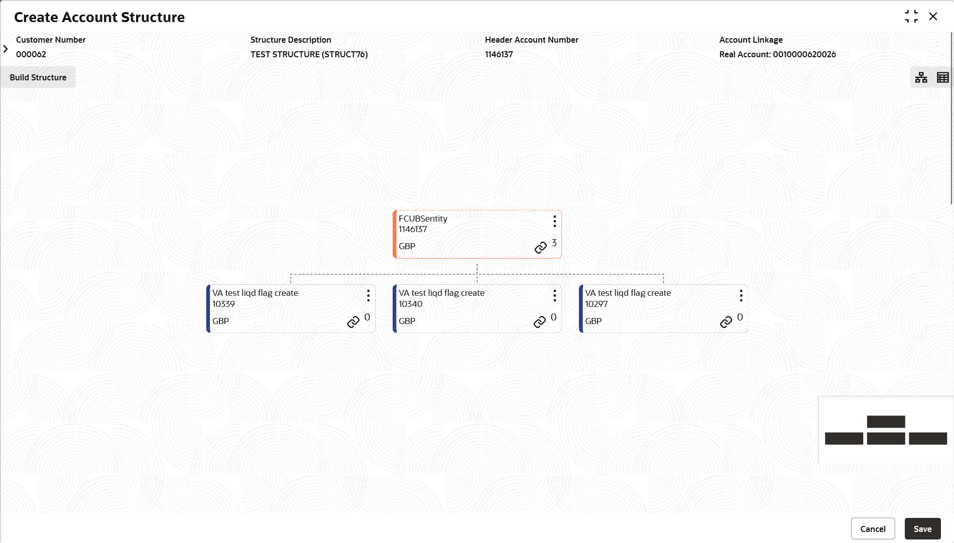

- Select the virtual account number from the list which needs to be linked and click Link.
Figure 9-4 Create Account Structure - Diagram View
- The user can select a node, click on three dots symbol, and click on Account Details to view more details of the account.
- The user can select a node, click on three dots symbol, and click on Undo Link to remove the newly added linkage before submitting the request.
