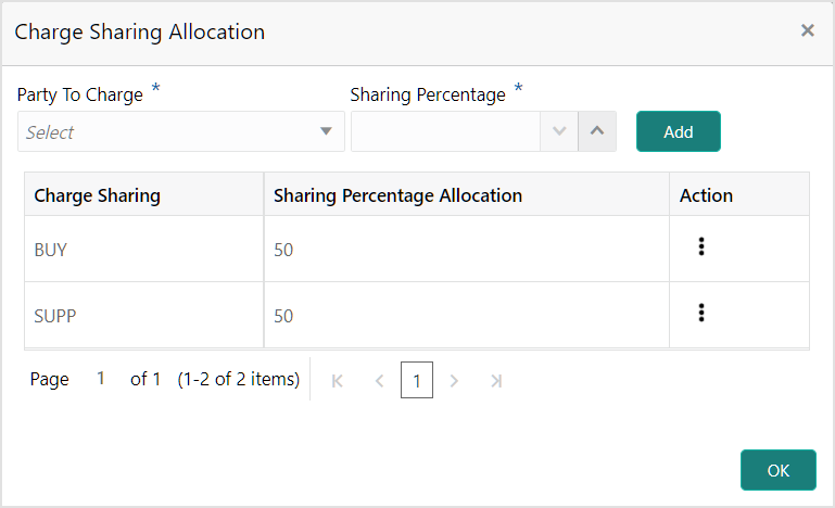

  5. Click Sharing Percentage Allocation link to specify the sharing percentage for each party.
    The Charge Sharing Allocation popup screen displays.
    Figure 3-23 Charge Sharing Allocation
    1. From the Party to Charge list, select the party to be charged.
    2. In the Sharing Percentage, enter the percentage to be allotted to the selected party.
    3. Click Add to add the details in the grid.
    4. Repeat these steps to add more parties to be charged.
      The sum of percentages of all added parties should be 100.
    5. If required, click More Options icon under the Action column in the grid and then click Edit to modify details or click Delete to remove the record.
    6. Click OK to save the charge sharing details.
