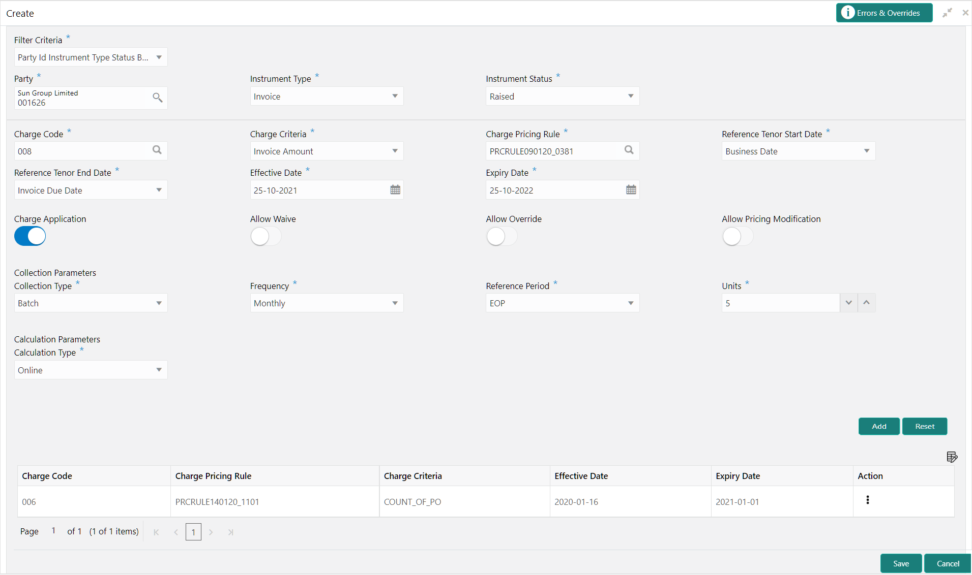

    The Create Charge Preferential Pricing screen displays.
    Figure 3-26 Create Charge Preferential Pricing
  4. Specify the fields on Create Charge Preferential Pricing screen.
    The fields, which are marked with an asterisk, are mandatory.
    Table 3-9 Create Charge Preferential Pricing - Field Description

    Filter Criteria Select the appropriate filter criteria for specific application of accounting entries.
    Based on the selected criteria, the Party ID, Instrument Type, and Instrument Status fields are displayed.
    Party Click the search icon to select the party to map the preferential pricing to.
    Instrument Type Select the type of instrument to map the preferential pricing to.
    Instrument statuses are available based on the selected instrument type.
    This field is displayed only if the Filter Criteria is selected as Instrument Type.
    Instrument Status Select the status of the instrument to map the preferential pricing to.
    Charge Code Click the search icon to select the charge code for pricing configuration.
    Charge Criteria Select the criteria to be considered based on which charge should be calculated.
    Charge Pricing Rule Click the search icon to select the charge pricing rule to be applied.
    Parent Charge Code Select the parent charge code.
    This field is displayed if the Charge Criteria is selected as Parent Charge Code.
    Reference Tenor Start Date Specify which date should be considered to calculate the start of tenor duration.
    Reference Tenor End Date Specify which date should be considered to calculate the end of tenor duration.
    Effective Date Click the calendar icon to select the start date of the preferential charge validity.
    Expiry Date Click the calendar icon to select the end date of the preferential charge validity.
    Charge Application Switch the toggle ON to enable charge application.
    Allow Waive Switch the toggle ON to enable charge waiving.
    Allow Override Switch the toggle ON to enable overriding of the charge.
    Allow Pricing Modification Switch the toggle ON to allow pricing modification.
    Collection Parameters Displays the fields related to Collections Parameters.
    Collection Type Specify how the pricing should be collected.
    Frequency Specify the frequency of charge collection.
    This field is displayed only if the Collection Type is selected as Batch.
    Reference Period Specify when the collection should take place for the selected frequency.
    Units Specify whether the charge collection should take place as per units of specified frequency.
    Calculation Parameters Displays the fields related to Calculation Parameters.
    Calculation Type Specify how the pricing should be calculated.
    Frequency Specify the frequency of charge calculation.
    This field is displayed only if the Calculation Type is selected as Batch.
    Reference Period Specify when the calculation should take place for the selected frequency.
    Units Specify whether the charge calculation should take place as per units of specified frequency.
    Charges Grid Displays the details of the preferential pricing added as an entry in this grid.
  5. Click Add to add the details to the grid.
  6. Click Reset to reset the rows in the grid.
  7. Perform the following steps to take action on the records in the grid:
    1. Select the record in the grid and then click More Options icon in the Action column.
    2. Click Edit to modify the details.
    3. Click Delete to remove the record.
  8. Click Save to save the record and send it for authorization.
