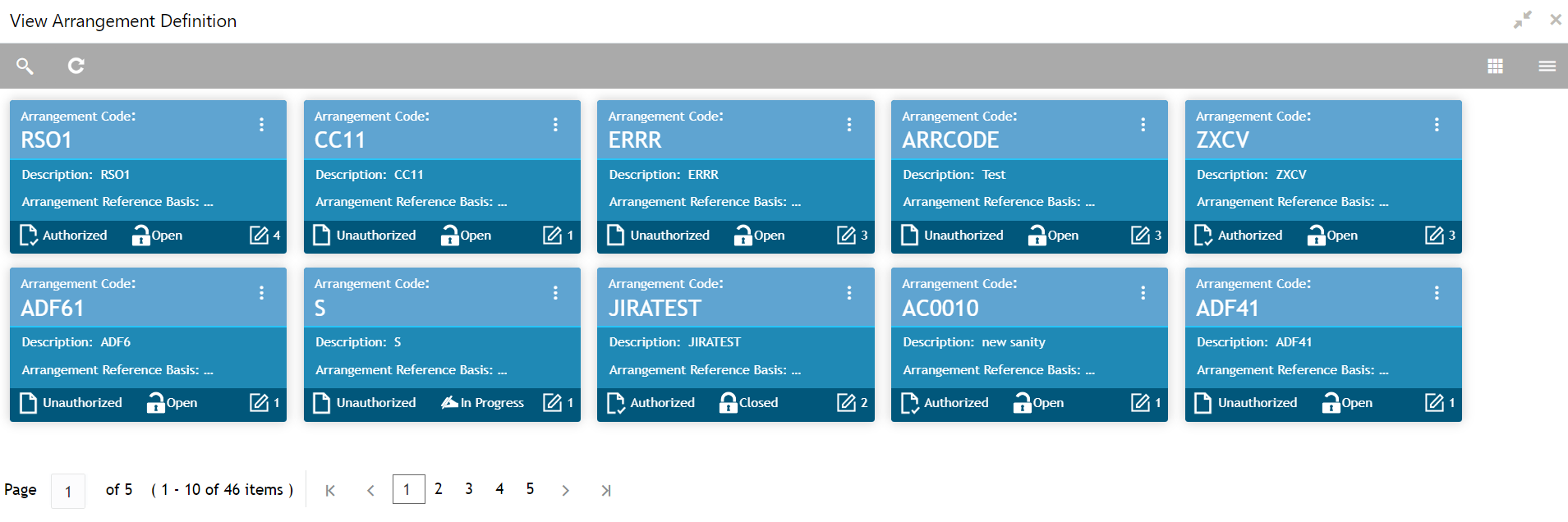

A tile is present for each record that has been created. The bottom portion of each record-tile displays the following:
  • The status, whether Authorized, Unauthorized, or Rejected
  • Open or Closed
  • The number of times the record has been submitted by the Maker added.
Specify User ID and Password, and login to Home screen.
  1. On Home screen, click Cash Management. Under Cash Management, click Collections.
  2. Under Collections, click Maintenance. Under Maintenance, click Arrangement Definition.
  3. Under Arrangement Definition, click View Arrangement Definition.
    The View Arrangement Definition screen displays.
    Figure 3-14 View Arrangement Definition

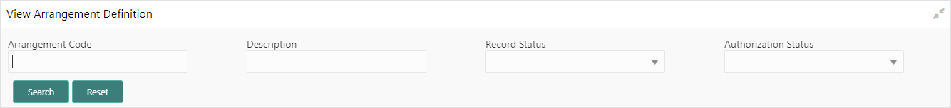

  4. Filter the records in the View screen:
    1. Click Search icon to view the filters. The user can filter the records by Accounting Code, Description, Record Status and Authorization Status.
      The View Arrangement Definition - Search screen displays.
      Figure 3-15 View Arrangement Definition - Search
    2. Select the required filter criteria and click Search to filter the records.
    3. Click Reset to reset the filter criteria.
