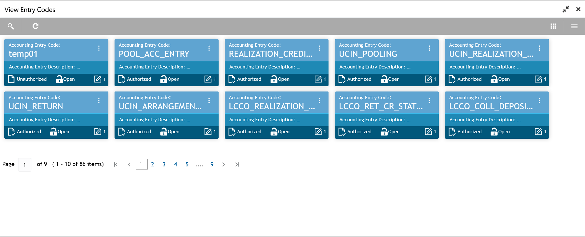

This topic describes the systematic instruction to view, modify, delete, or authorize accounting entry codes that have been created.
A tile is present for each record that has been created. The bottom portion of each record-tile displays the following:
  • The status, whether Authorized, Unauthorized, or Rejected
  • Open or Closed
  • The number of times the record has been submitted by the Maker added.

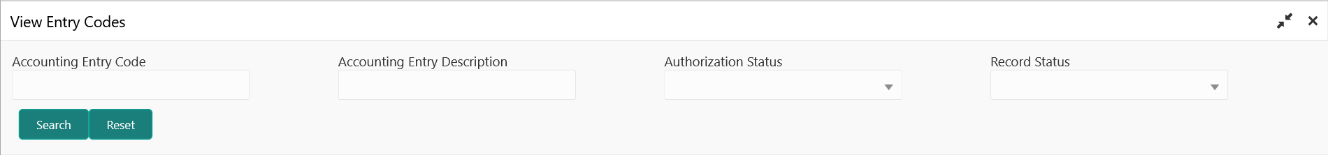

  4. Filter the records in the View screen:
    1. Click Search icon to view the filters. The user can filter the records by Accounting Entry Code, Accounting Entry Description, Authorization Status and Record Status.
      The View Entry Codes - Search screen displays.
      Figure 3-6 View Entry Codes - Search
    2. Select the required filter criteria and click Search to filter the records.
    3. Click Reset to reset the filter criteria.
  5. Click Refresh icon to refresh the records.
  6. Click Options icon and then select any of the following options:
    1. Unlock – To modify the record details. Refer to the Create screen for the field level details.
    2. Authorize – To authorize or reject the record. Authorizing/Rejecting requires necessary access rights.
      • Optional: Click View to view the record details.
      • Select the record and click Approve to approve the record.
      • Select the record and click Reject to reject the record. Specify the relevant comments in the pop-up window that appears, and click Confirm.
    3. Delete/Close – To remove the record.
      • Optional: In the confirmation pop-up window, click View to view the record details.
      • Click Proceed to delete the record.
    4. Copy – To copy the record parameters for creating a new record.
    5. View – To view the record details.
    6. Reopen – To reopen the closed record.
