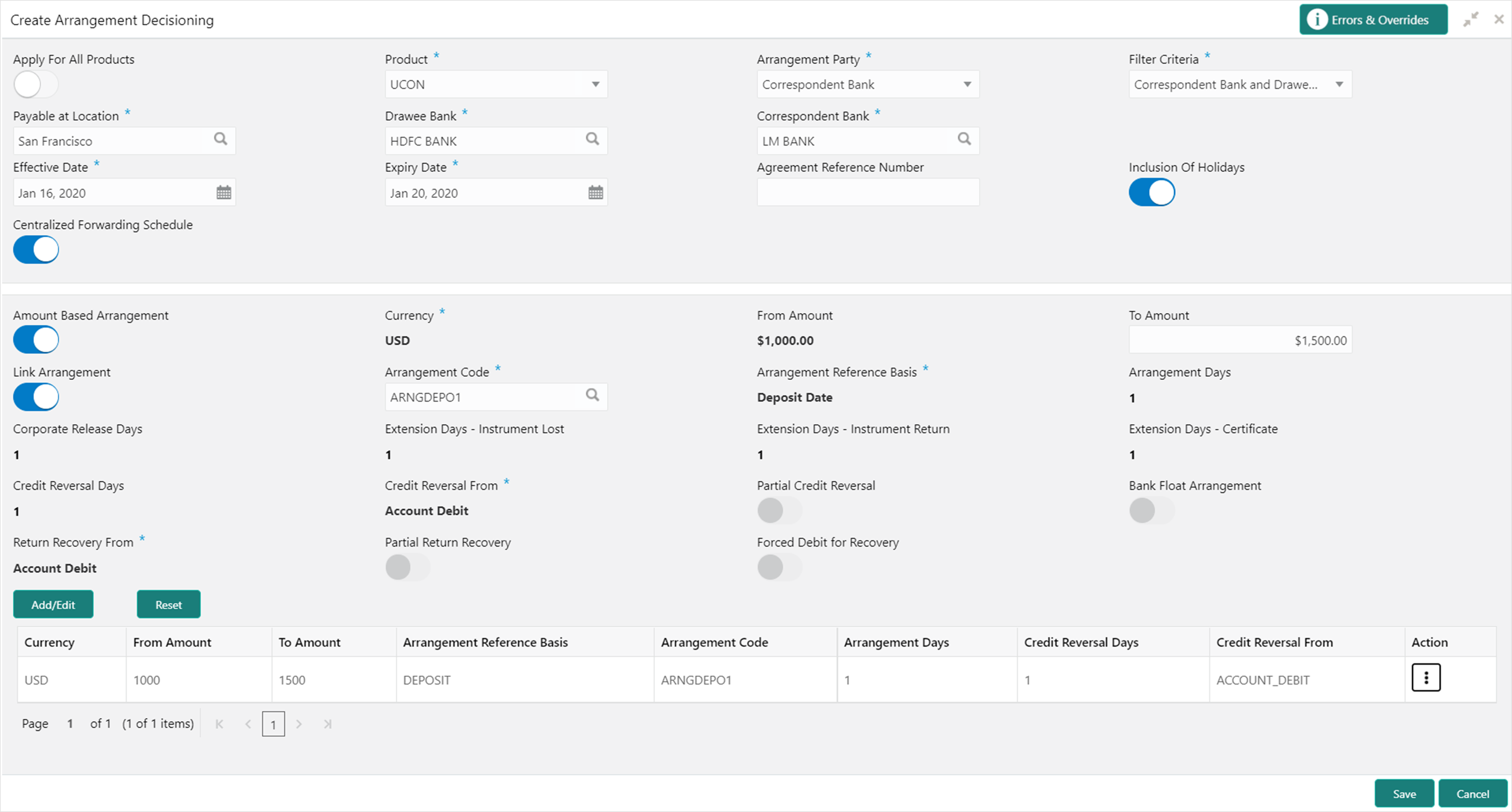

    Figure 3-16 Create Arrangement Decisioning
  4. Specify the fields on Create Arrangement Decisioning screen.

    Location Name Click the search icon to select the location applicable to the corporate. This field cannot be modified once authorized.
  5. Click Add/Edit to add the details to the grid.
    1. Click More Options icon in the Action column to edit or delete the row.
  6. Click Reset to clear the selected values, if required.
  7. Click Save to save the record and send it for authorization.
