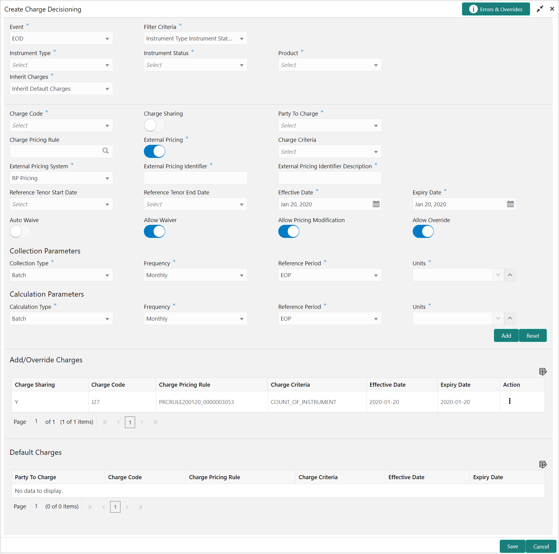

    The Create Charge Decisioning screen displays.
    Figure 3-32 Create Charge Decisioning
  4. Specify the fields on Create Charge Decisioning screen.
    The fields, which are marked with an asterisk, are mandatory.
    Table 3-14 Create Charge Decisioning - Field Description

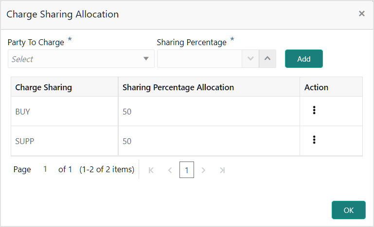

  5. Click Sharing Percentage Allocation link to specify the sharing percentage for each party.
    The Charge Sharing Allocation popup screen displays.
    Figure 3-33 Charge Sharing Allocation
    1. From the Party to Charge list, select the party to be charged.
    2. In the Sharing Percentage, enter the percentage to be allotted to the selected party.
    3. Click Add to add the details in the grid.
    4. Repeat these steps to add more parties to be charged.
      The sum of percentages of all added parties should be 100.
    5. If required, click More Options icon under the Action column in the grid and then click Edit to modify details or click Delete to remove the record.
    6. Click OK to save the charge sharing details.
  6. Click Add to add the details to the grid.
    1. Click More Options icon in the Action column to edit or delete the row.
  7. Click Reset to reset the fields, if required.
  8. Click Save to save the data and send it for authorization.
