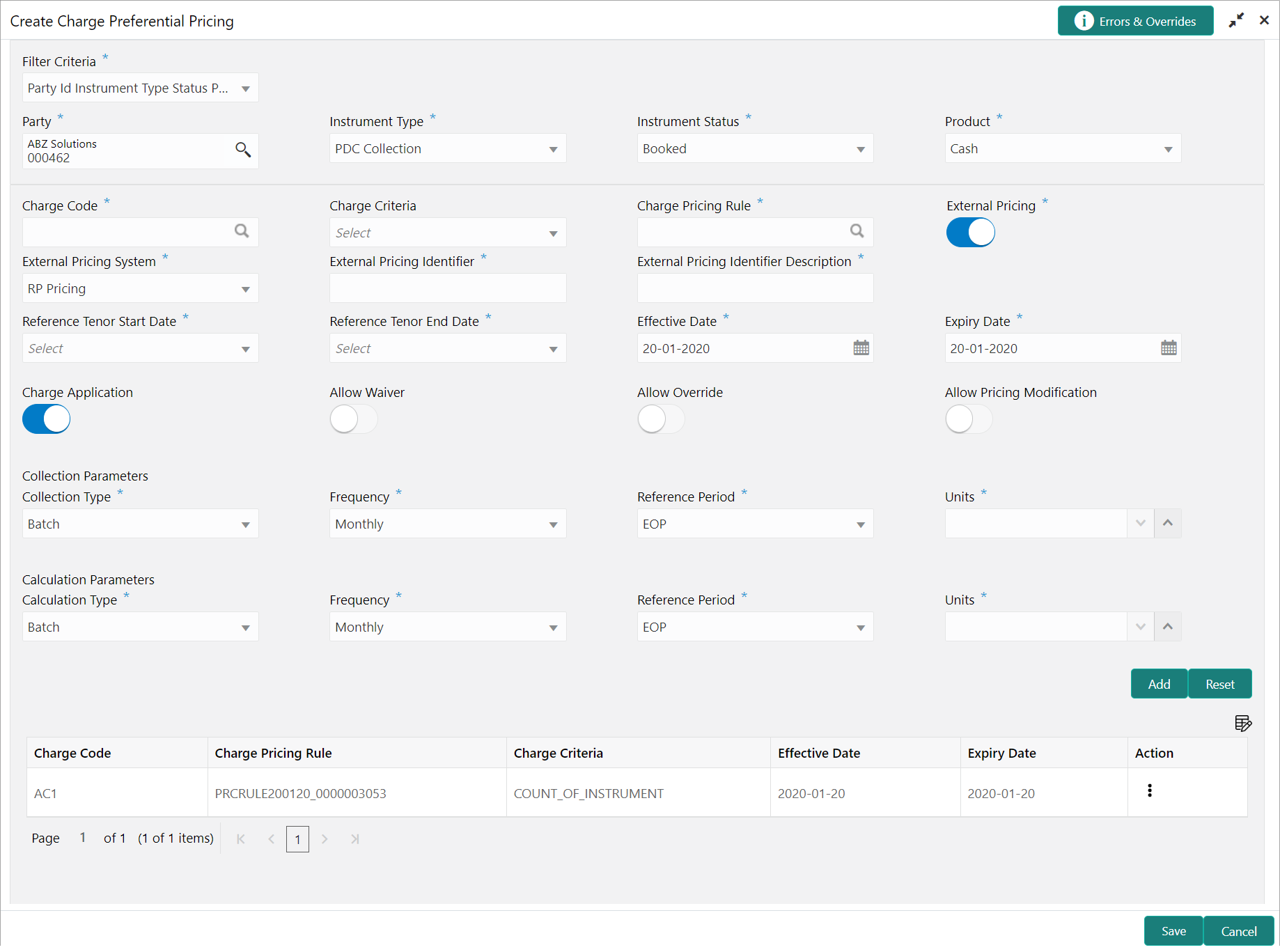

    The Create Charge Preferential Pricing screen displays.
    Figure 3-36 Create Charge Preferential Pricing
  4. Specify the fields on Create Charge Preferential Pricing screen.
    The fields, which are marked with an asterisk, are mandatory.

  5. Click Add to add the details to the grid.
    1. Click More Options icon in the Action column to edit or delete the row.
    2. Click Add Columns icon to add other columns to the grid.
  6. Click Reset to reset the rows in the grid.
  7. Click Save to save the record and send it for authorization.
