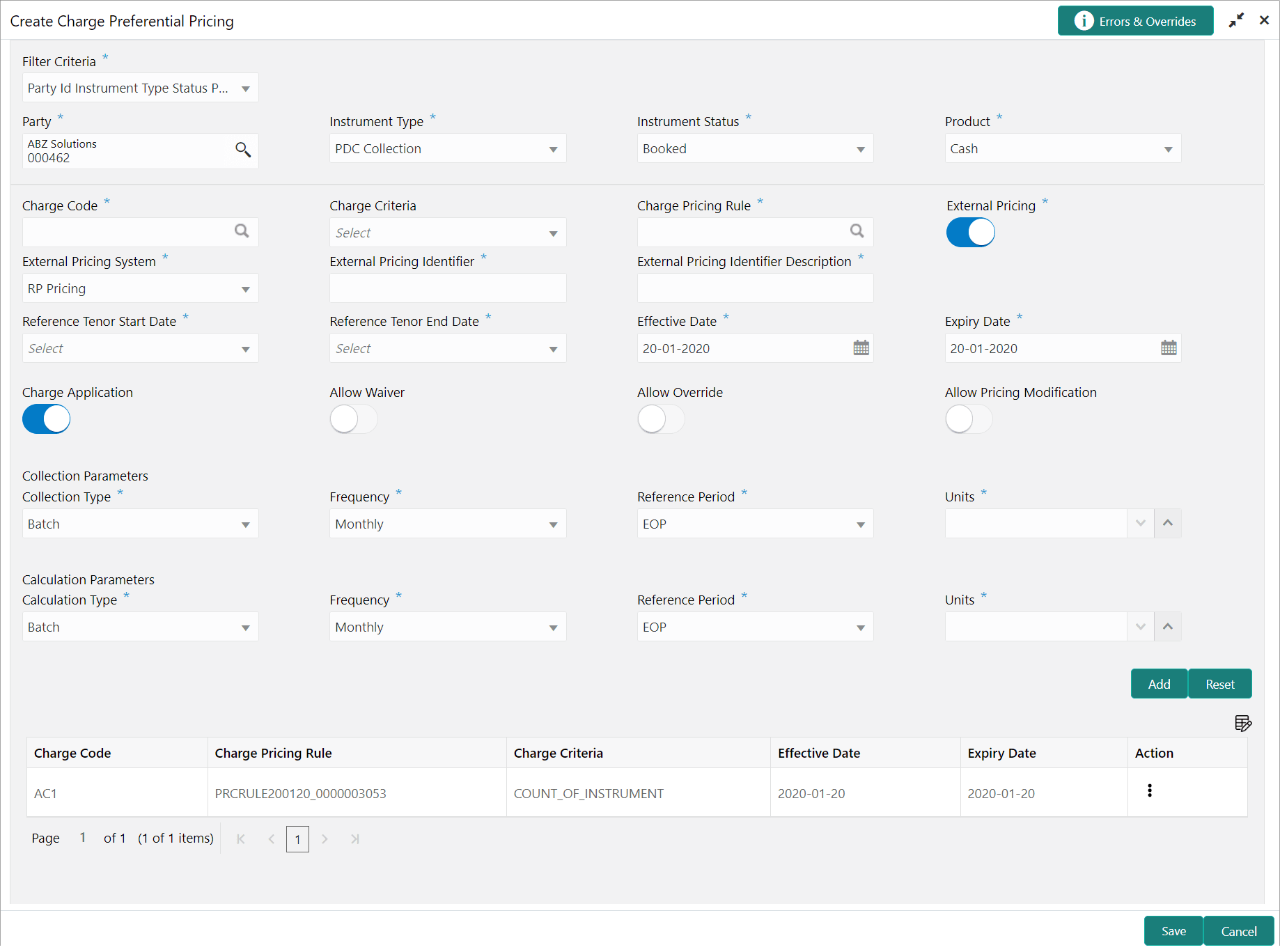

- Under Charges, click Charge Preferential Pricing. Under Charge Preferential Pricing, click Create Charge Preferential Pricing.The Create Charge Preferential Pricing screen displays.
Figure 3-36 Create Charge Preferential Pricing
- Specify the fields on Create Charge Preferential Pricing screen.For more information on fields, refer to the field description table.
The fields, which are marked with an asterisk, are mandatory.Table 3-15 Create Charge Preferential Pricing - Field Description

Charges Grid Displays the details of the preferential pricing added as an entry in this grid. - Click Add to add the details to the grid.
- Click
icon in the Action column to edit or delete the row. - Click
icon to add other columns to the grid.
- Click
- Click Reset to reset the rows in the grid.
- Click Save to save the record and send it for authorization.
