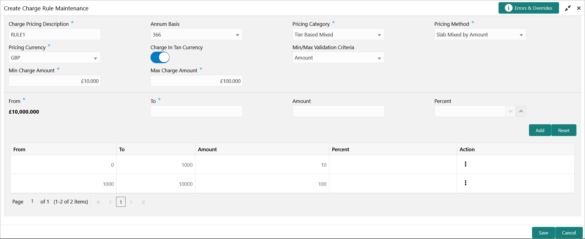

 - Under Charges, click Charge Rule Maintenance. Under Charge Rule Maintenance, click Create Charge Rule Maintenance.The Create Charge Rule Maintenance screen displays.
Figure 3-29 Create Charge Rule Maintenance
 - Specify the fields on Create Charge Rule Maintenance screen.For more information on fields, refer to the field description table.
The fields, which are marked with an asterisk, are mandatory.Table 3-13 Create Charge Rule Maintenance - Field Description
Field Description Charge Pricing Description Specify the pricing description of charge. Annum Basis Select the number of days to be considered in a year for tenor-based calculations. Pricing Category Select the pricing category. Based on the selected category, pricing methods will be loaded. Pricing Method Select the method to configure the charge pricing. Pricing Currency Select the currency in which pricing is to be done. Charge in Txn Currency Switch the toggle ON if the charge should be levied in transaction currency otherwise charge will get levied in pricing currency. Min/Max Validation Criteria Specify whether the charges should be applied based on the range of amount or percentage. Min. Charge Amount/Percent Specify the minimum charge amount/ percentage to be considered. This field is displayed based on the value selected in the Min/Max Validation Criteria field.

 - Click Add to add the charge rule details to the grid.
- Select the record in the grid and then click
 icon in the Action column. - Click Edit to edit the selected row.
 - Click Delete to delete the selected row.
 - Click Reset to reset the fields, if required.
 - Click Save to save the record and send it for authorization.
