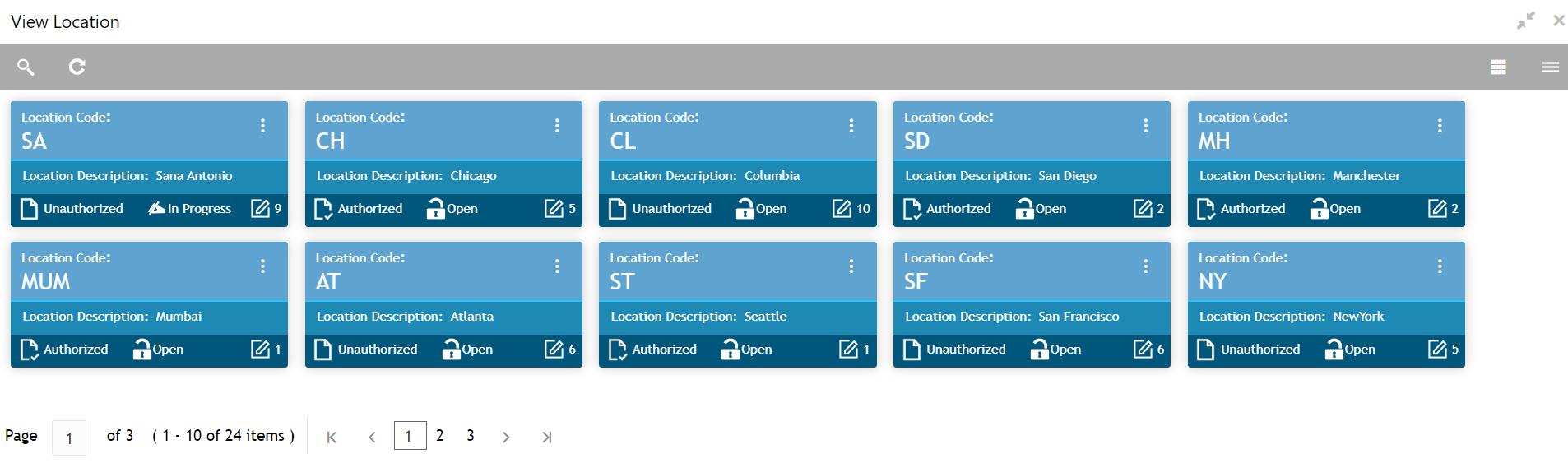

A tile is present for each record that has been created. The bottom portion of each record-tile displays the following:
  • The status, whether Authorized, Unauthorized, or Rejected
  • Open or Closed
  • The number of times the record has been submitted by the Maker added.
Specify User ID and Password, and login to Home screen.
  1. On Home screen, click Cash Management. Under Cash Management, click Collections.
  2. Under Collections, click Maintenance. Under Maintenance, click Location.
  3. Under Location, click View Location.
    The View Location screen displays.

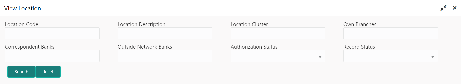

  4. Filter the records in the View screen:
    1. Click Search icon to view the filters.
      The View Location - Search screen displays.
      Figure 3-50 View Location - Search
      The user can filter the records using the following parameters:
      • Location Code
      • Location Description
      • Location Cluster
      • Correspondent Banks
      • Outside Network Banks
      • Authorization Status
      • Record Status
    2. Select the required filter criteria and click Search to filter the records.
    3. Click Reset to reset the filter criteria.
