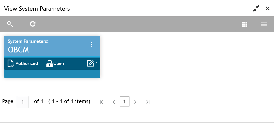

  1. On Home screen, click Cash Management. Under Cash Management, click System Parameters.
  2. Under System Parameters, click View System Parameters.
    The View System Parameters screen displays.
    Figure 2-1 View System Parameters
  3. Filter the records in the View screen:

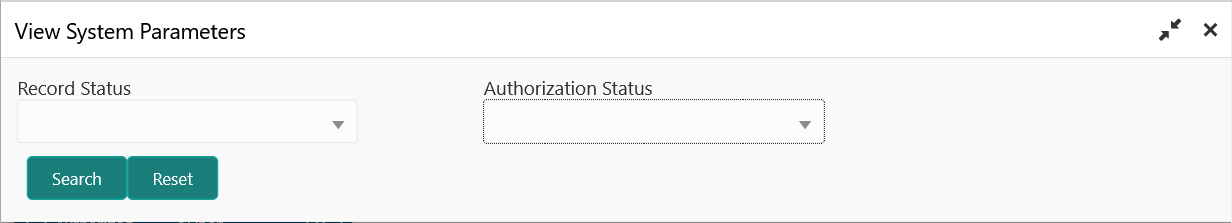

    1. Click Search icon to view the filters.
      The View System Parameters - Search screen displays.
      Figure 2-2 View System Parameters - Search
      The user can filter the records using the following parameters:
      • Record Status
      • Authorization Status
    2. Select the required filter criteria and click Search to filter the records.
    3. Click Reset to reset the filter criteria.
  4. Click Refresh icon to refresh the records.

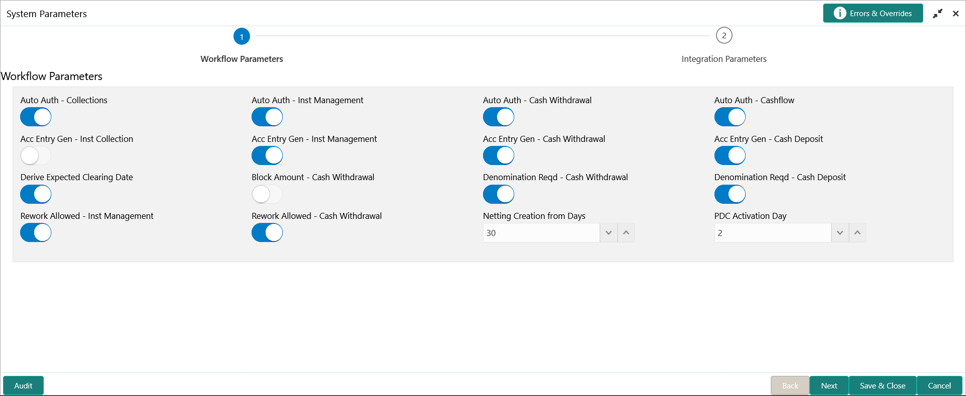

  5. Click Options icon and select Unlock to modify the records.
    The System Parameters - Workflow Parameters screen displays.
    Figure 2-3 System Parameters - Workflow Parameters
  6. On Workflow Parameters tab, select the toggles to configure the workflow parameters.
    Table 2-1 Workflow Parameters - Field Description
    Field Description
    Auto Auth - Collections Select the toggle switch to enable or disable the auto authorization of the instrument collections.
    Auto Auth - Inst Management Select the toggle switch to enable or disable the auto authorization of all the actions performed by the maker in Instrument Management.
    Auto Auth - Cash Withdrawal Select the toggle switch to enable or disable the auto authorization of the cash withdrawal.
    Auto Auth - Cashflow Select the toggle switch to enable or disable the auto authorization of the cash flow transactions.
    Acc Entry Gen - Inst Collection Select the toggle switch to enable or disable the generation of accounting entries through the Instrument Management/Instrument Collection workflow.
    Acc Entry Gen - Inst Management Select the toggle switch to enable or disable the generation of accounting entries through the Instrument Management workflow when the Instrument Status is marked as Realized or Return.
    Acc Entry Gen - Cash Withdrawal Select the toggle switch to enable or disable the generation of accounting entries through the Cash Withdrawal workflow.
    Acc Entry Gen - Cash Deposit Select the toggle switch to enable or disable the generation of accounting entries through the Cash Deposit workflow.
    Derive Expected Clearing Date Select the toggle switch to enable or disable the derivation of the expected clearing date for an instrument sent for clearing.
    Block Amount - Cash Withdrawal Select the toggle switch to enable or disable whether the request has to be sent to the core system for blocking/earn marking the Cash Withdrawal amount.
    Denomination Reqd - Cash Withdrawal Select the toggle switch to enable or disable whether the denomination section to be mandatory/non-mandatory in Cash Withdrawal screen.
    Denomination Reqd - Cash Deposit Select the toggle switch to enable or disable whether the denomination section to be mandatory/non-mandatory in Cash Deposit screen.
    Rework Allowed - Inst Management Select the toggle switch to enable or disable the rework for the rejected instruments in Instrument Management.
    Rework Allowed - Cash Withdrawal Select the toggle switch to enable or disable the rework for the rejected Cash Withdrawal transactions.
    Netting Creation from Days Specify the number of days prior to the Current Business Date from when the netting transactions has to be fetched.
    PDC Activation Day Specify the number of days prior to the instrument date to activate the Post Dated Cheque for processing.
  7. Click Next button.

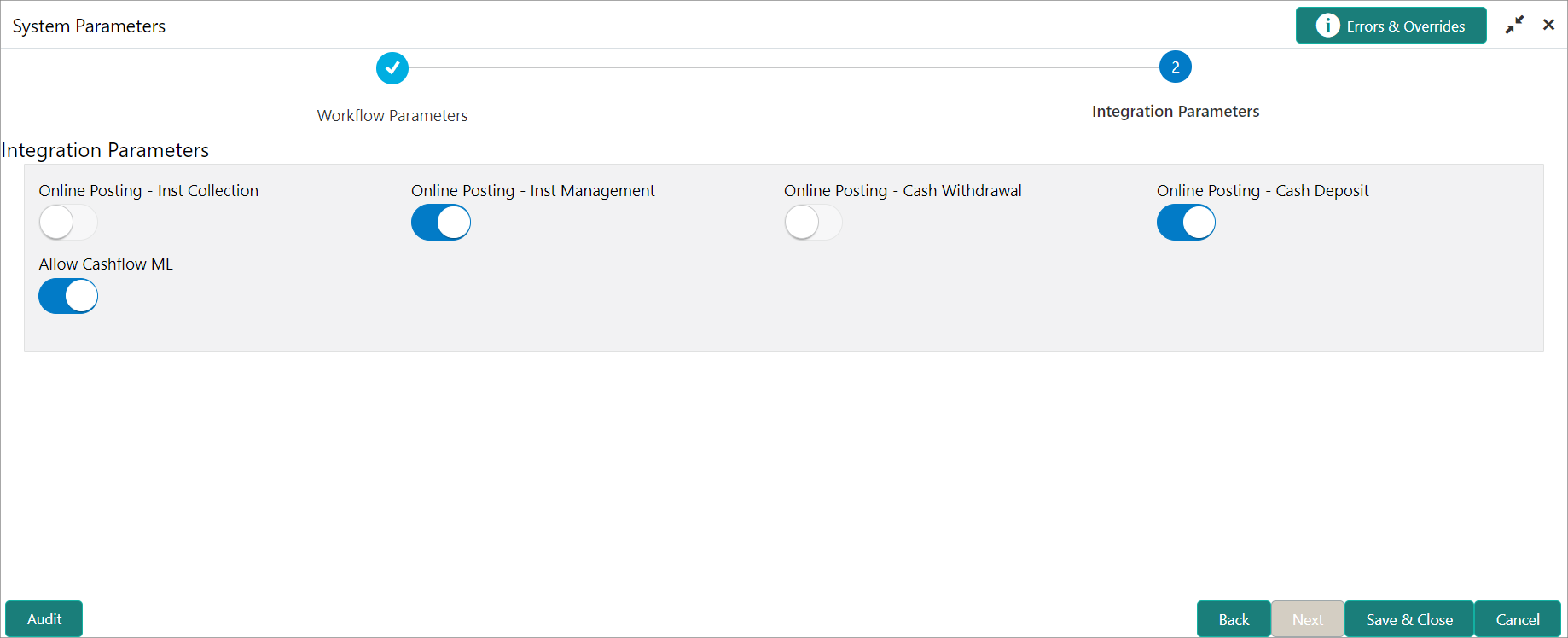

    The System Parameters - Integration Parameters screen displays.
    Figure 2-4 System Parameters - Integration Parameters
  8. On Integration Parameters tab, select the toggles to configure the integration parameters.
    Table 2-2 Integration Parameters - Field Description
    Field Description
    Online Posting - Inst Collection Select the toggle switch to enable or disable the online posting of the financial transactions related to the Instrument Collection/Instrument Management in accounting system.
    Online Posting - Inst Management Select the toggle switch to enable or disable the online posting of the financial transactions related to the Instrument Management in accounting system when the Instrument Status is marked as Realized or Return.
    Online Posting - Cash Withdrawal Select the toggle switch to enable or disable the online posting of the financial transactions related to the Cash Withdrawal in accounting system.
    Online Posting - Cash Deposit Select the toggle switch to enable or disable the online posting of the financial transactions related to the Cash Deposits in accounting system.
    Allow Cashflow ML Select the toggle switch to enable or disable the population of cashflow based on AI/Machine learning.
