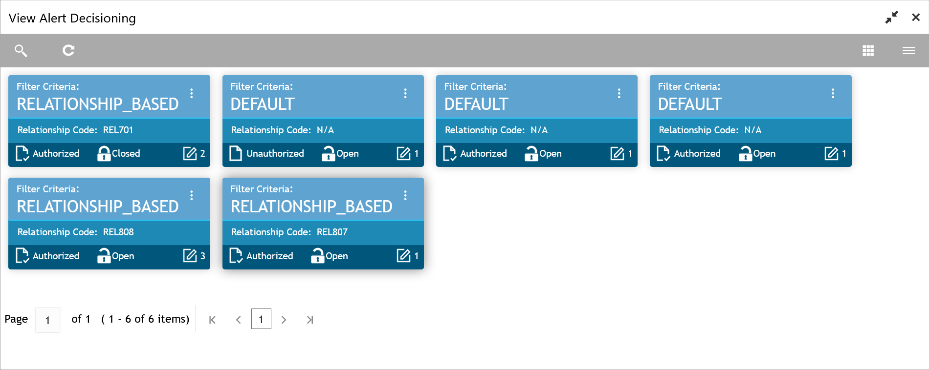

A tile is present for each record that has been created. The bottom portion of each record-tile displays the following:
  • The status, whether Authorized, Unauthorized, or Rejected
  • Open or Closed
  • The number of times the record has been submitted by the Maker added.

  3. Under Alerts, click Alert Decisioning. Under Alert Decisioning, click View Alert Decisioning.
    The View Alert Decisioning screen displays.
    Figure 3-73 View Alert Decisioning

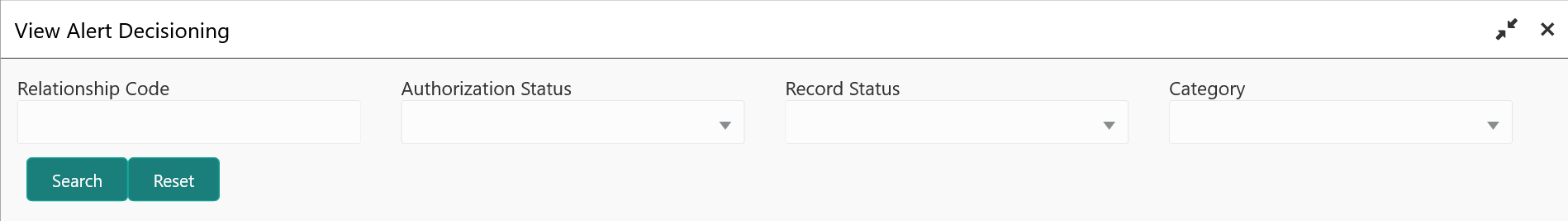

  4. Filter the records in the View screen:
    1. Click Search icon to view the filters.
      The View Alert Decisioning - Search screen displays.
      Figure 3-74 View Alert Decisioning - Search
      The user can filter the records using the following parameters:
      • Relationship Code
      • Authorization Status
      • Record Status
      • Category
    2. Select the required filter criteria and click Search button to filter the records.
    3. Click Reset to reset the filter criteria.
