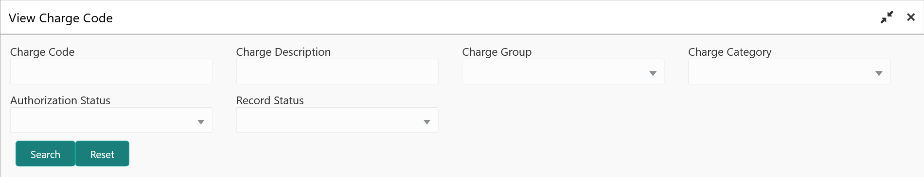

  4. Filter the records in the View screen:
    1. Click Search icon to view the filters.
      The View Charge Code - Search screen displays.
      Figure 3-18 View Charge Code - Search
      The user can filter the records using the following parameters:
      • Charge Code
      • Charge Description
      • Charge Group
      • Charge Category
      • Authorization Status
      • Record Status
    2. Select the required filter criteria and click Search button to filter the records.
    3. Click Reset to reset the filter criteria.
