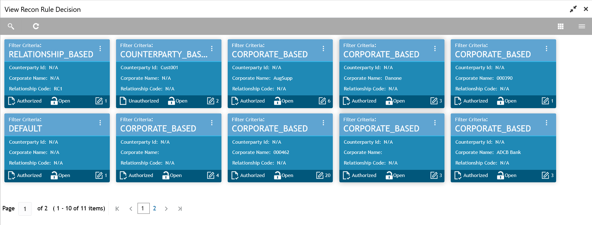

    The View Recon Rule Decision screen displays.
    Figure 3-48 View Recon Rule Decision
  4. Filter the records in the View screen:
    1. Click Search icon to view the filters.
      The View Recon Rule Decision - Search screen displays.
      Figure 3-49 View Recon Rule Decision - Search
      The user can filter the records using the following parameters:
      • Corporate Name
      • Counterparty Id
      • Relationship Code
      • Authorization Status
      • Record Status
    2. Select the required filter criteria and click Search button to filter the records.
    3. Click Reset to reset the filter criteria.
