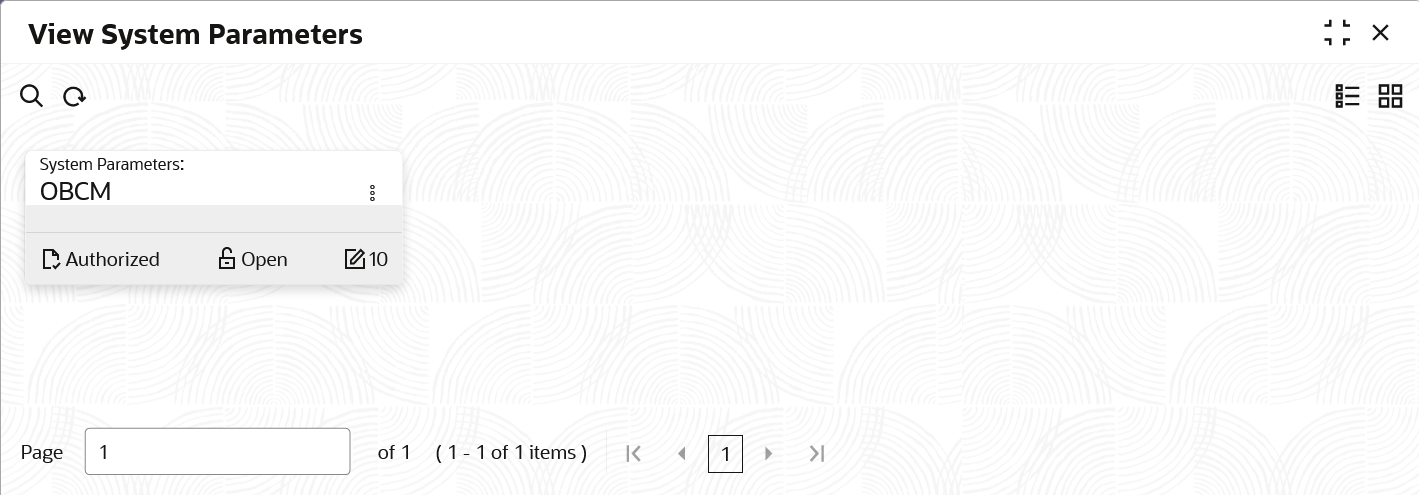

This topic describes the systematic instruction to view, modify, or authorize the day zero system parameters for Oracle® Banking Cash Management.
A tile is present for each record that has been created. The bottom
portion of each record-tile displays the following:
- The status, whether Authorized, Unauthorized, or Rejected
- Open or Closed
- The number of times the record has been submitted by the Maker added.
Specify User ID and Password, and login to Home screen.
- On Home screen, click Cash Management. Under Cash Management, click System Parameters.
- Under System Parameters, click View System Parameters.The View System Parameters screen displays.
- Filter the records in the View screen:
- Click Search icon to view the filters. The user can filter the records by Authorization Status and Record Status.
- Select the required filter criteria and click Search to filter the records.
- Click Reset to reset the filter criteria.
- Click Refresh icon to refresh the records.
- Click Options icon and select Unlock to modify the records.The System Parameters - Workflow Parameters screen displays.

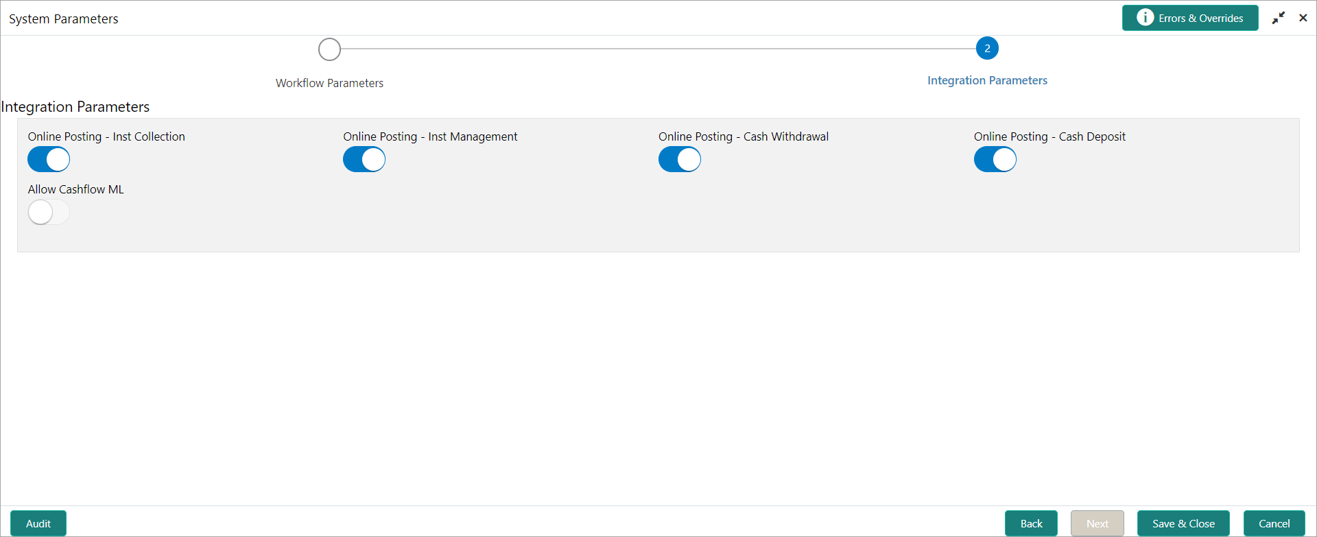

Figure 2-3 System Parameters - Integration Parameters
- On Integration Parameters tab, select the toggles to configure the integration parameters.For more information on fields, refer to the field description table.
Table 2-2 Integration Parameters - Field Description
Field Description Online Posting - Inst Collection Select the toggle switch to enable or disable the online posting of the financial transactions related to the Instrument Collection/Instrument Management in accounting system. Online Posting - Inst Management Select the toggle switch to enable or disable the online posting of the financial transactions related to the Instrument Management in accounting system when the Instrument Status is marked as Realized or Return. Online Posting - Cash Withdrawal Select the toggle switch to enable or disable the online posting of the financial transactions related to the Cash Withdrawal in accounting system. Online Posting - Cash Deposit Select the toggle switch to enable or disable the online posting of the financial transactions related to the Cash Deposits in accounting system. Allow Cashflow ML Select the toggle switch to enable or disable the population of cashflow based on AI/Machine learning. - Click Options icon and then select any of the following options:
