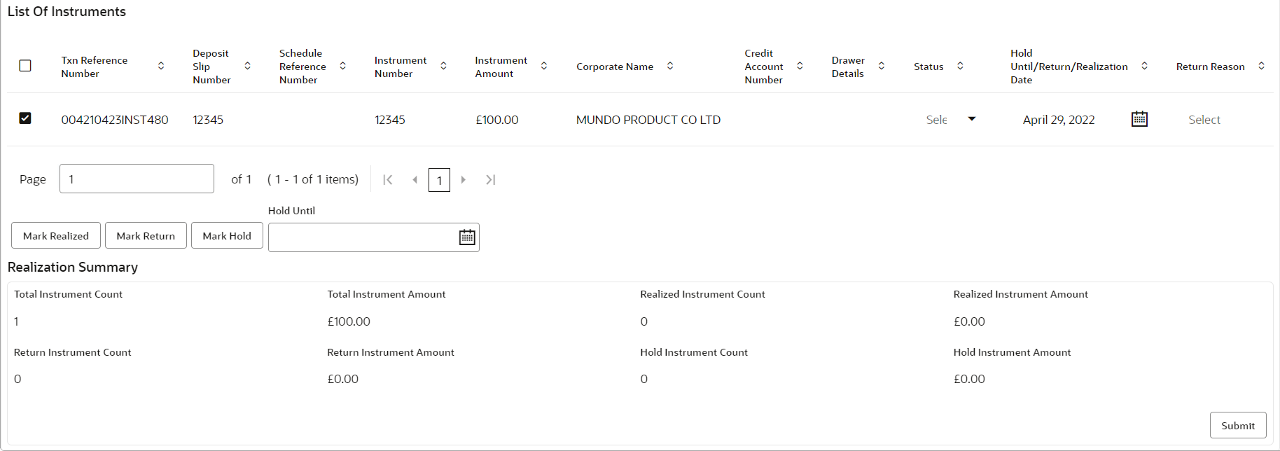

- Select the records for which the status needs to be updated.
- Perform any one of the following actions to change the instrument status:
- Click Mark Realized, if the instrument is cleared.
- Click Mark Return, if the instrument is returned.
- Click Mark Hold, to hold the instrument and in the Hold Until field, click the calendar icon to select the date until which the instrument should be on-hold.
- Click Submit to update the instrument status and send it for authorization.
