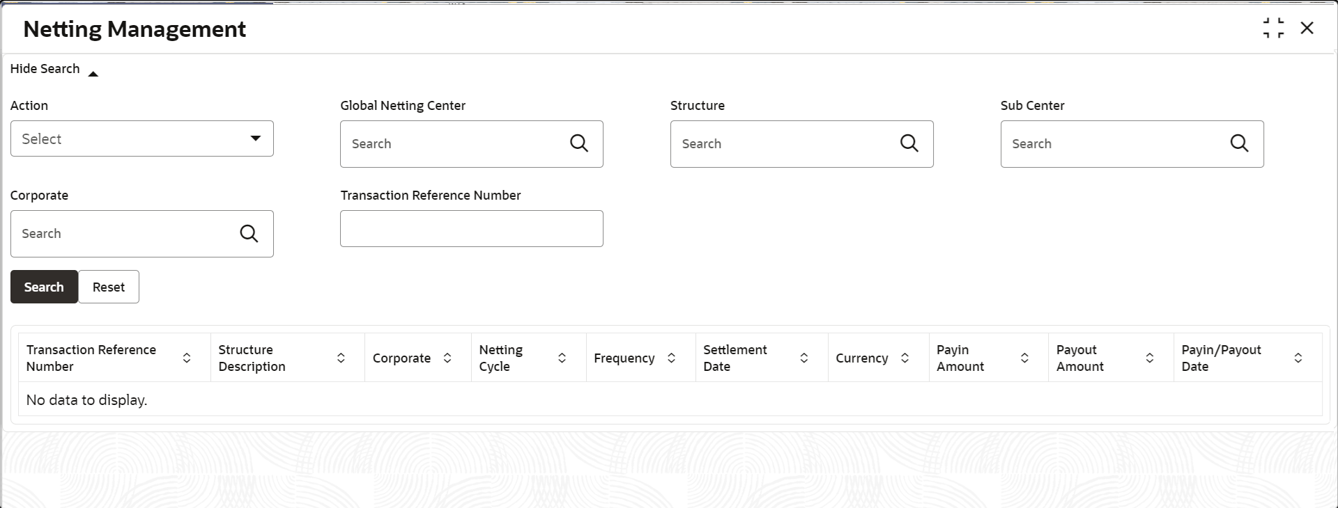

- On Home screen, click Cash Management. Under Cash Management, click Netting.
- Under Netting, click Netting Management.The Netting Management screen displays.
- Specify the fields on the Netting Management screen to search, and view the Netting transaction records.For more information on fields, refer to the field description table.
The fields marked as Required are mandatory.Table 3-1 Netting Management - Field Description
Field Description Action Select the action whether the netting transaction has to be accepted/rejected. The options are:- Accept Netting Transaction
- Reject Netting Transaction
- Payout - Corporate to Sub Center
- Payout - Corporate to Global Netting Center
- Payout - Sub Center to Global Netting Center
- Payout - Sub Center to Corporate
- Payout - Global Netting Center to Sub Center
- Payout - Global Netting Center to Corporate
Global Netting Center Click the Search icon to view and select the Global Netting Center for which the netting transactions have to be filtered. Structure Click the Search icon to view and select the Netting Structure for netting transactions filtering. Sub Center Click the Search icon to view and select the Sub Center for the netting transactions filtering. Corporate Click the Search icon to view and select the corporate details for netting transactions filtering. Transaction Reference Number Specify the transaction reference number of the netting transaction for filter purposes. - Click Search to view the search results.The Netting Management - Search Results screen displays.For more information on fields, refer to the field description table.

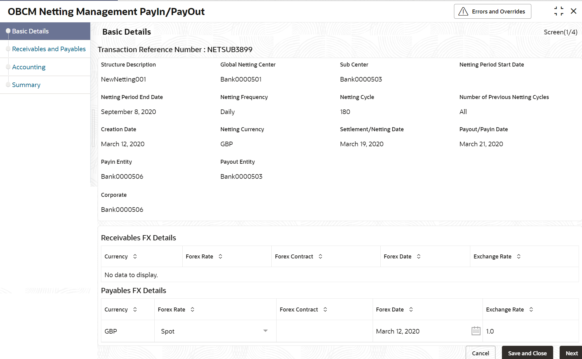

Basic Details:
This data segment provides the basic details about the netting transaction.
- Click on the hyperlink in the Transaction Reference Number column to view more details of the record.The Netting Management - Basic Details data segment screen displays.
Figure 3-3 Netting Management - Basic Details
- Modify the foreign exchange rate if required for net payin/payout
calculation.For more information on fields, refer to the field description table.
The fields marked as Required are mandatory.Table 3-3 Netting Management - Basic Details - Field Description

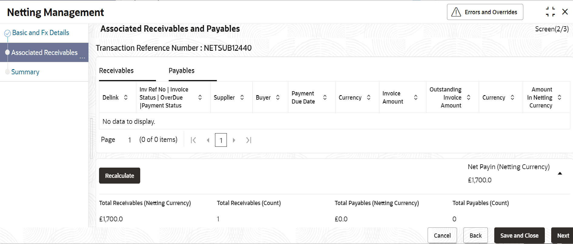

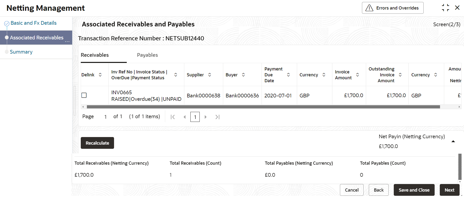

The user can view the receivables and payables details associated with the netting transaction in this data segment. The user can delink the invoices and application recalculates the total receivables and payables (Count, Amount and Net Payin/Payout)
- Click Next button in the Basic Details data segment.If the Action field is selected as Accept/Reject,The Netting Management - Receivables - Accept/Reject data segment screen displays.

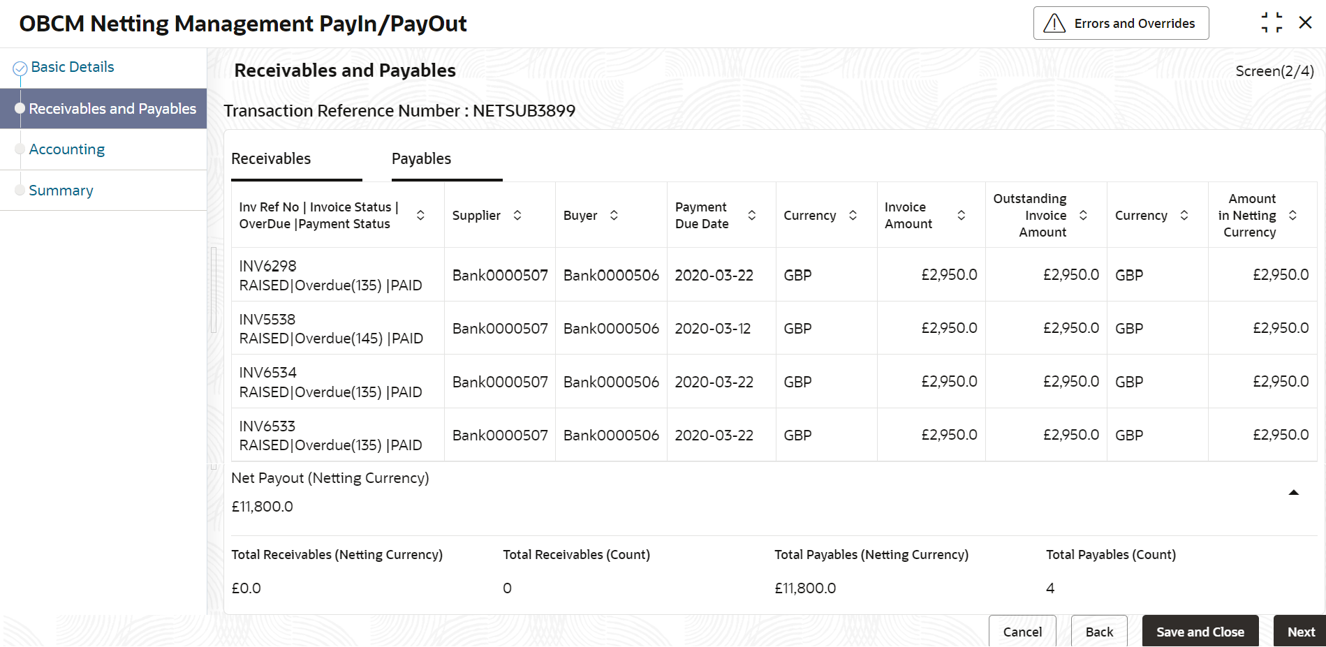

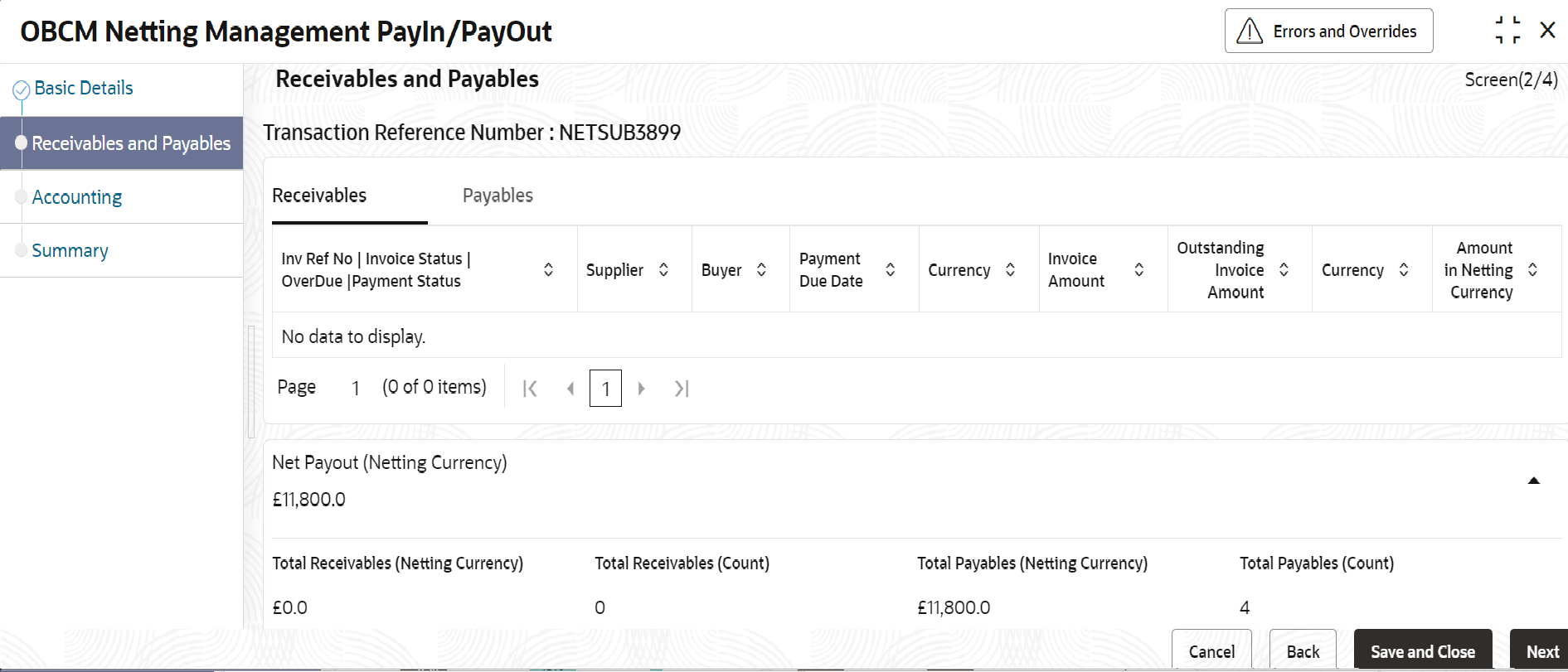

If the Action field is selected as Payout,
The Netting Management - Receivables - Payout data segment screen displays.Figure 3-5 Netting Management - Receivables - Payout
- Click Payables tab to view the payables associated with the netting transaction.If the Action field is selected as Accept/Reject,The Netting Management - Payables - Accept/Reject data segment screen displays.
Figure 3-6 Netting Management - Payables - Accept/Reject
The Netting Management - Payables - Payout data segment screen displays.Figure 3-7 Netting Management - Payables - Payout
- Perform the following steps to delink the invoices and recalculate the total receivables and payables (Count, Amount and Net Payin/Payout).
This option is applicable for the Accept/Reject action.- Select the checkbox in the Delink column under the Receivables and Payables tab to delink the respective invoices from the netting transaction.
- Click Recalculate button to recalculate the net receivables and payables.

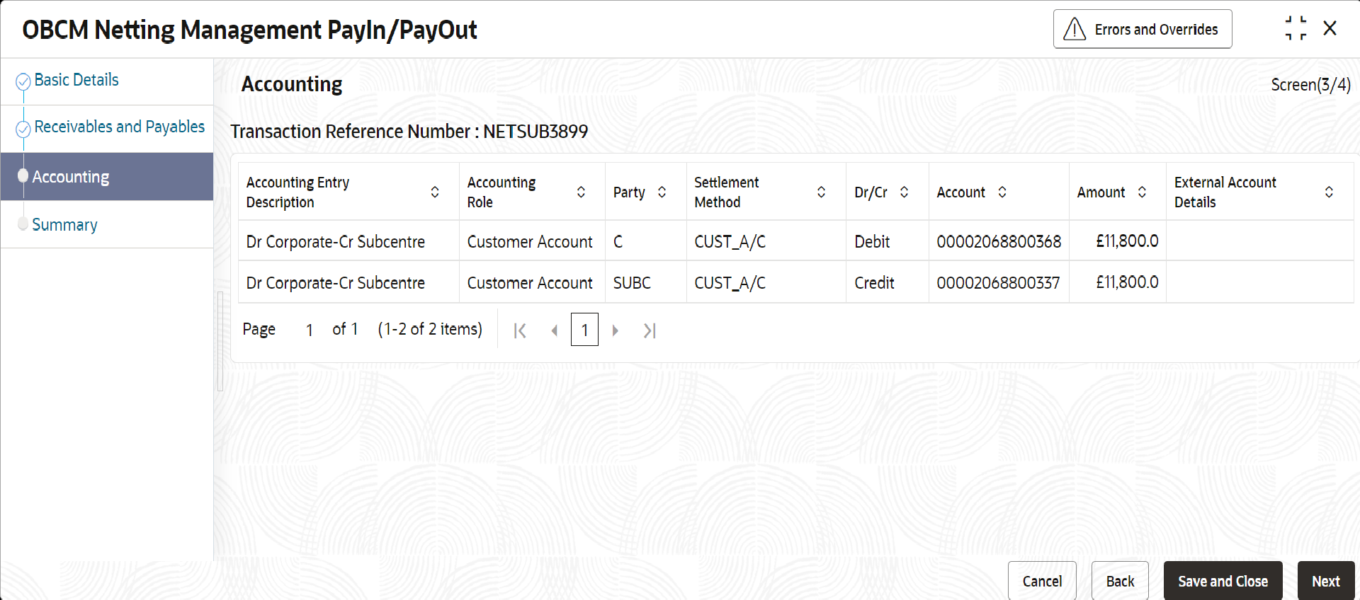

Accounting:This data segment provides the accounting details associated with the netting transaction.
- Click Next button in Receivables and Payables data segment.The Netting Management - Accounting data segment screen displays.
Figure 3-8 Netting Management - Accounting

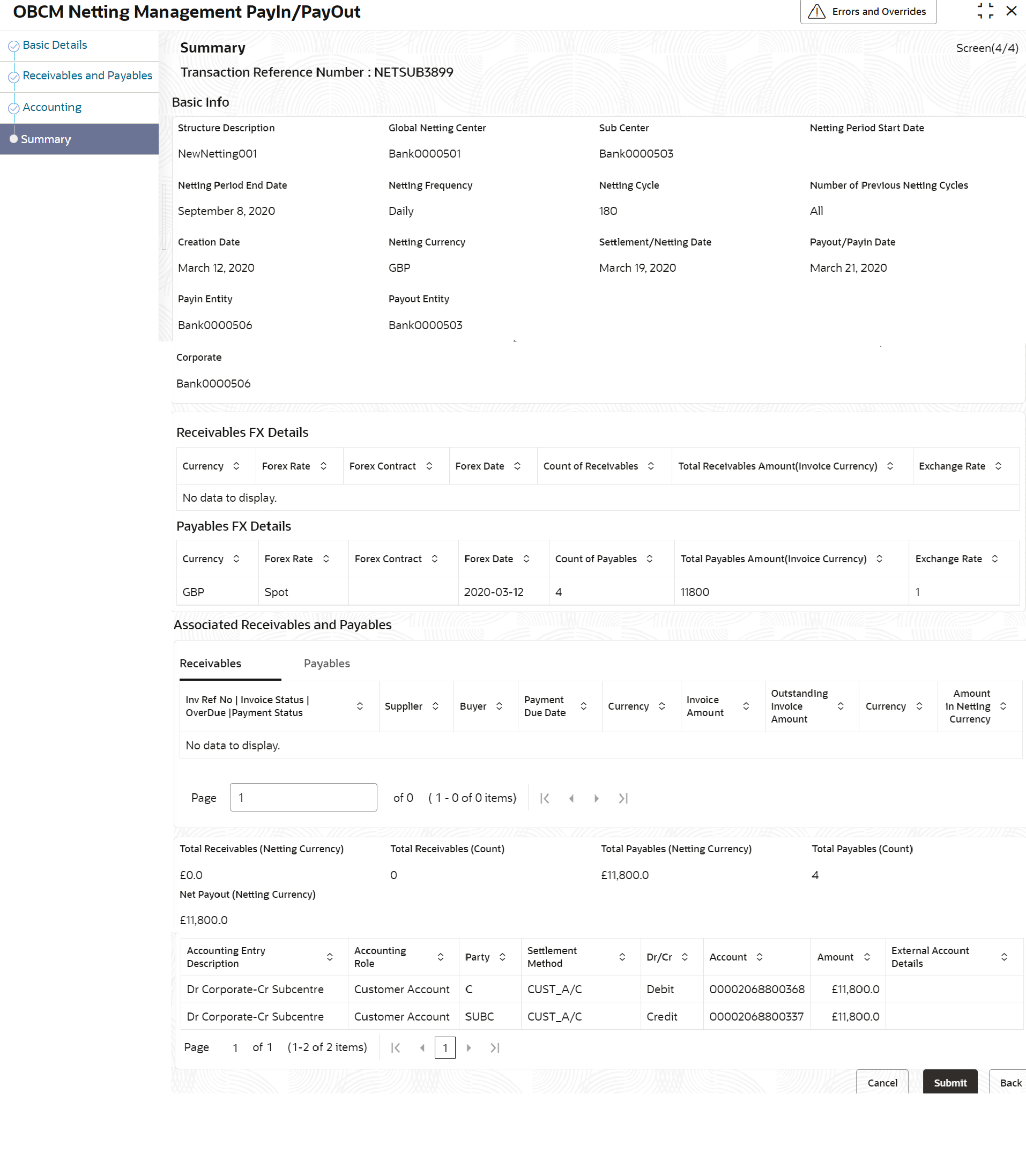

Summary:
The user can view the basic details, receivables and payables of netting transaction in this data segment.
- Click Next button in Receivables and Payables/Accounting data segment.The Netting Management - Summary data segment screen displays.
- Perform any one of the following actions:
- Click Submit button to accept/reject the netting transaction.
- Click Back button to navigate to the previous data segment.
- Click Cancel button to discard the changes and close the record.
