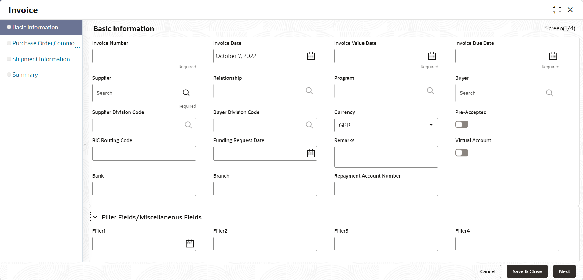

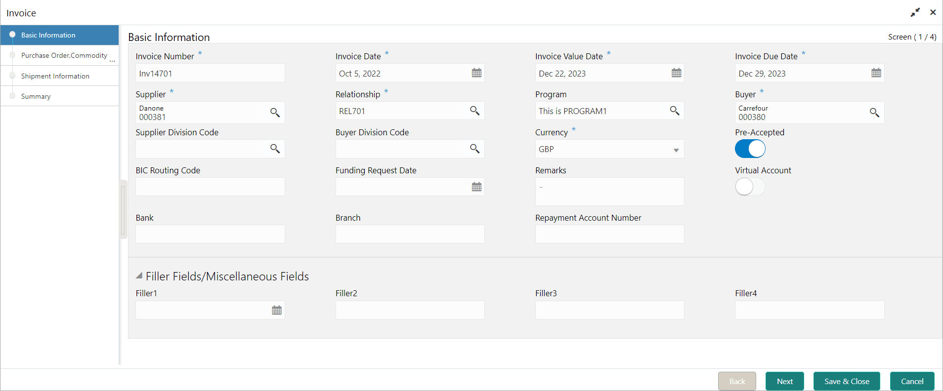

Basic Information
- Click Proceed to view the screen for populating the invoice details.The Invoice - Basic Information screen displays.
- Specify the fields on Basic Information screen.For more information on fields, refer to the field description table.
The fields marked as Required are mandatory.Table 4-2 Basic Information - Field Description
Field Description Invoice Number Specify the unique reference number for invoice to be created. OR
Click the Search icon to select the existing invoice number.
This field cannot be modified once authorized.
Invoice Date Click the Calendar icon and select the date of invoice creation. By default, the system’s current date is set. Invoice Value Date Click the Calendar icon and select the invoice value date. This date may be different from the invoice date. Invoice Due Date Click the Calendar icon and select the date by when the invoice is due. Supplier Click the Search icon and select the supplier of the goods/commodity. This field cannot be modified once authorized.
Relationship Click the Search icon and select the relationship of the selected supplier under which this invoice should be created. This field cannot be modified once authorized.
Program Click the Search icon and select the required program under which the invoice should be created. This field is applicable to only OBSCF system.
Buyer Click the Search icon and select the buyer to create the invoice for. This field cannot be modified once authorized.
Supplier Division Code Click the Search icon and select the division code of the supplier. Buyer Division Code Click the Search icon and select the division code of the buyer. Currency Select the currency of the invoice. Pre-Accepted Switch the toggle ON if the invoice is pre-accepted by the buyer. BIC Routing Code Specify the BIC or SWIFT code of the financial institution, to send the payment amount to. Funding Request Date Click the calendar icon and select the date on which funding for the invoice is requested. This date can be greater than or lesser than the system’s current date. Note:
The Funding Request Date can be lesser than the system's current date only if the Allow Back-Dated Disbursement toggle is enabled in the System Parameters, Product Parameters, or Program Parameters.Remarks Specify the comments regarding the invoice, if any. Virtual Account Switch the toggle ON, if the repayment account is a virtual one. Bank Specify the bank name of the repayment account. Branch Specify the branch name of the repayment account. Repayment Account Number Specify the account number to send the repayment amount to. Filler Fields/Miscellaneous Fields Specify the desired values in the filler fields. The bank can configure these fields on Day Zero based on their requirement. - Perform any of the below action from the Basic Information screen.

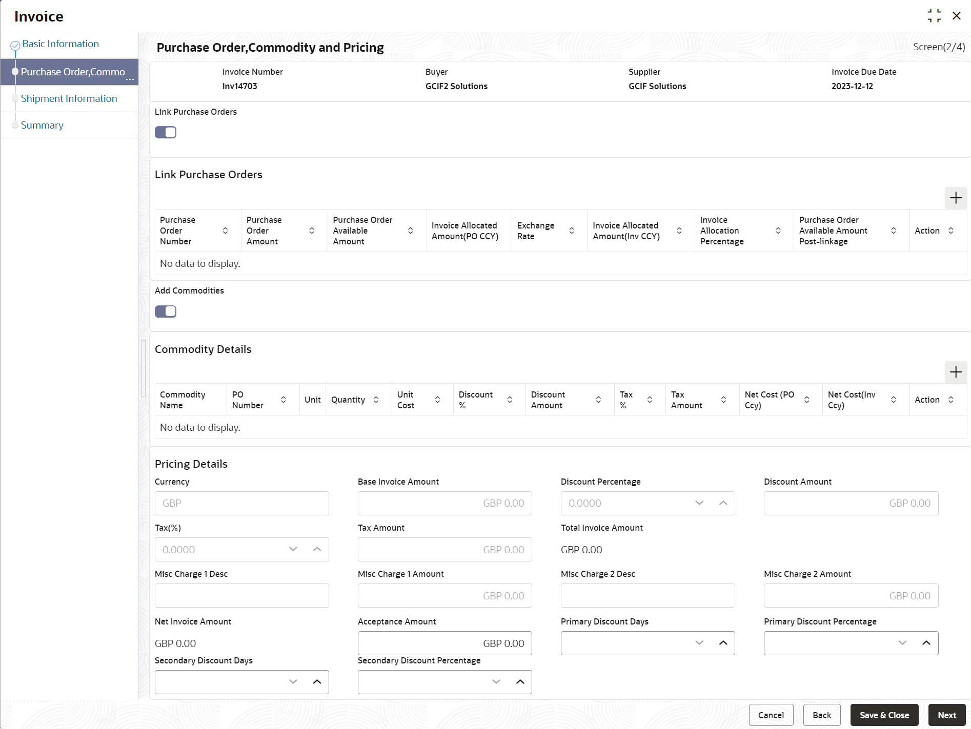

- Click Next on Basic Information tab.The Invoice - Commodity and Pricing screen displays.For more information on fields, refer to the field description table.
Figure 4-3 Invoice - Purchase Order, Commodity and Pricing
Table 4-3 Purchase Order, Commodity and Pricing - Field Description
Field Description Invoice Number Displays the reference number of the invoice. Buyer Displays the name of the buyer. Supplier Displays the name of the supplier. Invoice Due Date Displays the date when the invoice is due. - Switch the Link Purchase Orders toggle ON to link one or more purchase orders to the invoice.

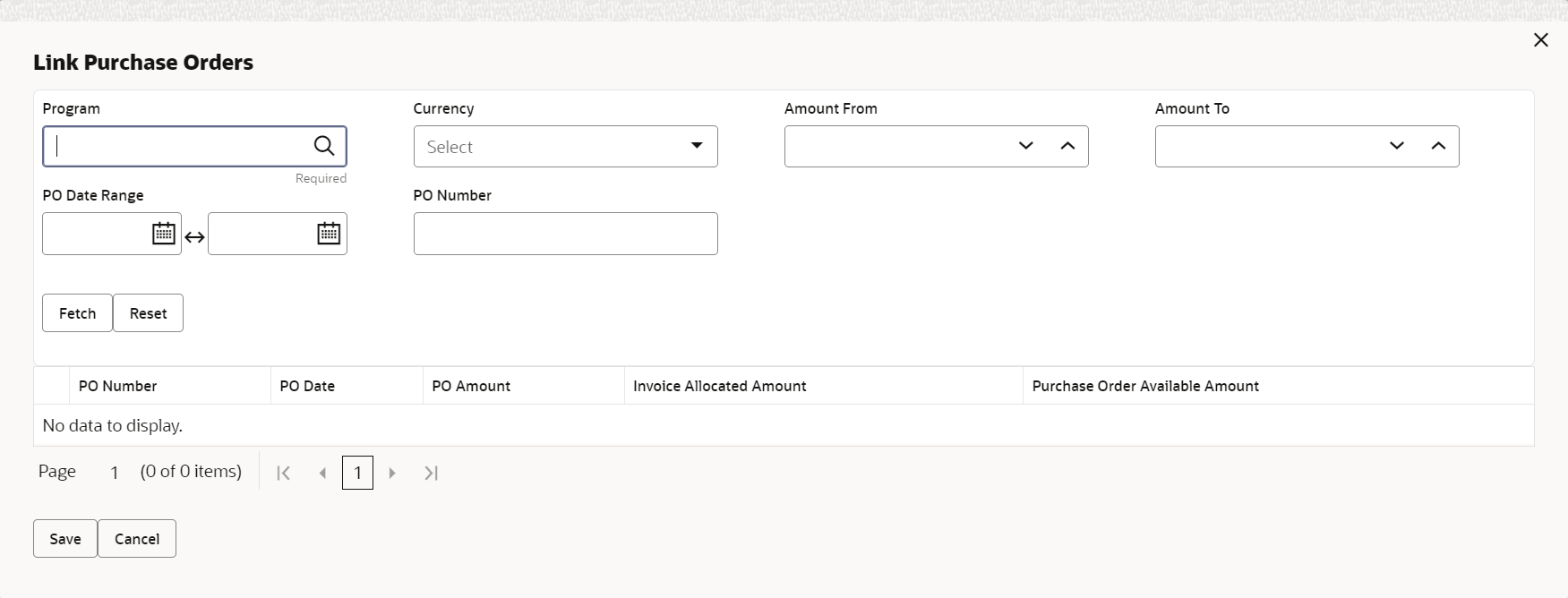

- In the Link Purchase Orders section, click Add icon to link one or more purchase orders to the invoice.The Link Purchase Orders screen displays.
- On the Link Purchase Orders screen, specify the required search criteria and click Fetch.The relevant purchase order records are displayed.
- Select the records and click Save to link the purchase orders to the invoice.The Link Purchase Orders section displays with the linked purchase orders.For more information on fields, refer to the field description table.

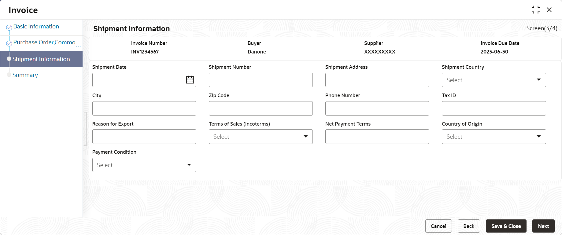

Shipment Information
- Click Next on Commodity and Pricing tab.The Invoice - Shipment Information screen displays.
- Specify the fields on Shipment Information screen.For more information on fields, refer to the field description table.
The fields marked as Required are mandatory.Table 4-7 Shipment Information - Field Description
Field Description Invoice Number Displays the reference number of the invoice. Buyer Displays the name of the buyer. Supplier Displays the name of the supplier. Invoice Due Date Displays the date when the invoice is due. Shipment Date Click the Calendar icon and select the date on which the buyer expects commodity to get dispatched. Shipment Number Specify the unique shipment number to track the shipment. Shipment Address Specify the complete address where shipment should be sent. Shipment Country Select the country to send the shipment to. City Select the city to send the shipment to. Zip Code Specify the postal code to send the shipment to. Phone Number Specify the contact number of the shipment company. Tax Id Specify the unique tax id if shipment charge includes tax amount. Reason for Export Specify the reason for exporting the shipment. Terms of Sale(Incoterms) Select any of the following terms of sales: - DAF – Delivered At Frontier

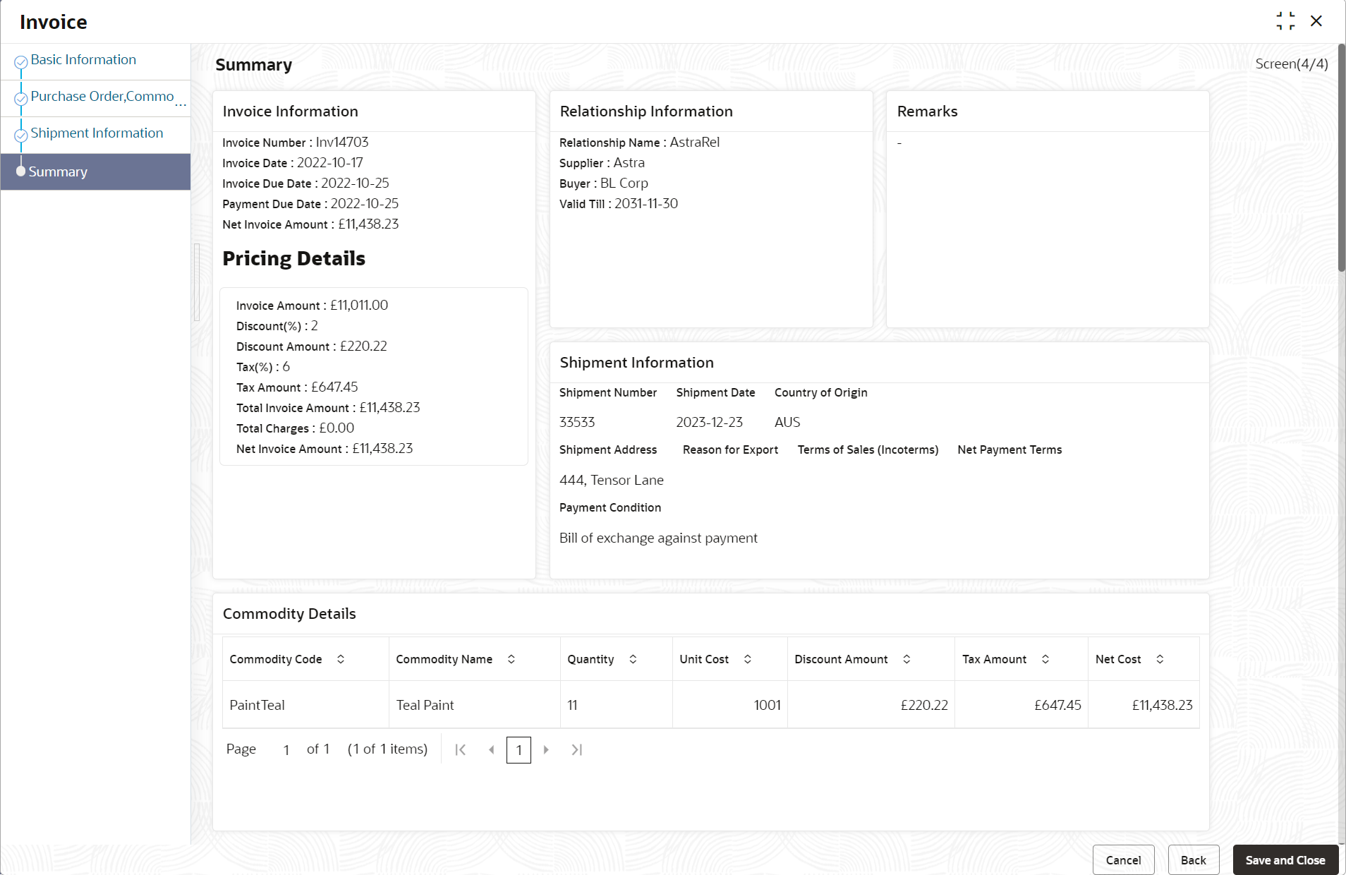

Summary
- Click Next on Shipment Information tab.The Invoice - Summary screen displays.
- Review the detail of the invoice being created and perform any of the following action from the Summary screen.
- Click Save and Close to save the invoice details and submit it for authorization.
- Click Back to go to the Shipment Information screen.
- Click Cancel to cancel the creation of the invoice.
