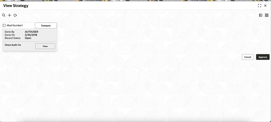

  1. Navigate to Summary screen.
  2. Click Action icon icon on the unauthorized record which needs to be authorized.
  3. Click Authorize.
    The Authorization screen displays.
  4. Click View to view the record.
    If the Enforce View before Authorize toggle is enabled in External Bank Parameter Maintenance screen, the user must view the record before approving or rejecting.
  5. Click Cancel to cancel the authorization of the record.
  6. Select the required modification number that must be approved/rejected.
    • If the lower modification has to be rejected, all the higher modifications (if any) must also be rejected.
    • If the higher modification has to be approved, all the lower modifications (if any) must also be approved.
