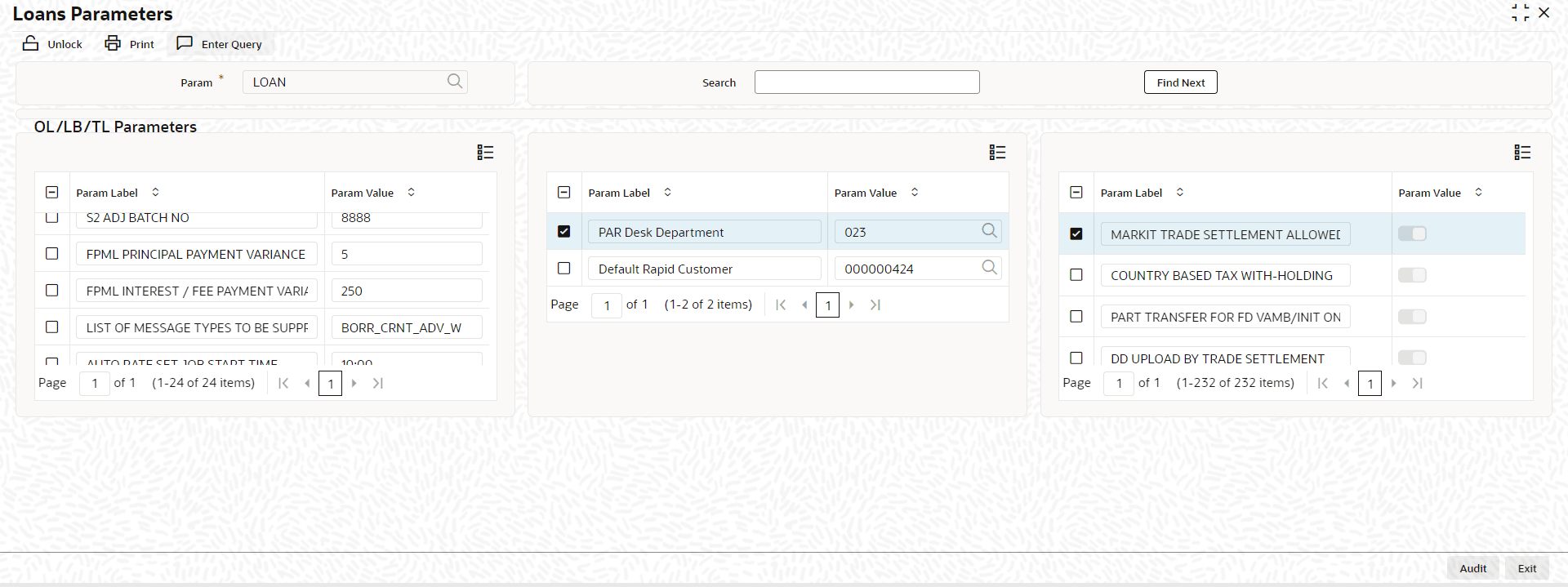

You can maintain the generic parameters related to Loans, Loan Syndication and Secondary Loan Trading using
Loan parameter screen.
Specify the User ID and Password, and login to Homepage.
  1. On the homepage, type OLDLNPRM and click next arrow.
    The Loan parameter screen sceen is displayed.
    Figure 11-2 Loan parameter screen
  2. Through this screen you can view details of the following:

      Table 11-3 Maintenance and processing functionality of negative rates
      Allow Negative Rate Processing Disallow Negative Base Rate Processing Screen functionality
      Selected Not Selected Both Base Rate and Margin rate can be in negative.
      All in rate will be 0 if Base Rate + Margin is negative, in LS module
      All in rate will be 0 if Base Rate + Spread is negative, in LD module
      Selected Not Selected If Base Rate is negative, then base rate will be considered as 0.
      Margin can be negative.
      All in rate will be 0 if Base Rate + Margin is negative, in LS module.
      All in rate will be 0 if Base Rate + Spread is negative, in LD module.
      Not Selected NA Below listed existing functionalities will continue to work.
      Both Base Rate and Margin should be positive in LS module.
      Both Base Rate and Spread should be 2-32 positive in LD module
