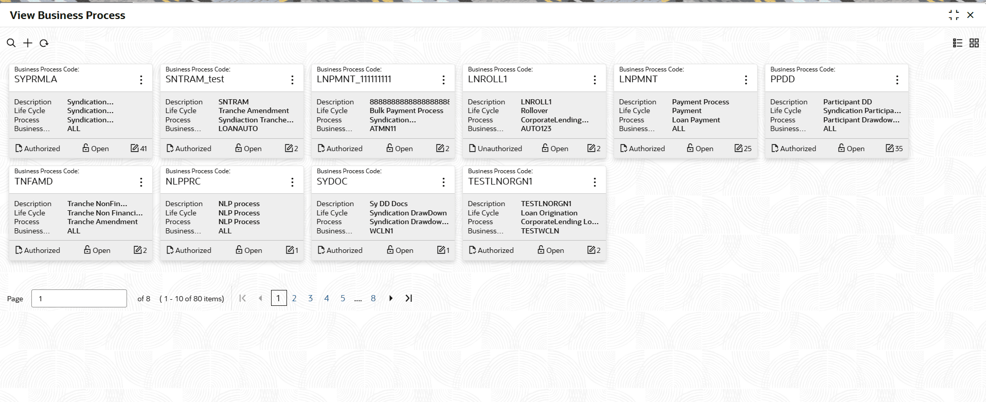

    The View Business Process screen displays.
    Figure 1-9 View Business Process
    Table 1-8 View Business Process - Field Description
    Field Description
    Business Process Code Displays the business process code.
    Description Displays the description for the business process code.
    Authorization Status Displays the authorization status of the record.
    The available options are:
    • Authorized
    • Rejected
    • Unauthorized
    Record Status Displays the status of the record.
    The availables options are:
    • Open
    • Closed
    Modification Number Displays the number of modification performed on the record.
