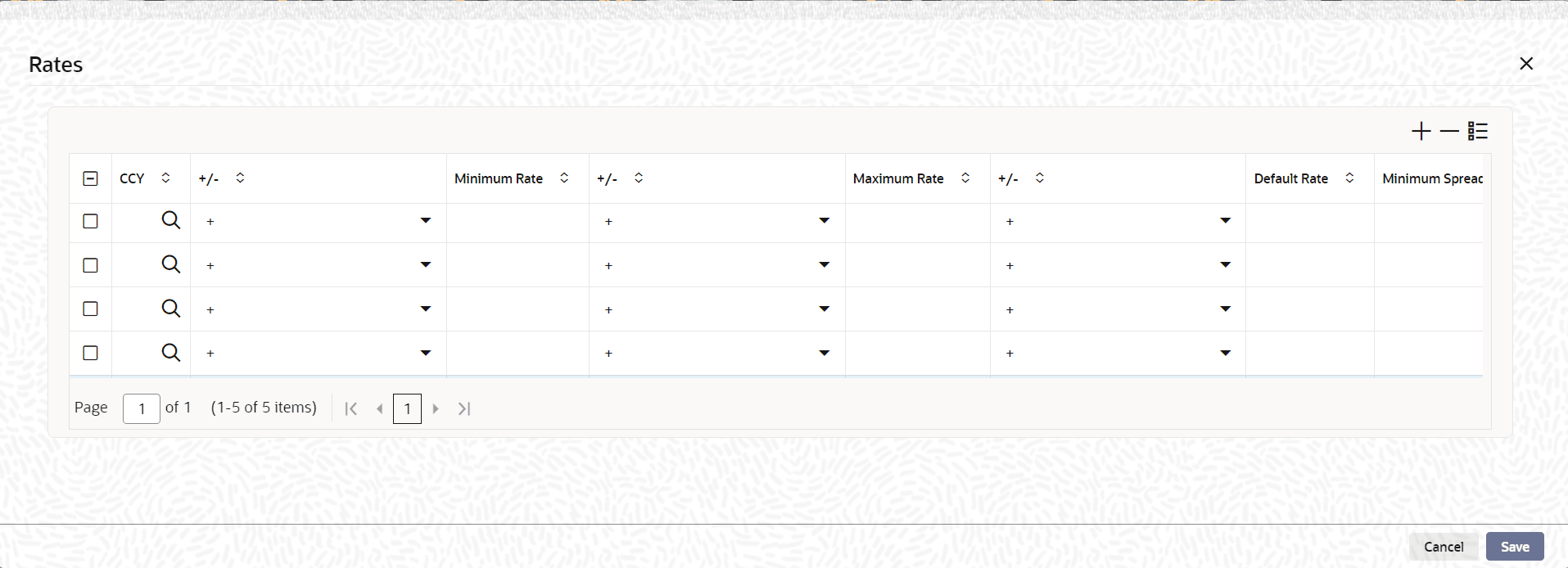

  1. From the Homepage, navigate to Interest Class Maintenance screen.
  2. From the Interest Class Maintenance screen, click Rates tab.
    The Rate screen is displayed.
  3. In this screen, the following limits and rounding rules can be defined for each currency and for each tenor:
    • For fixed rate components, the default rate to be applied in respect of the interest component.
    • The allowable limits for the interest rates in respect of the component. You can define the minimum and maximum applicable interest rates. If the interest rate falls below the minimum, the minimum rate is applicable; similarly, if the interest rate exceeds the maximum, the maximum rate is applicable.
    • For floating rate components, the allowable limits for the spread that can be applied on the floating rate. If the spread falls below the minimum, the minimum spread is applicable; similarly, if the spread exceeds the maximum, the maximum spread is applicable.
    • The basis on which interest is calculated for each currency, for which the limits are applicable.
    • How the interest amounts in respect of the interest component in the specified currency are to be rounded – truncated, rounded up, rounded down or rounded near.
    • If truncation is opted for, the number of digits after the decimal place, to which interest amounts in respect of the interest component in the specified currency must be truncated. The number of digits specified for truncation cannot exceed the allowed decimal places for the specified currency. If not specified, the number of decimals indicated in the Currency Definition for the specified currency is picked up by the System.
    • For the Round Up, Round Down and Round Near options, the rounding unit which is the lowest possible measure in which the interest amounts, in respect of the interest component in the specified currency, can be considered. This value cannot be less than the rounding unit for the specified currency in the Currency Definition. If not specified, the rounding unit indicated in the Currency Definition for the specified currency is picked up by the System
    • When generic interest limits are being defined for all currencies in the Currencywise Limits screen (that is, the ALL option has been selected in the Currency field), the fields relating to rounding rules are not available for definition.
    • The currency rounding rules can be defined only for classes that are maintained for Loans and Money Market modules
  4. You can specify the following details in this screen. For information on fields, refer to the field description table.
