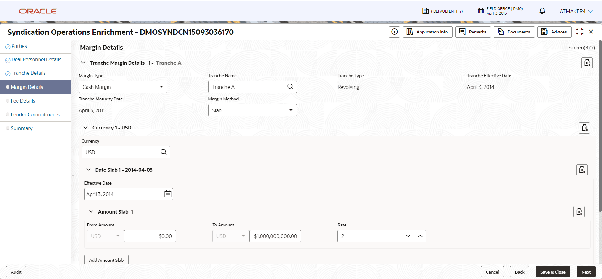

1.7.2.4 Margin Details
Margin Details can be added for the application in the Operations Enrichment Entry Stage.
Figure 1-121 Margin Details Screen
Description of Figure 1-121 follows
Description of "Figure 1-121 Margin Details Screen"
For information on the screen fields, refer to the field description table below.
Table 1-99 Margin Details - Field Description
Field Description
Margin Type The type of Margin Associated can be selected
Tranche Name The tranche name to be selected from the LOV
Tranche Type Based on the tranche selected, Tranche type is displayed
Tranche Effective Date Based on the tranche selected, Tranche effective date is displayed
Tranche Maturity Date Based on the tranche selected, Tranche Maturity date is displayed
Margin Method Select the margin method from the dropdown
Currency If margin method is Slab, select the currency from LOV
Effective Date If margin method is Slab, Provide an effective date for the currency selected
From Amount Provide the Amount from which the effective rate will be applied
To Amount Provide the Amount to which the effective rate will be applied
Rate The Effective rate to be applied for the given slab
