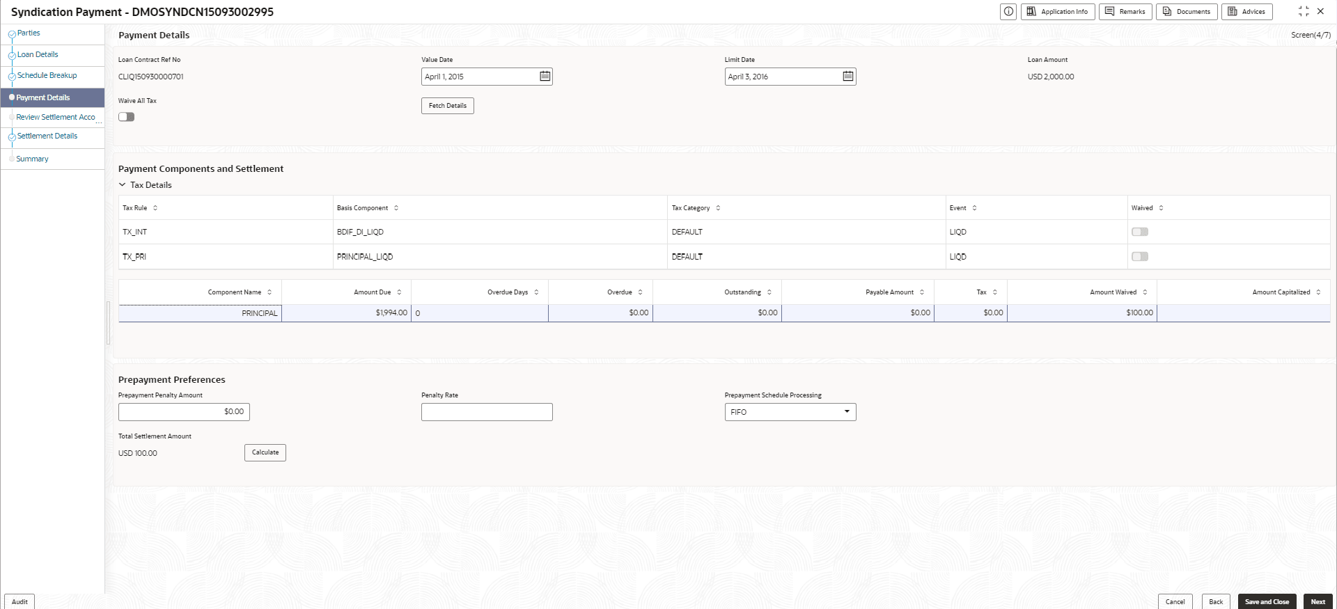

Payment details can be captured for the application in the Payment Entry stage.
Click Fetch Details after specifying the Value date and Limit Date, the payment and tax components details will be fetched under the Payment Components and Settlement section.
Figure 1-194 Payment details Screen
Description of Figure 1-194 follows
Description of "Figure 1-194 Payment details Screen"
For information on the screen fields, refer to the field description table below.
