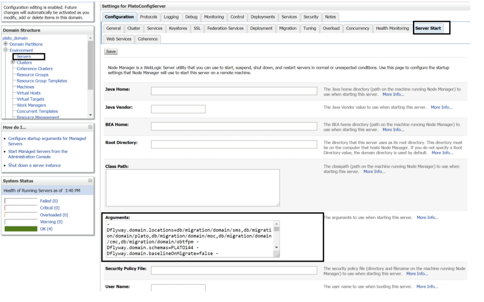

- Login to the weblogic server console
- Select servers in the “Domain Structure” section
- Select the managed server (managed server where the plato_config service got deployed)
- Go to Configuration
- Go to “Server Start” section
- Go to Arguments section and update the plato config service parameter.
The below parameters are sample parameters provided for your reference
Dflyway.domain.locations=db/migration/domain/sms,db/migration/domain/plato,db/migration/domain/moc,

Dflyway.domain.placeholders.cmc-nlp-annotator-services.server.port=8080 -
Dflyway.domain.placeholders.cmc-nlp-dashboard-widget-services.server.port=8080 -
Dflyway.domain.placeholders.cmc-nlp-model-mngmnt-services.server.port=8080 -
Dflyway.domain.placeholders.cmc-nlp-online-processing-services.server.port=8080 -
Dflyway.domain.placeholders.cmc-nlp-tag-maint-services.server.port=8080 -
Dflyway.domain.placeholders.cmc-nlp-text-extraction-services.server.port=8080 Dflyway.domain.placeholders.cmc-nlp-txn-log-services.server.port=8080 -
Dflyway.domain.placeholders.cmc-nlp-util-services.server.port=8080
-Dflyway.domain.placeholders.cmc\u0002fc-ai-ml-services.server.port=8080
-Dflyway.domain.placeholders.cmc-fc-ai-ml\u0002services.postingPath=postingPath
-Dflyway.domain.placeholders.cmc-fc-ai-ml\u0002services.pollingEmail=pollingEmail
-Dflyway.domain.placeholders.cmc-fc-ai-ml\u0002services.emailServerPort=8080
-Dflyway.domain.placeholders.cmc-fc-ai-ml\u0002services.emailServerHost=localhost
-Dflyway.domain.placeholders.cmc-fc-ai-ml\u0002services.pollingFrequency=pollingFrequency
-Dflyway.domain.placeholders.cmc-fc-ai-ml\u0002services.pollerInitialDelay=pollerInitialDelay
-Dflyway.domain.placeholders.cmc-fc-ai-ml\u0002services.emailPassword=password
-Dflyway.domain.placeholders.cmc-fc-ai-ml\u0002services.pollingPath=pollingPath
-Dflyway.domain.placeholders.USER.STORE=LDAP -
Dflyway.domain.placeholders.LDAP.CORS.allowed.origin=10.184.152.110 -
Dflyway.domain.placeholders.LDAP.credential.SALT=0.9412345671234567 -
Dflyway.domain.placeholders.JWT.EXPIRY.seconds=360000000 -
Dflyway.domain.placeholders.LDAP.url=ldap://whf00dqz:12345 -
Dflyway.domain.placeholders.LDAP.userId=uid=admin -
Dflyway.domain.placeholders.LDAP.server.base=dc=oracle,dc=com -
Dflyway.domain.placeholders.LDAP.server.credential=zCPR3ELn8GaR/E48u8vElQ== -
Dflyway.domain.placeholders.LDAP.usersearch.base=ou=people -
Dflyway.domain.placeholders.LDAP.user.prefix=uid -Dflyway.domain.placeholders.LDAP.provider=LDAP
- Dflyway.domain.placeholders.TOKEN.autoregenerate=false -
Dflyway.domain.placeholders.SSO.enabled=false -
Dflyway.domain.placeholders.TOKEN.regeneration.enabled=false
-Dflyway.domain.placeholders.cmc\u0002batch-services.server.port=7003
