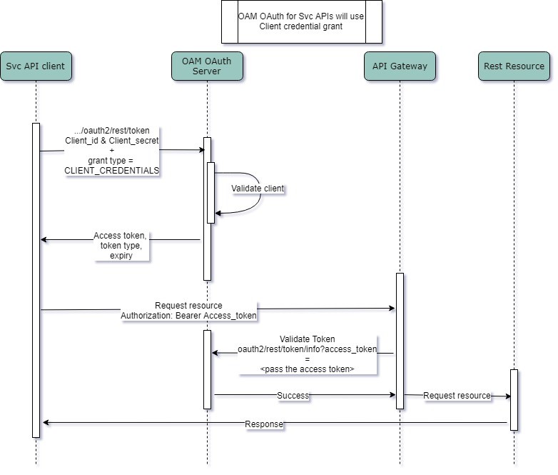

API Security with OAuth
The flow is depicted below
- API clients pass the client id & client secret and grant
type as CLIENT CREDENTIALS. To get the access token, use the endpoint
/oauth2/rest/token
. - API clients passes the access token in the authorization header as bearer token in their subsequent calls to access the Service API's.
- API Gateway validates the client access token on OAM Authorization server.
- If valid, it passes the request onto the Svc API's and gets the response.
- The client can refresh to get a new token before the current token expires. If the token expires, they can pass the client ID and client secret to get a new token.
