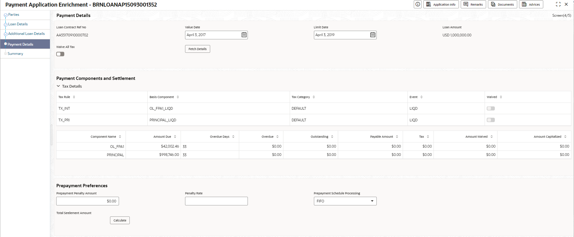

1.5.4.1.4 Payment Details
Payment details are added for the application in the Entry Stage.
When you click Fetch Details after specifying the Value date and Limit Date, the payment and tax components details will be fetched under the Payment Components and Settlement section.
For information on the screen fields, refer to the field description table below.

| Prepayment Schedule Processing | If prepayment is done for a loan contract, the payment schedule will be based on LIFO and FIFO. |
| Total settlement Amount | The Total amount being paid for all the payment components. |
When you pay the principal amount in advance , you violate the contract schedule in the case of a Prepayment Penalty. The user can collect a penalty in the form of a penalty amount or penalty rate against the principal amount as a result.
The user selects penalties based on two types: either by entering the penalty amount or the penalty rate, and also chooses FIFO, LIFO, or PRORATA from the Prepayment Schedule Processing drop-down for Prepayment Schedule Processing. If the prepayment schedule is chosen as LIFO, then theReduce Tenor applies. Otherwise, it defaults to FIFO.
If prepayment is done on a loan contract, then the schedule is rebuilt based on FIFO and LIFO logic.

When you click the Calculate button, the Payable Amount, Tax, Amount Waived, and Amount Capitalized will be added to make up the total settlement amount. If there is a prepayment penalty, we will add the penalty amount (or the amount based on penalty rate).
