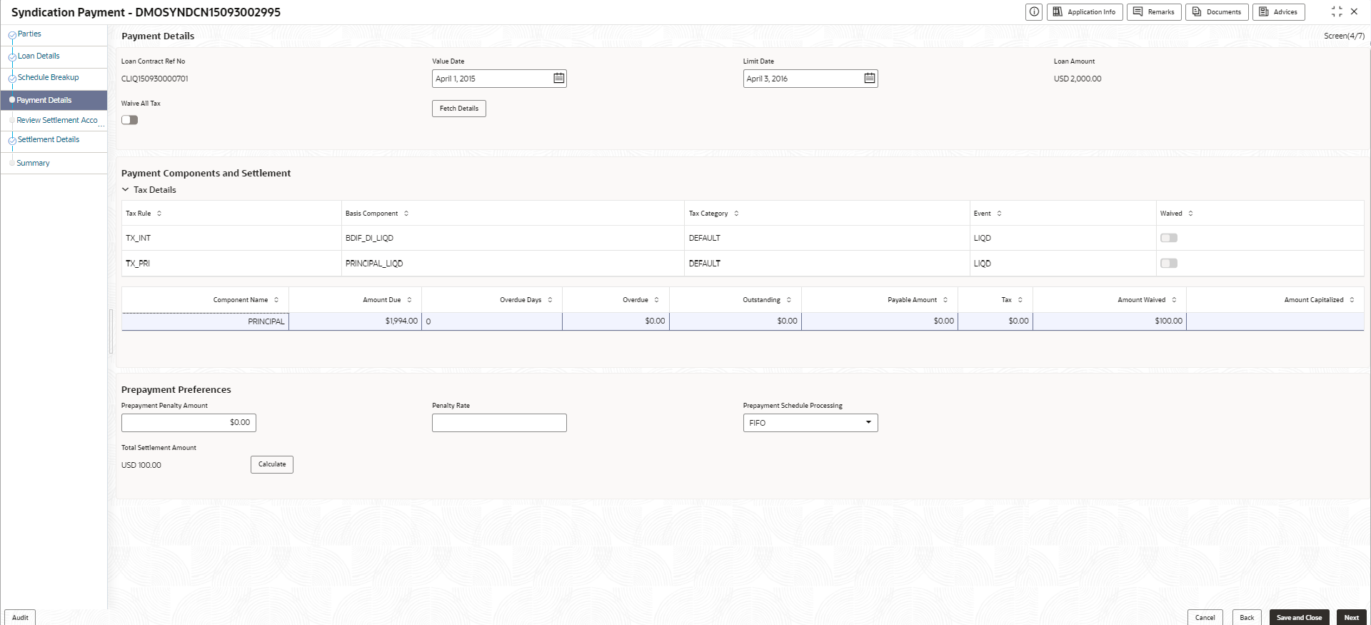

1.17.1.4 Payment Details
Payment details can be captured for the application in the Payment Entry stage.
Click Fetch Details after specifying the Value date and Limit Date, the payment and tax components details will be fetched under the Payment Components and Settlement section.
For information on the screen fields, refer to the field description table below.

When you pay the principal amount in advance, you violate the contract schedule in the case of a Prepayment Penalty. The user can collect a penalty in form of a penalty amount or a penalty rate against the principal amount as a result.
The user selects penalties based on two types: either by entering the penalty amount or the penalty rate, and also chooses FIFO, LIFO, or PRORATA from the Prepayment Schedule Processing drop-down for Prepayment Schedule Processing. If the prepayment schedule is selected as LIFO, then the Reduce Tenor applies. Otherwise, it defaults to FIFO.
If prepayment is done on a loan contract, then the schedule is rebuilt based on FIFO and LIFO logic.

When you click the Calculate button, the Payable Amount, Tax, Amount Waived, and Amount Capitalized will be added to make up the total settlement amount.
